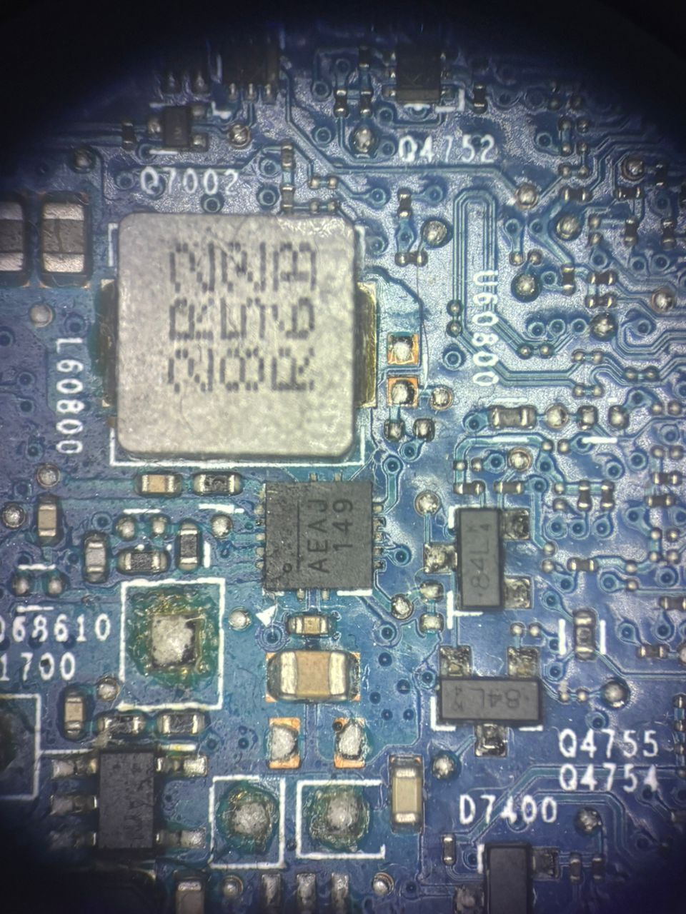

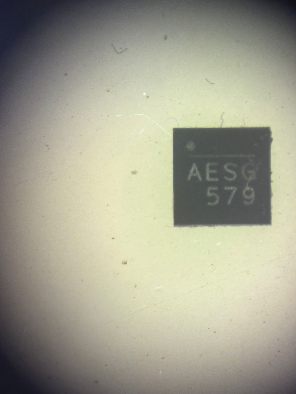

    please help identify ic
    AESG 579
    AEAJ 149
    HP Elitebook 840 g3...this ic is shorted

    NB671LGQ

      Originally posted by noname2024
      NB671LGQ
      both is same bro?

        Originally posted by dqtech
        both is same bro?
        yes

          There is a slight difference, NB671L(AES) pin#3 low power mode select, NB671(AEA) it is NC
