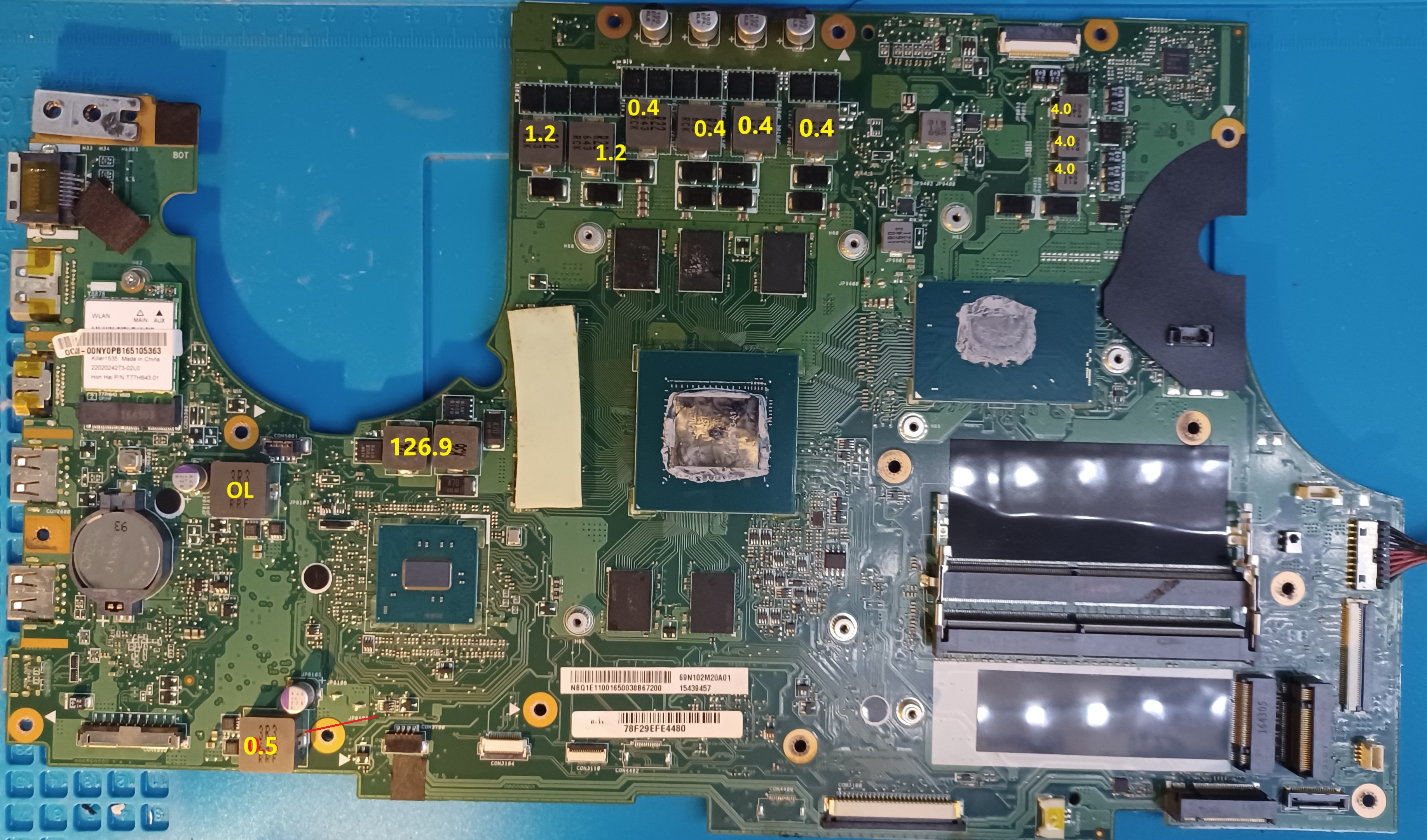

ACER PREDATOR 17x not turning IC get very hot
    I double check the pin 13 resistance, and it is 0.689M (mega Ohms). I will proceed to order a new ic and report back. Thanks and mcplslg123
      I swapped the ic and the same ic is getting hot under thermal camera. I measured the inductor resistance. see the attached photo with readings.
