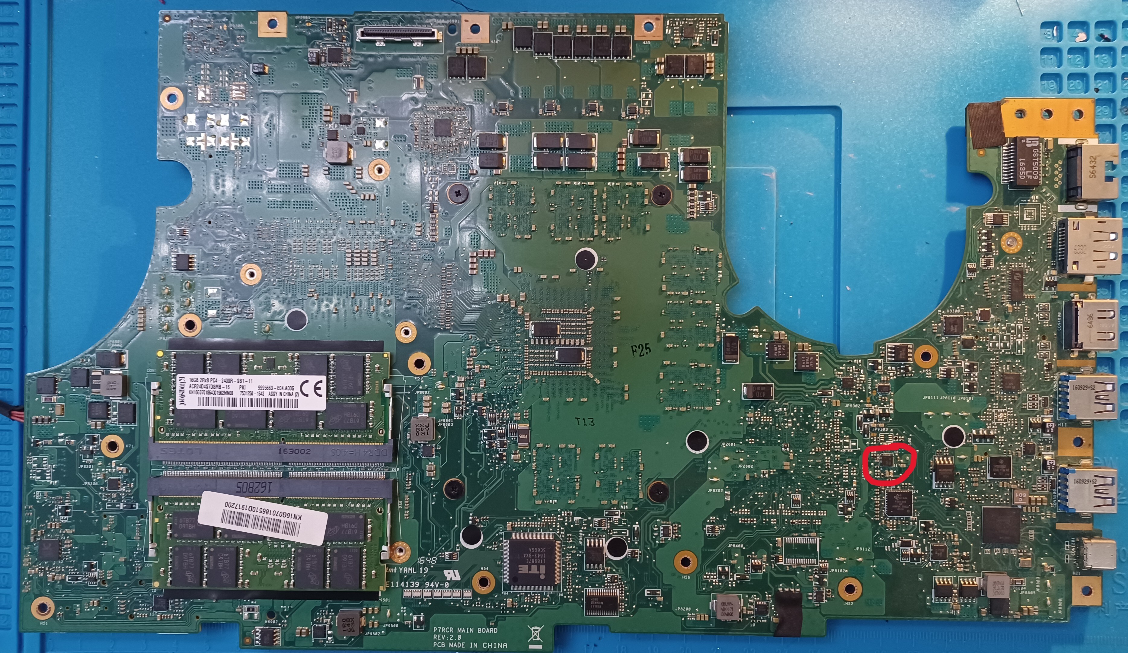

    I have here an Acer Predator 17x that does not turn on when plug in. When plug in the ic circled in red in image 17x1.jpg get very hot. Could someone please help me with which component that is? The marking on it is 3F=3H 51X.
    Thank you.
    I will also appreciate if someone has a boardview and schematic.

    If there is an '=' in the part markings, it is from Richtek.
    So, '3F=' equates to RT6575BGQW.
    https://www.richtek.com/assets/produ...S6575AB-05.pdf

        Perhaps wont help ordering a new IC. Very likely you have short on either 3V LDO or 5V LDO. Measure resistance to GND on both LDO pins.

          Thanks, mcplslg123 and mon2 . The resistance on LDO3 pin3 of the ic to ground is 22.12k ohm and LDO5 pin13 to ground is 0.5 ohm
            Too low for the LDO rail. Would you have an adjustable power supply? Dial it up to 1 volt (to be safe) and then inject onto the same LDO5 rail. Hunt for who heats up. Any part that is linked to this low current 5 volt rail is a suspect. It is also possible that this regulator is defective.

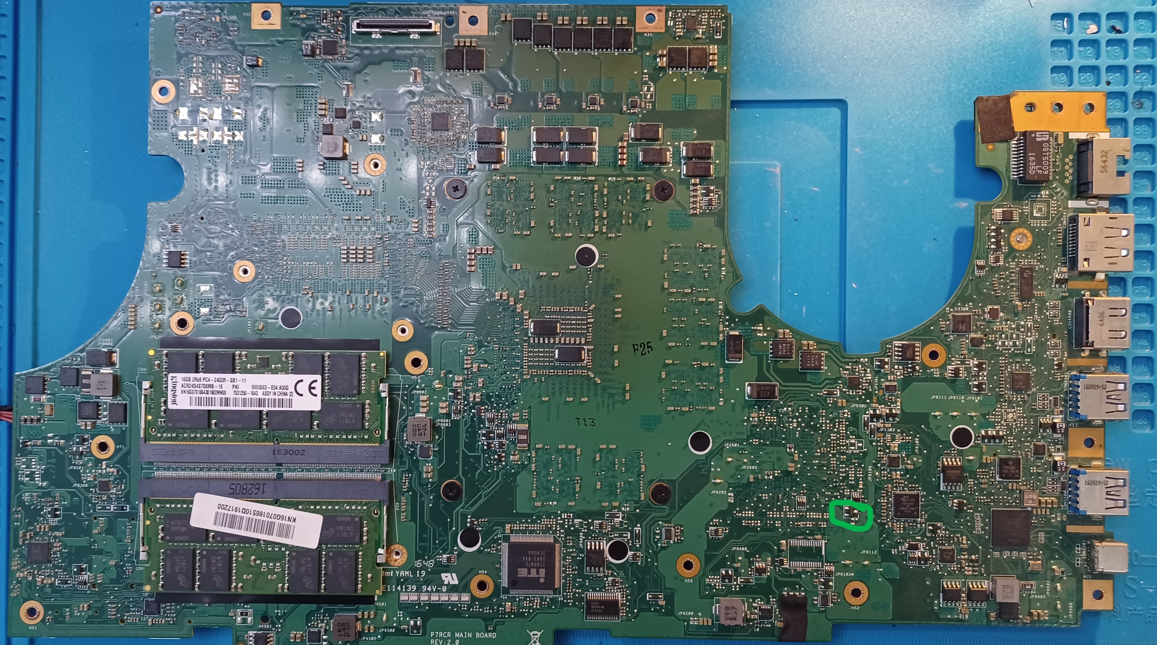

                  Thanks. After injecting 1V in LDO5, the component circled in green was lighting up in my thermal imager. I measured and 2 pins of the 3 pins measured 0.5 ohms. I think i found the short but without the schematic, I do not know what the component value is.

                          What are the topside markings of this SOT-23 component that is heating up?
                          If possible, take a clear topside pic of this component and post here for a review. We find that pouring some alcohol onto the top surface will enhance the markings under proper lighting.
                          Then suggest to flux and carefully remove this part. Do not lose the part. Then check if the LDO rail is back to a normal range for the resistance without this component. Do not power up but only confirm if the LDO5 rail is with a normal resistance.

                            The marking on the component is N1H0Z. with the component removed, still shows 0.5 ohms at pin13

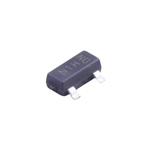

                              Looks like the attached?
                              • waakye
                                • Dec 2018
                                • 340
                                • Electronada
                                yes

                                  Flux and remove this regulator. Test if the low resistance remains on the LDO5 rail.
