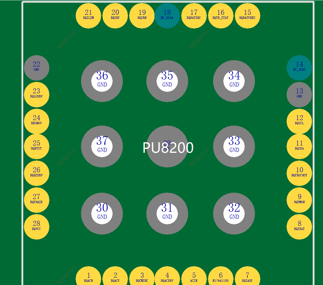

    Update - found the same boardview in my database. The charger IC is the BQ series @ PU8200.
    Remove all power. Meter in lowest resistance mode (if manual type meter) -> measure the resistance to ground on pin # 1 on this BQ charger IC. See the top view as posted for pin # 1 location.
    What is the resistance? If the resistance is low, then the main power rail is shorted and is of concern. On the internet are articles on the expected safe voltages for the AD_ID for HP. If the voltage is too low, the adapter is deemed to be under powered.

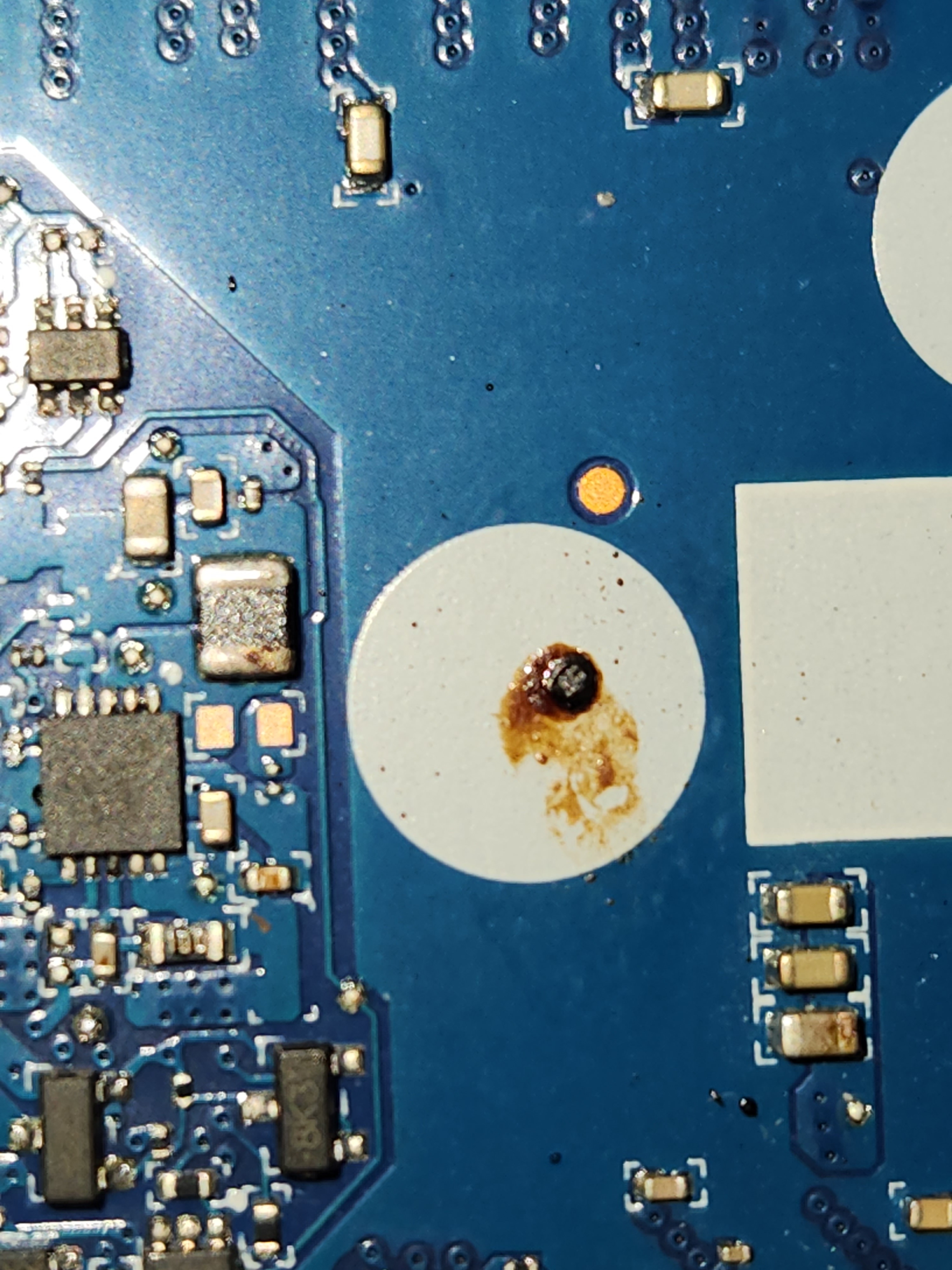

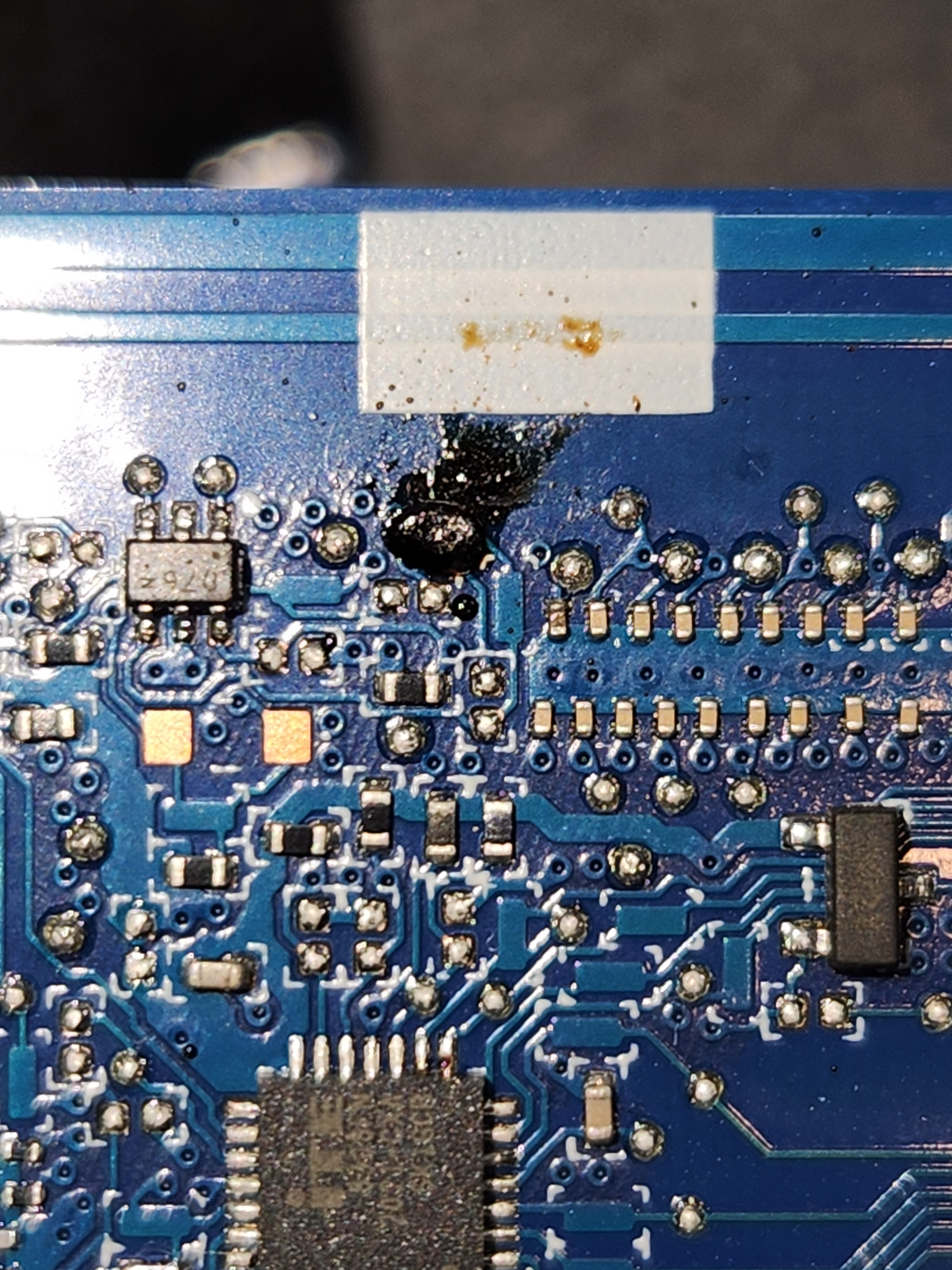

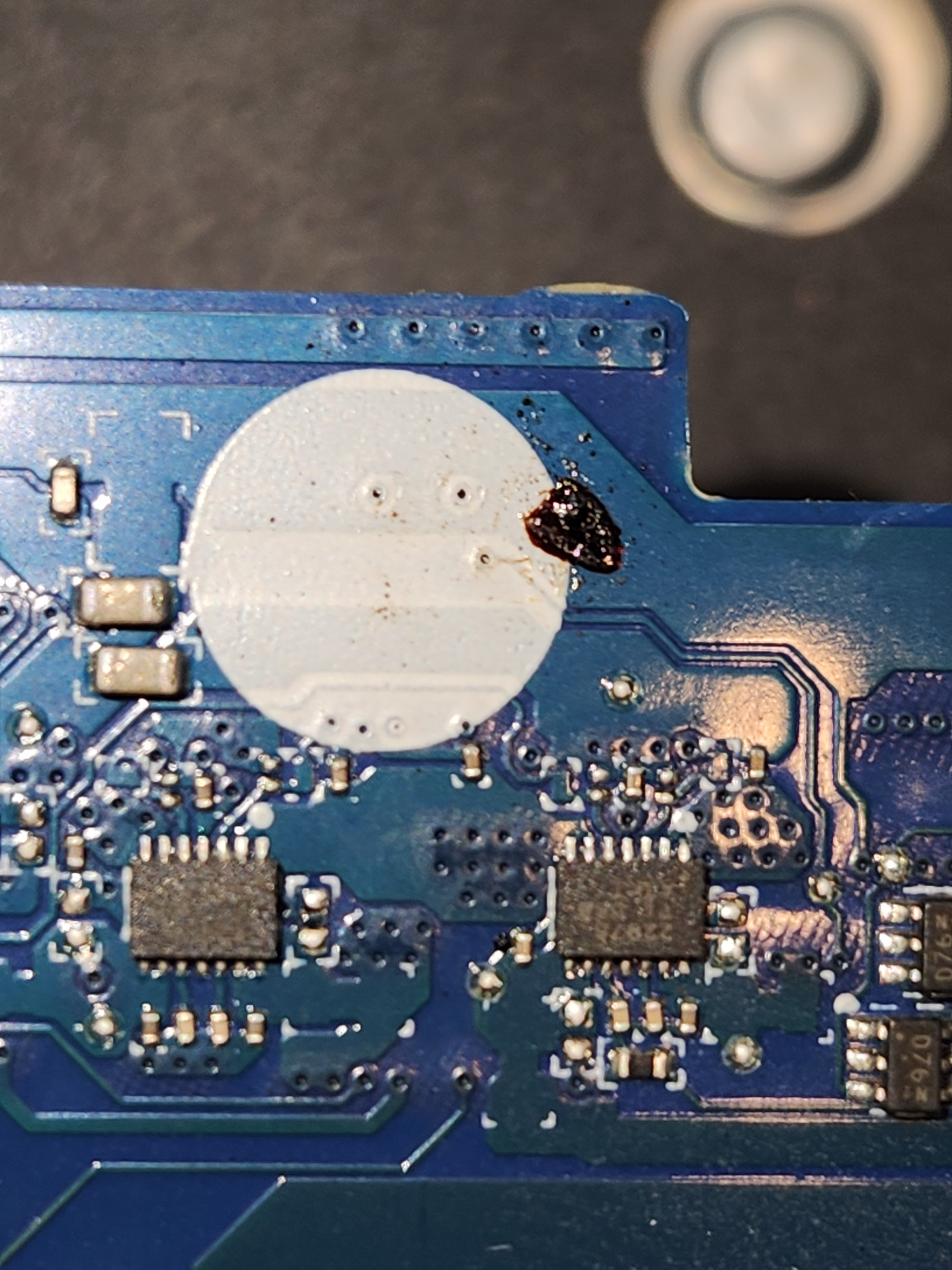

        I measured the resistance as you said and I got 10kohm/15kohm depending on direction. Don't think main power rail is shorted. As for burnt components, I don't see any, but I don't have my microscope today so I was just using a loupe. I did see a few large spots of a dark, opaque sticky residue, including some that completely covered a couple capacitors. It may be flux but I'm not sure. I'm including some pictures, although they aren't of the highest quality. I'll try and bring in my microscope so I can get some better ones.
