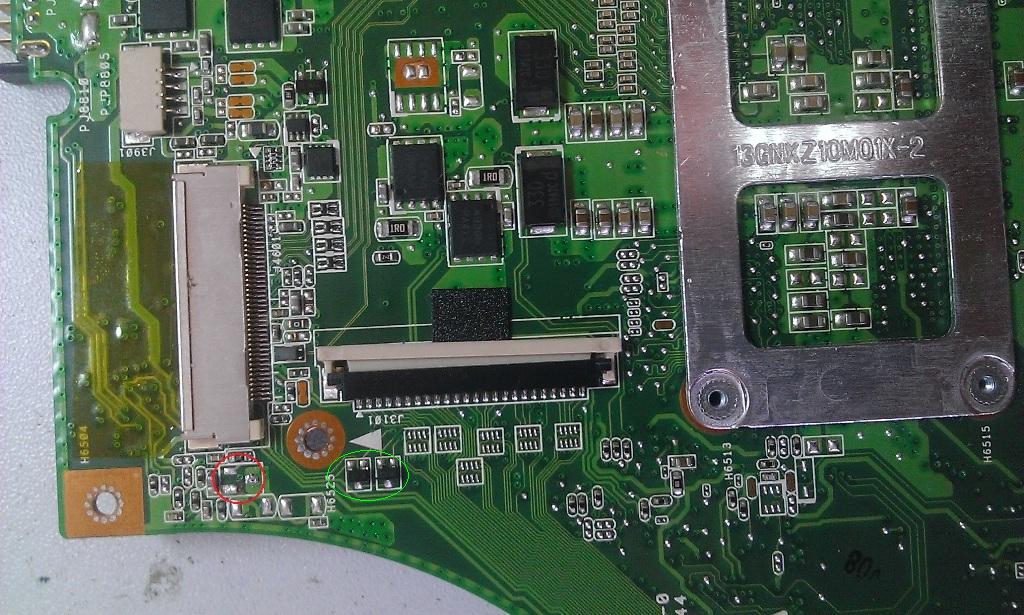

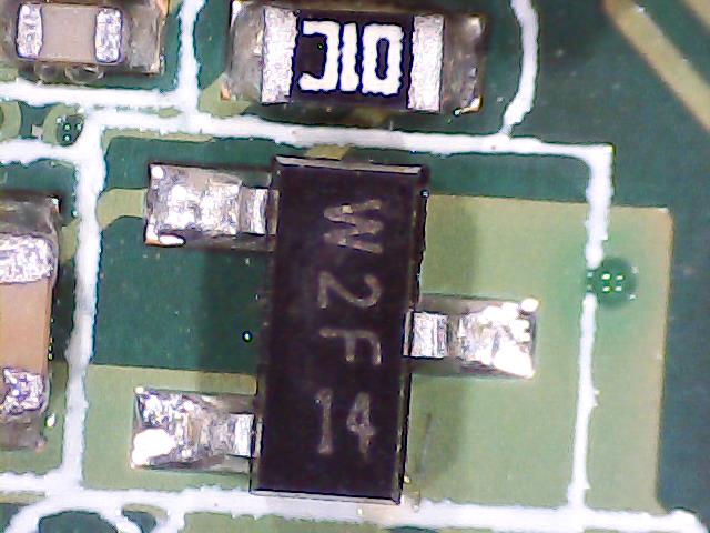

I made short circuit on k53sv pcb. I need to find a symbol/type of one of the transistors signed green circle on attached image. Pcb is hannstar E89382 i mv-4 94v-0. Please help because i can't find any scheme for this notebook
Asus k53sv tranzistor
Re: Asus k53sv tranzistor
PMBT2907A
https://cdn.badcaps-static.com/pdfs/...cefc233e8d.pdf
that's what w2f is.Last edited by tw2005; 05-21-2014, 07:54 AM.Comment
TK71542AS voltage regulator - atleast my book says it is.
http://www.datasheetcatalog.com/data...K71542AS.shtmlLast edited by stj; 05-23-2014, 09:53 AM.Comment
