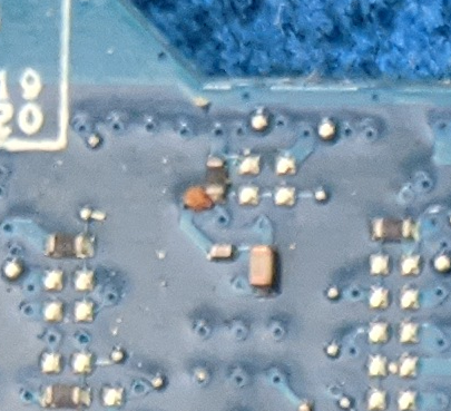

Latitude 5480 No Power/Charging, ID pin on motherboard shows 19V
  • TheoConnor
    • Oct 2024
    • 9
    • Ukraine
    Battery disconnected.
    1. Charger connected
    - 19V on both, red cables and ID pin
    2. Charger disconnected
    - red cable and ID pin NOT shorted - OL
    3. Removed those cable, DC socket
    - wired NOT shorted
    4. Checked charger directly
    - 19V, ID pin - 0.04V
    5. Connected charger to this cable, but NOT
    connected to the board
    - all fine
    6. Put back in a place
    - ID pin show 19V
    Any idea ? How to proceed, what to check next ?

    Is this a correct Dell charger ? Original ?
    With the charger connected to the cable, but with both cable NOT connected to motherboard, and charger not connected to power, measure resistance between the pins on the cable.

      try to remove this component and try the board without it, please add your board ID number

        and check PU2 Vout if you have 3.3 v at the output (it is applicable for LA-E082P motherboard number)

          Replace the DC jack. You should only have 3.3V max on the PSID pin.

                    The only way PSID can get 19V on it is via a collapsed DC jack centre pin, shorting the inner and outer rings together. PD4 usually goes short with 19V; anything above 5V or so will turn on PQ3 to remove gate drive from PQ2, protecting the EC from excessive voltage. 19V can destroy the one wire chip in the charger though. That said, missing PSID won't prevent a laptop from starting, just throttle the CPU and battery wont charge.
                    Proper way to diagnose this is to connect charger only, ignore PSID for the moment. Do you have +3V on the power switch? Does it drop to 0V when pressed? What voltages are present on the board when it starts up? All up to CPU Vcore? Assuming Vcore is present, use an external DC supply and measure input current with and without RAM installed.
                    People can only help if you give accurate measurements.

                        Update:
                        • took out the motherboard for inspection
                        • took some pictures, and did not notice anything wrong
                        • put all back, and started to review picture and notice something
                        • I don't know where to start with measurements, please guide me
                        • I don't have tools for this micro-soldering, like hot air station yet, but I am will be able to take measurements
ID:	3488713Click image for larger version
                        thanks
