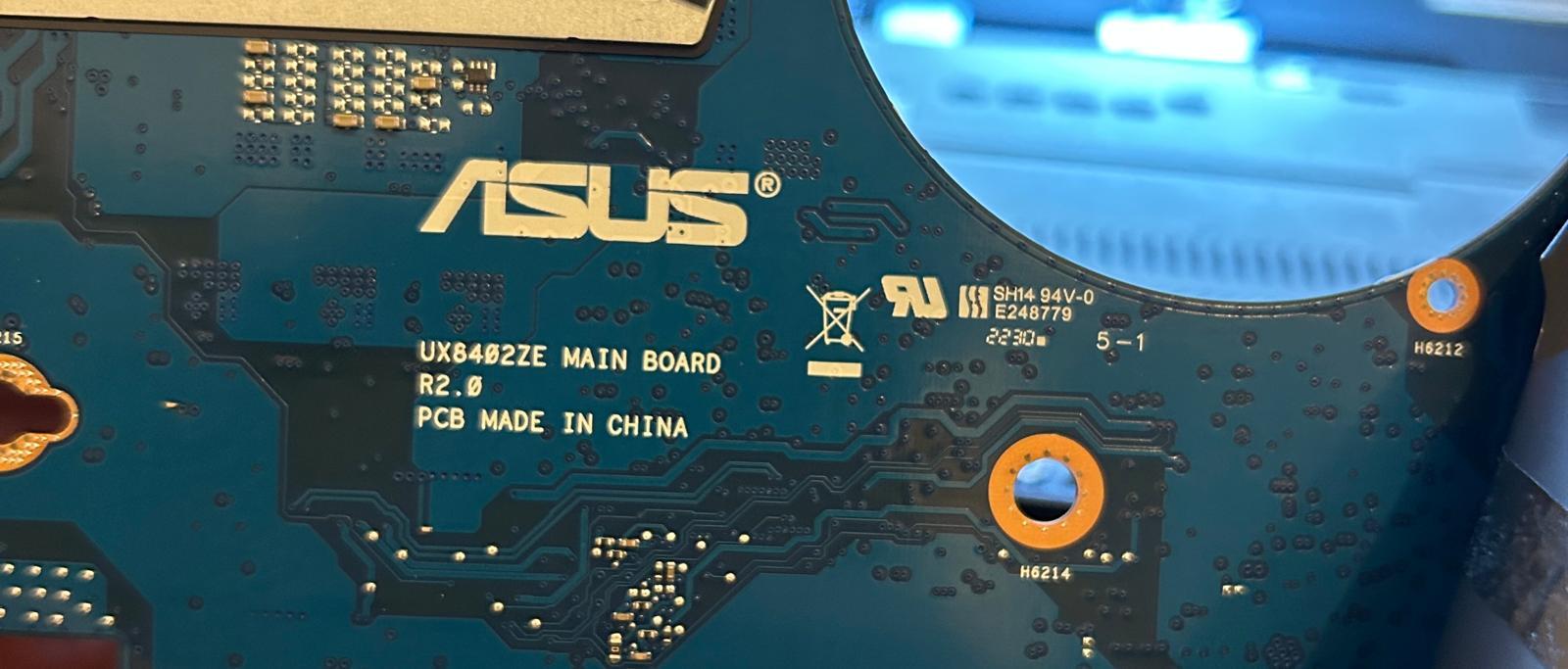

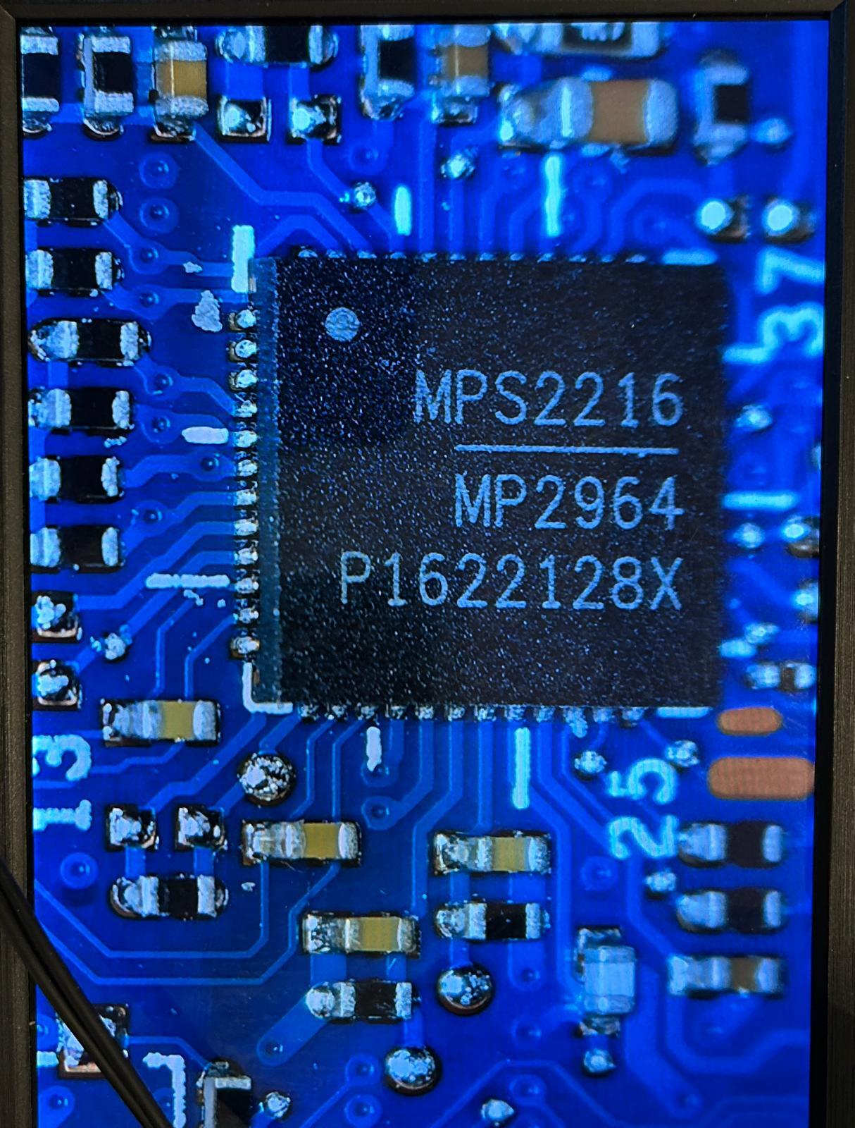

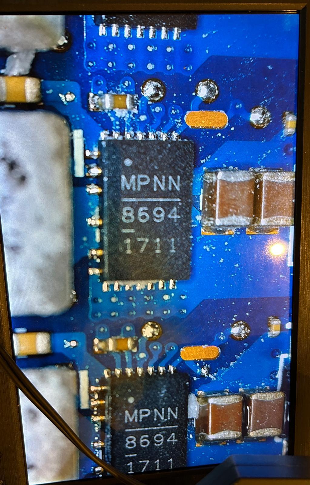

    Hi guys,
    I have this laptop with no power, no start, no LED lights. When I checked the mainboard I found a short at the CPU power supply, a dual mosfet MP8694 in short. MP8694 is controlled by MPS2216. After replace, the laptop is coming on, battery is charging.
    I try to reinstall the OS, Win11 but I get freezing and BSOD.
    I placed un USB stick with Hiren, and start to check the CPU, I get warnings "cpu throttling" with CPU-Z.
    Ideeas ?​
