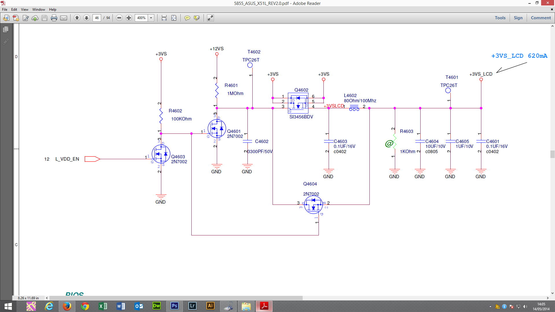

    I've got an ASUS X58L mobo ( 08G2005XB21G )...
    It came to me shorty, but found it was causing by DC jack...
    After took it off had all power voltages fluctating, no fan spin, only "wifi" & "zz" LEDs lit...
    Suspected north (U1101) so reballed...
    Now it turns on with "zz" LED, fan spins & stays like that...
    Have absolutely NO output to LCD or External...
    So checked J4601 voltages & found that has no voltage on +3VS_LCD...
    As far as I understand the schematics, it's coming from Q4602...
    There's no voltage present on PIN3 & PIN4...
    It's a N-channel FET, so there should come 12V to gate to enable the +3VS_LCD???
    Am I right???
    BTW I've checked R4601 & have 12V on one side but nothing is coming from the other (PIN1)
    Also reads 1mega as it should...
    Could You anyone explain me that +12VS???
    Any help would be appreciated...
    Also attaching Q4602 datasheet & schematics (again says X51L model, but I've got the same marking on my mobo & looks it's the same)

        Q4601 has 3V at gate, so it pulls the other side of R4601 to GND, hence no voltage at Q4602 gate. The LCD gets power when 965GM turns on L_VDD_EN. Why did you suspect the GM when power was fluctuating?
        If have spare, try to change the 965. If you have post card, use it - maybe get some useful info.

          Now assuming that North is not generating L_VDD_EN...
          BUT THE WEIRD THING...
          Just took a DELL D520 (Quanta DM5) mobo...fully working, to compare voltages at LVDS circuit (looks pretty the same design)
          Guess what...
          With LCD cable disconnected I'm also getting NO L_VDD_EN Voltage...(0V)
          However when I connect LCD Panel the voltage comes up with display...
          Only thing I've noticed that VDD EN voltage comes through N channel MOSFET on ASUS mobo, but on DELL it's coming through NPN transistor(does this mean it's a P channel fet???)

                  Can I inject 3V to Q4602 gate or desolder & short its drain & source to check if it's everything else ok???
                  I know the mobo is not worth fiddling around, but I want to understand every circuit...
                  • atsio
                    • Oct 2013
                    • 819
                    • Greece
                    Re: ASUS X58L NO Display Strange Fault
                    Just a wire from source to drain. On DM5 you can see on pin 13 of LVDS connector the signal LCD_TST which is connected to Southbridge and probably if you dig a little bit further on the datasheets of the IC's you'll find the links to the ENVDD signal.

                      Shorted Source & Drain...
                      Definitely something happens as screen goes black after pressing pwr...
                      However no light & no image on screen (checked under light)
