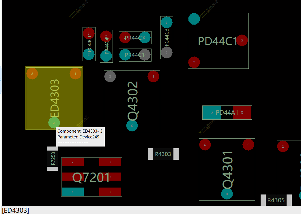

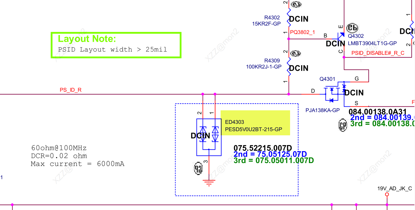

        Anyone please help me what is the burn component name in this picture. I cannot find . Dell inspiron 14/ odin adl ddr4 213264-1
        • mon2
          • Dec 2019
          • 14713
          Appears to be ED4403.
          ED4303
          PESD5V0U2BT-215-GP​
          PESD5V0U2BT Ultra low capacitance bidirectional double ESD protection diode
          https://www.digikey.ca/en/products/d...BT-215/1766938
          Common part that can be replaced by many others.
