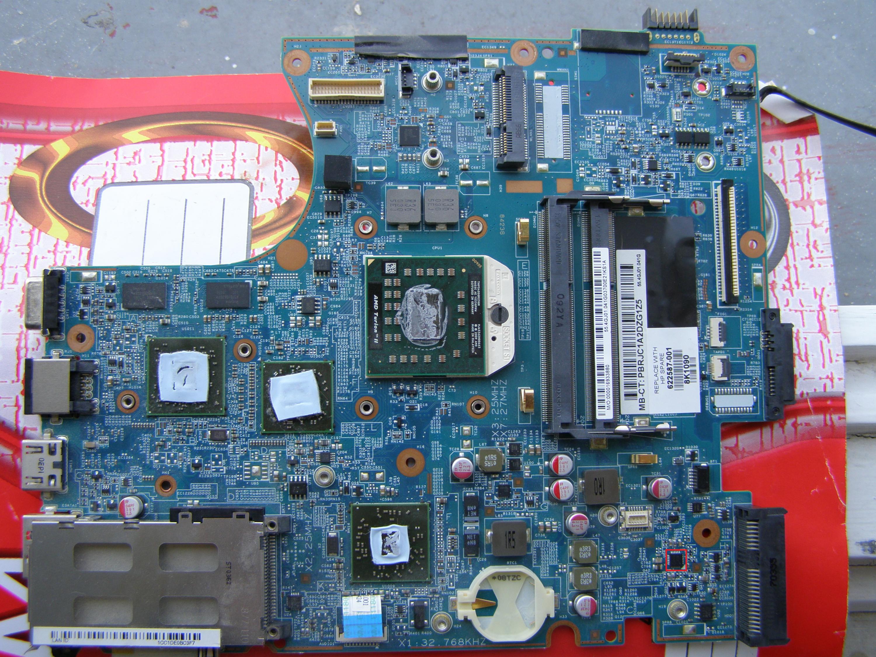

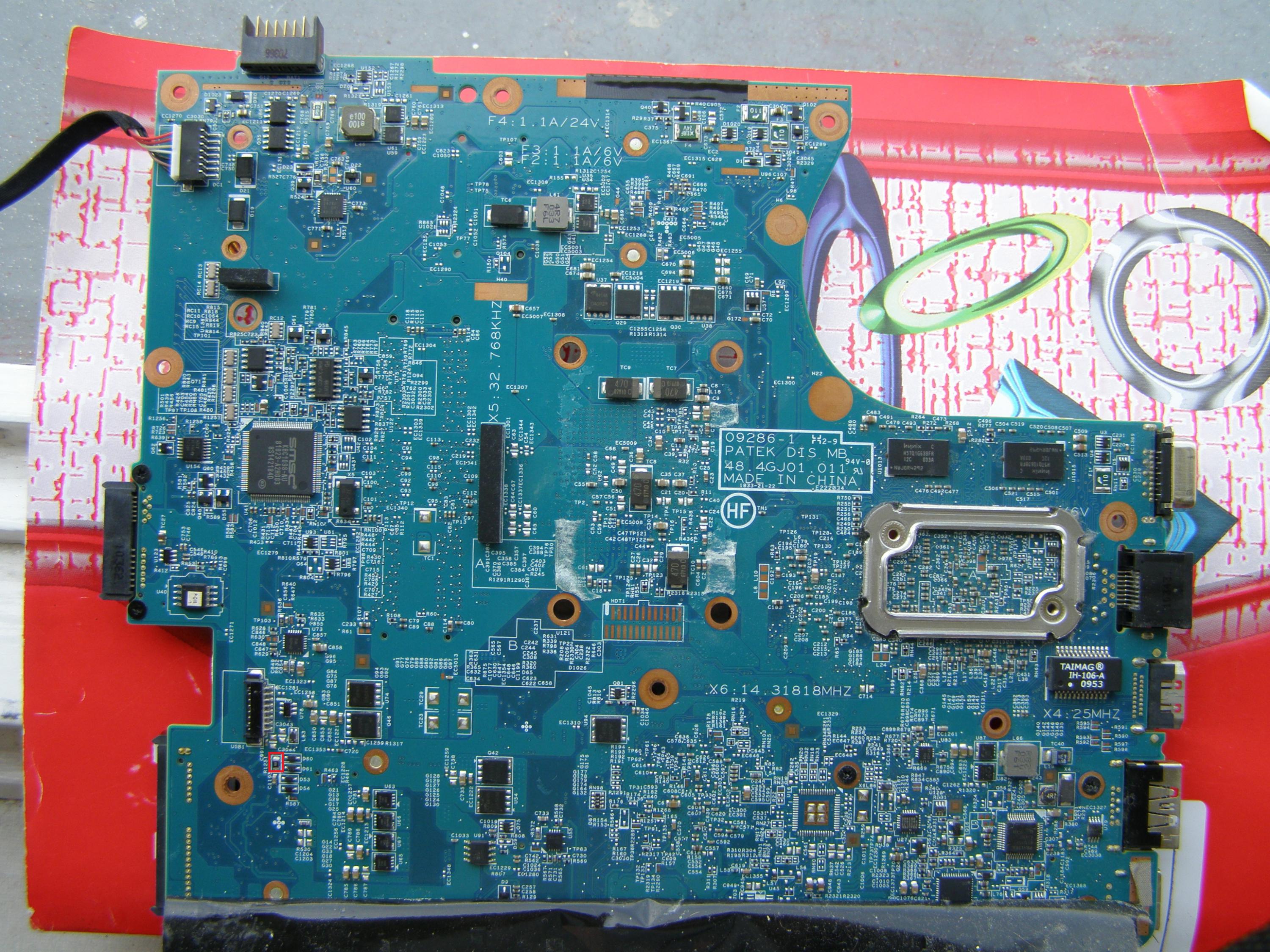

    my friend try change cracked LCD, bud he destroyed mainboard.
    Mainboard is 09286-1 PATEK DIS MB.
    All fuses on MB is OK, but when battery is connected coil L41 or L61 making beeping noise. When AC power is connected no noise is produced and R1251 became very hot. I try to remove U64 but still have this problem. Can enyone help me?
    In attachment is images and schematics of this board. On page 39 is R1251 circuit. Thanks.

    Re: HP probook 4525s MB repair
    measure resistance to gnd after R1251.
    measure R1251 resistance, is it 100 ohm?
          did you check the D60, D51, D53, D54 and C1195

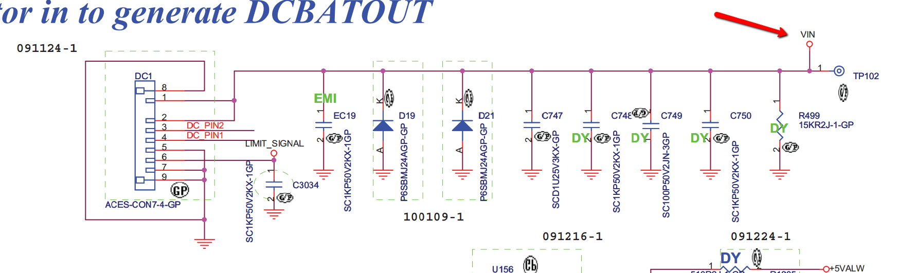

            YES, diodes and capacitor is OK.
            Diode D60 is connected directly to +19V Is it right?
            But on schematic is D60 connected to VIN not to 19V.
            • rtstorm
              • Feb 2012
              • 971
              • Croatia
              DC jack is connected to VIN
              ...the quieter you become the more you are able to hear...

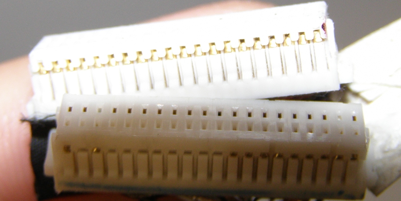

                          My friend replaced LCD with LCD from HP 4510s, but he changed it with LVDS cable. Cable from HP 4510s is not the same I hink this is the problem.
                          In attachment you can see the difference between cables. LVDS from HP Probook 4510s have all pins connected, but LVDS from 4525s NOT, some pins is empty. Circuit draws 130mA when I measuring on R587.
                          Maybe its normal resistor heating so much.

                              I soldered back the U64 and all voltages are the same as before removing it.
                              But I still have no Idea how he can kill board by LCD. He says: I just changed LCD, then power on Laptop. Led blinks and then shutoff. After this i cant power on the laptop with or without battery, with old or new LCD.
                              I havent lab PSU. Its time to say Bye Bye Board.

                                Now I find shorted mosfet U35.
                                • khaahk
                                  • Dec 2013
                                  • 771
                                  • Estonia
                                  Short is how many ohms?
                                  Is it shorted off-board also?
                                  • Honziq
                                    • May 2014
                                    • 58
                                    • Kazaksa
                                    Shorted is 0Ohm, off board it is still 0Ohm, but U58 is now shorted too.
