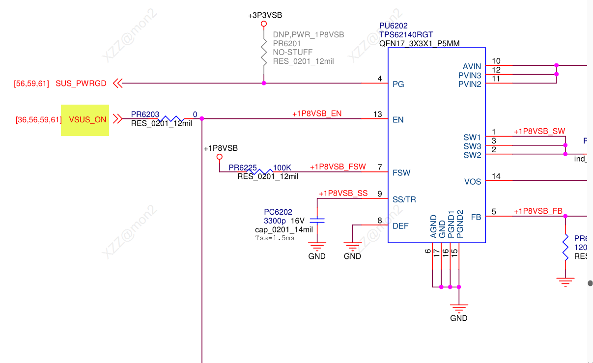

    I checked power rails and I'm missing 1P8VSB_EN power rail, it is not turning on because it has missing SLP_SUS

    What is the voltage to ground of VSUS_ON? Voltage to ground of EC_RST#?

      Thanks for answer
      VSUS_ON has 1.8V
      I could not find EC_RST# in schemes qand I'm not sure where to measure
      I found reset signals like
      DEVICE_RST# has 3V
      SAM_RESET# has 1.8V

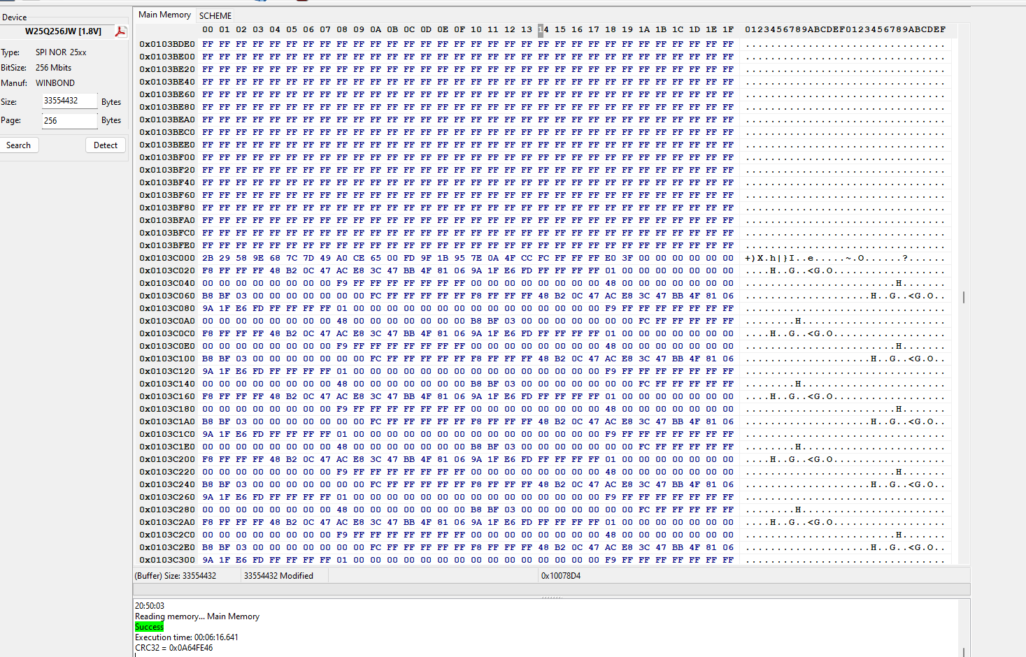

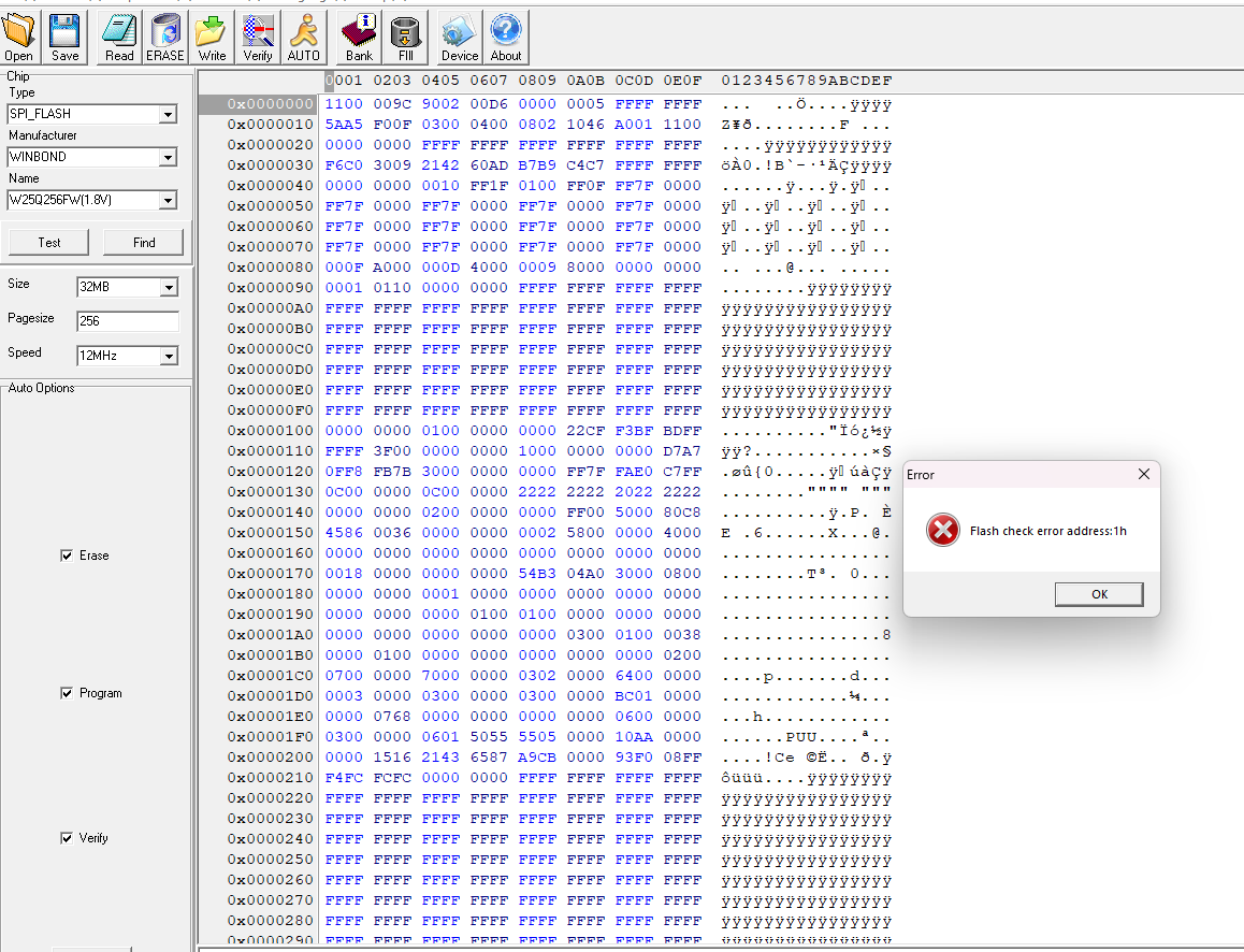

          Little update. I bought EZP2023+ with 1.8V adapter to program BIOS IC and same thing. It looks like I can't fully erase BIOS IC, when I erase IC and then read its content it still has some data. When I write to IC I get error on verification. I'm not sure what is happening

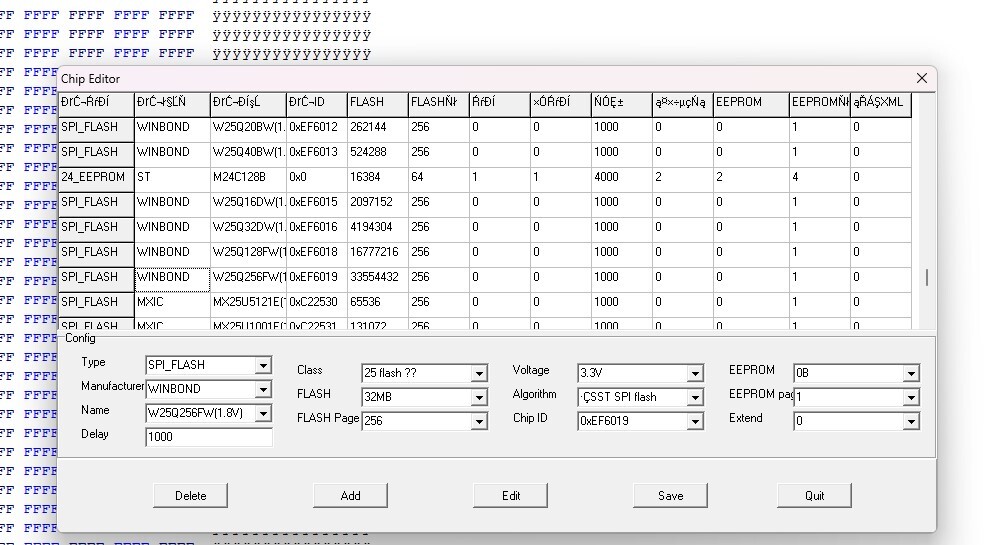

              BIOS IC is Winbond 25R256 but it is auto detected in programmer as 25Q256FW 1.8V. Programmer software doesn't have 25R256 in database, I could add one but I'm not sure all parameters.
              With 25Q256FW selected I can read whole IC, if I want to erase it most of IC is FF but there is still data left, I can write bin file but it gives me an error while veryfiying

                  Thank you for help, I read this but no change. I used now CH341A as they said that it is more realiable but after erasing IC I still have data on it (attachment 1), I cant program anything with CHA341 as it freezes on programming IC. When I thry to program with ezp I get error on 1h (attachment 2)

                      Same thing, it took almost an hour to erase and write IC but as soon as it gets to veryfying it shows error 1h
