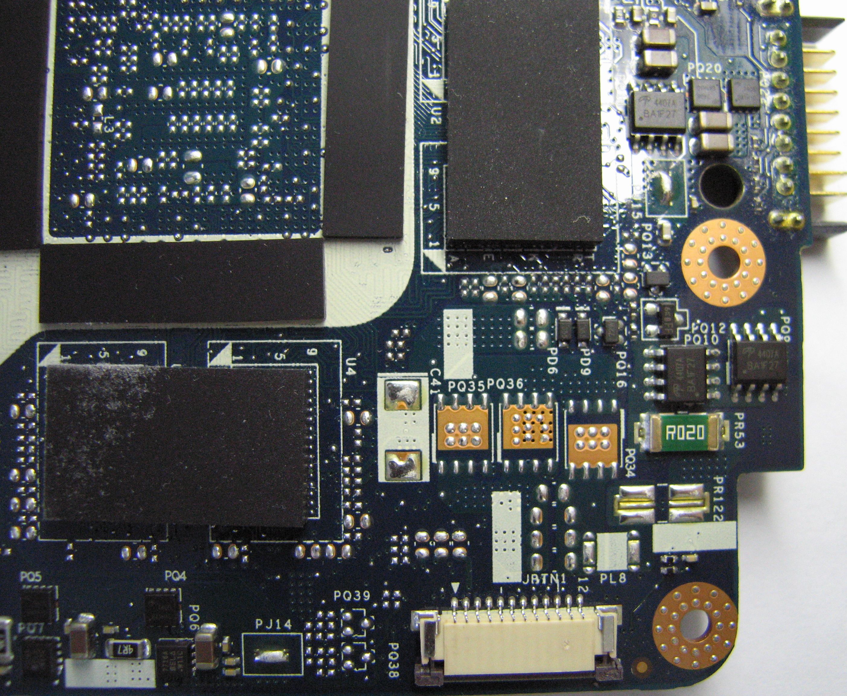

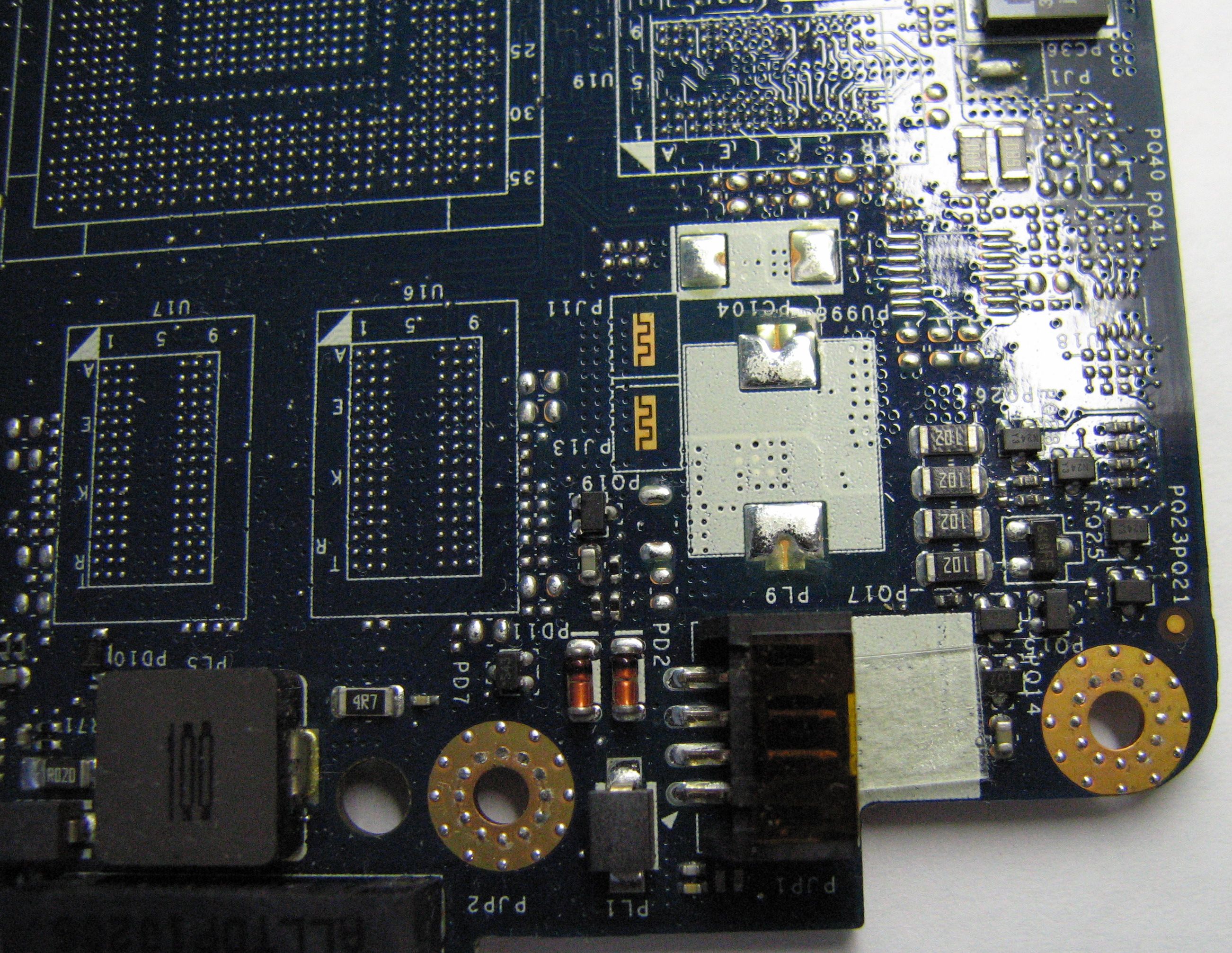

    I've got this motherboard here from a laptop that won't turn on and shows no signs of life at all. Before I spend $100 for a replacement motherboard, I'd like to take a crack at fixing this one. Maybe it's just a matter of a simple small IC replacement.
    I've measured the voltage at the connector so I know that's soldered on properly, but that's the extent of it.
    I'd like to know what I need to probe to check the voltages. I've looked at the schematic sheets (attached), and page numbers 40+ seem to be of particular relevance.
    I've also attached photos of both sides of the board near where the jack connector connects to the motherboard. The attached photos are better quality than the ones I included inline.
    Any help at all would be kindly appreciated.

    Re: Compal LA-6151P eMachines/Gateway ID49C & Packard Bell NX86
    Check voltage on pins of PQ9, PQ10
      Thank you. I am getting 8 volts or so on gate and 20 volts or so on all source pins of both PQ9 and PQ10.
