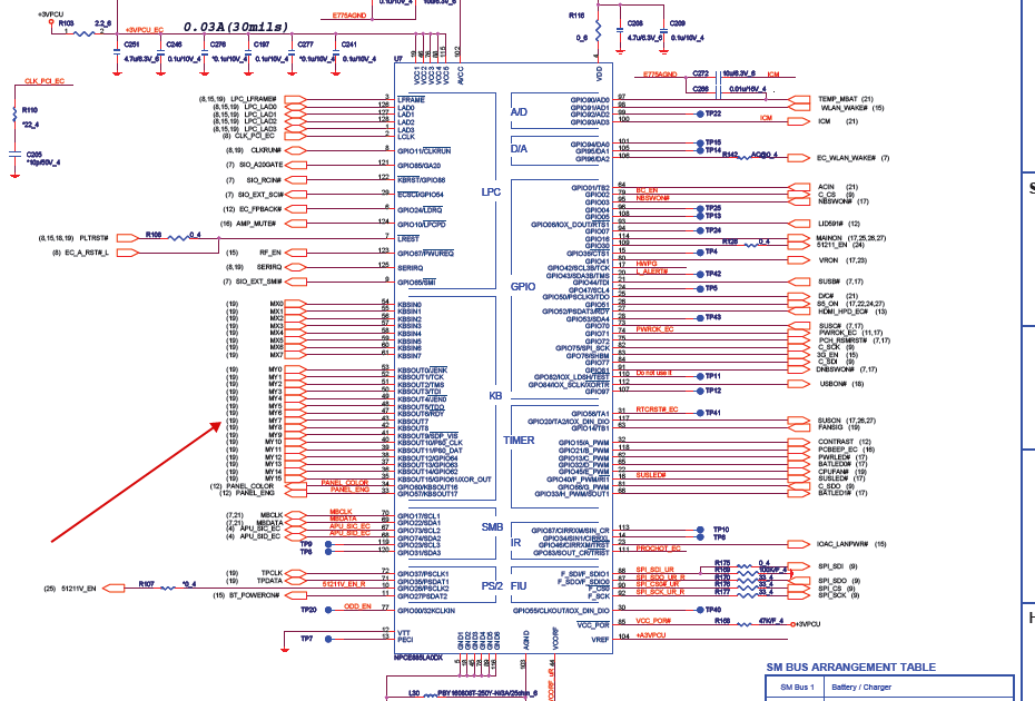

    I there , got here a aspire one ao725 . that was not functioning the " X C B , and down arrow , changed with a new keyboard , the same, replaced KB controler and reflashed bios , cheked very carefully the socket for continuity , all pins are well soldered to board and them make good contact with keyboard . so this must be something that is missing me , so that why im here , to get more genius minds helping me out.

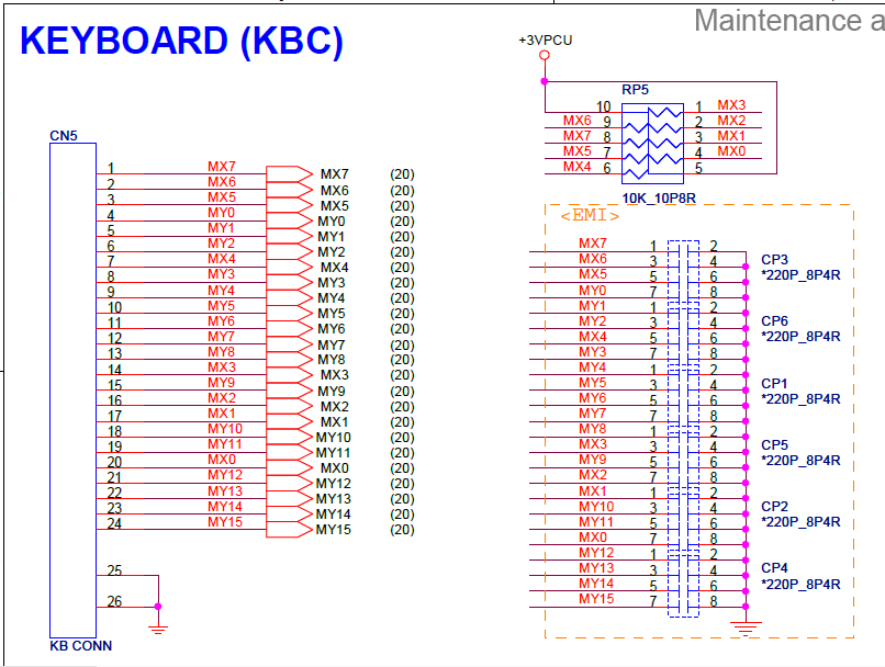

          Re: aspire one ao725 some keyboard keys not functioning. everything changed.
          keyboard (kbc)
          • kotnatan
            Banned
            • Apr 2014
            • 181
            • Ukraine
            ec(kbc)

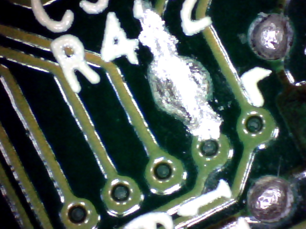

              well , i really dont know why somethimes im sleepy LOL .. well something must been wrong with this board , after all this changed , this is something for future learning(well i learned this before, but somethimes we try to go directly for component chek and in the end somethimes there is more than this , like the traces , i looked all traces all seems good , in the end very very carefully and only with microscope , notice a gap on a test point , were that testpoint disapear not making contact of one trace , i bet this trace is what is not giving does keystrokes , gonna repair the trace and let you guys know .but 99% sure will be fixed - cheers~
                fixed
