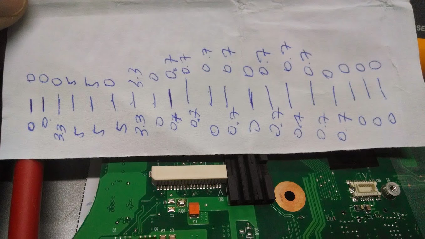

                            • orientalsniper
                              • Apr 2013
                              • 461
                              Re: 6050A2174501-MB-A03 (Satellite Pro L300D)
                              I attached picture of the readings, motherboard had power on.
                              • atsio
                                • Oct 2013
                                • 819
                                • Greece
                                Give voltage and resistance to ground on all pins of Q15. Voltage with power on, resistance with power off.
