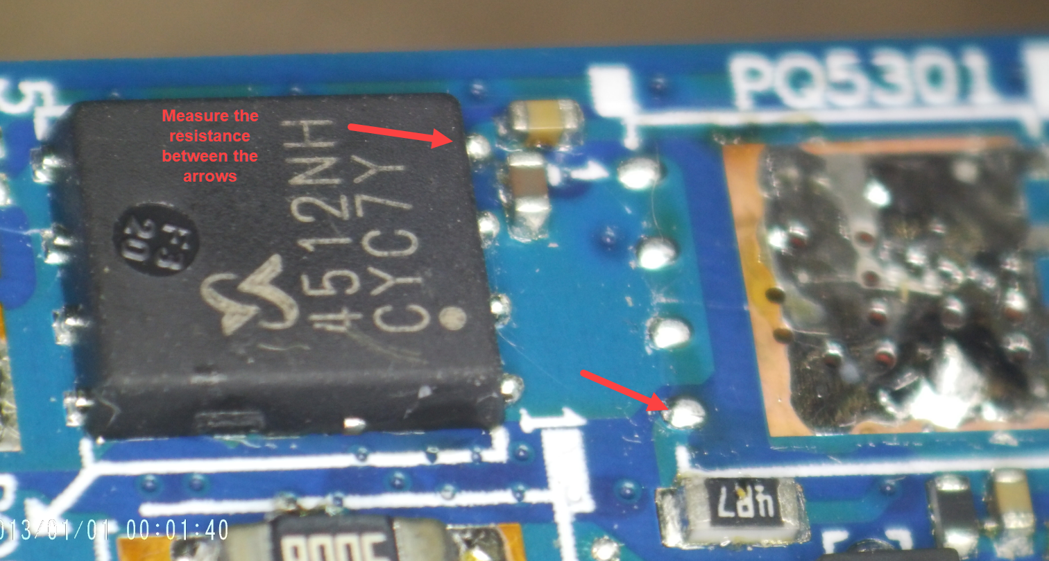

    need the name / id for PQ5301 please
    picture number 2 middle top missing part

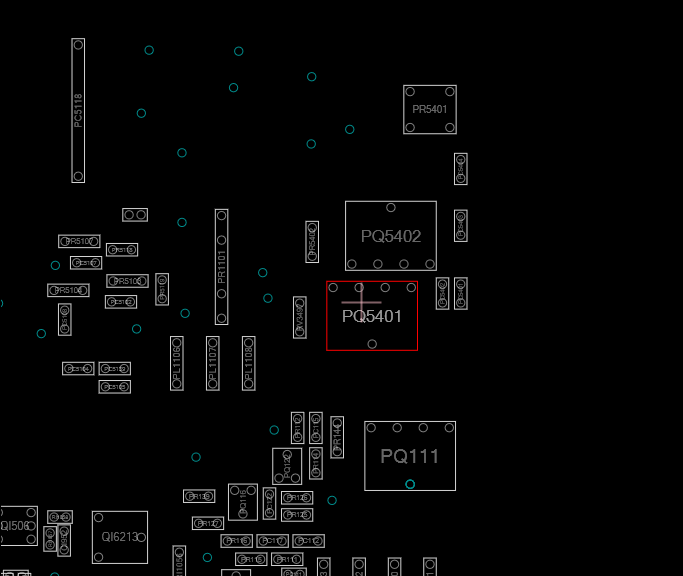

    Unable to find this exact logic board but may have found a similar one.
    See attached.
    Can you confirm the topside markings of the mosfets that are present on your board?
    Confirm also if pin #4 of these mosfets are tied together or not. This is the gate pin on each mosfet. From this knowledge, we will know that both of these mosfets (includes the missing one) are of the same type. Most likely this is a N-channel mosfet that is missing.

      hi thank you
      looks it is not right here are close images for left and right and board used in models.......

        Measure the resistance between pin # 4 of the one mosfet and pin # 4 of the missing mosfet. Is the resistance ~5 ohms?

          gate to gate is Mohms pq111 and pq5301 and same pq 5302

            See attached. Confirm the resistance measurement here in ohms. No power to the board.
                    the resistance is 4.9 ohm correct

                      Excellent. Thanks EldaJump - see post # 7, you can find the full part number of the missing mosfet from this post. If needed, this mosfet can be replaced with many others like Texas Instruments, etc. It is also very common to source from donor boards that have the same style of mosfet.
                      MOSFET(Si) PK5V8EN Datasheet DFN56 30V Nikos (powerdatasheets.com)
                      30V N-channel mosfet
                      5*6 size
                      Suitable replacements:
                      CSD17581Q5A data sheet, product information and support | TI.com
                      IRFH7440TRPBF Infineon Technologies | Discrete Semiconductor Products | DigiKey
