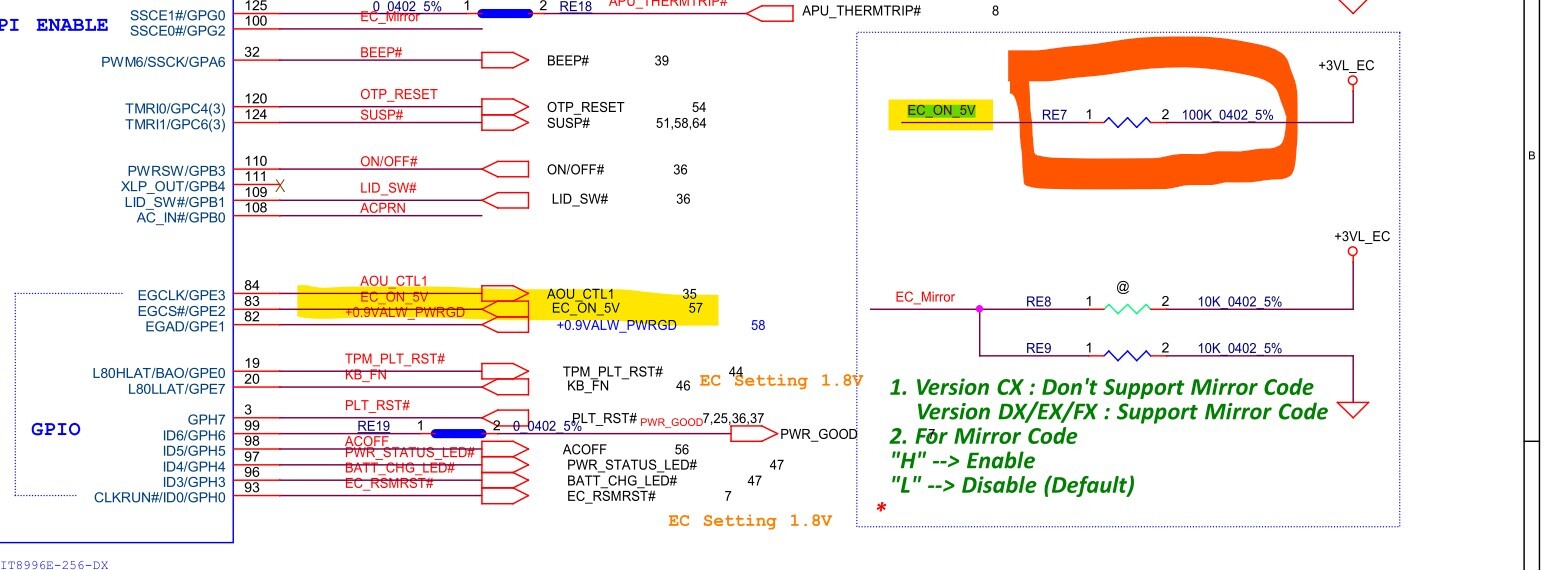

    I did. But isn't pin 83 of UE1 an input?
    I didn't fully understand the connection from EC_ON_5V to +3VL_EC which you can see on the right. Unfortunately I can't find this resistor RE7.​

      Yes. It appears that this signal is hard activated through the RE7 pull-up resistor to +3VL_EC. So upon power up, this signal is parked to a logic '1' which will enable EC_ON_5V to be '1'.
