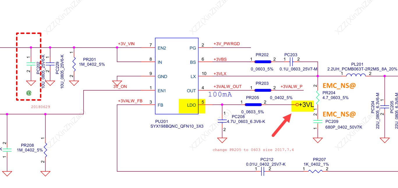

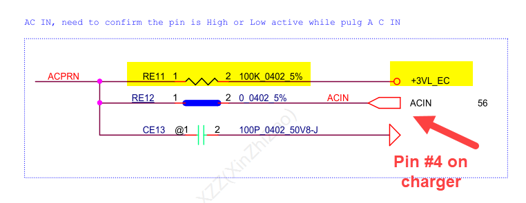

                            Pin 4 CHRG_OK: 0V
                            This signal is never a logic '1'. Stuck @ logic '0' for both cases - with adapter only; with adapter+battery combination. When the adapter is connected, this signal must be a logic '1'.
                            The logic '1' is created through a pull-up resistor and a pull-up voltage of +3VL.
                            Confirm the voltage to ground of +3VL. Check at PU201, pin 5.
                            Follow the power path of +3VL. Confirm that this LDO is created by the regulator. If not, stop. Remove all power. Measure the resistance to ground (in ohms) of +3VL.

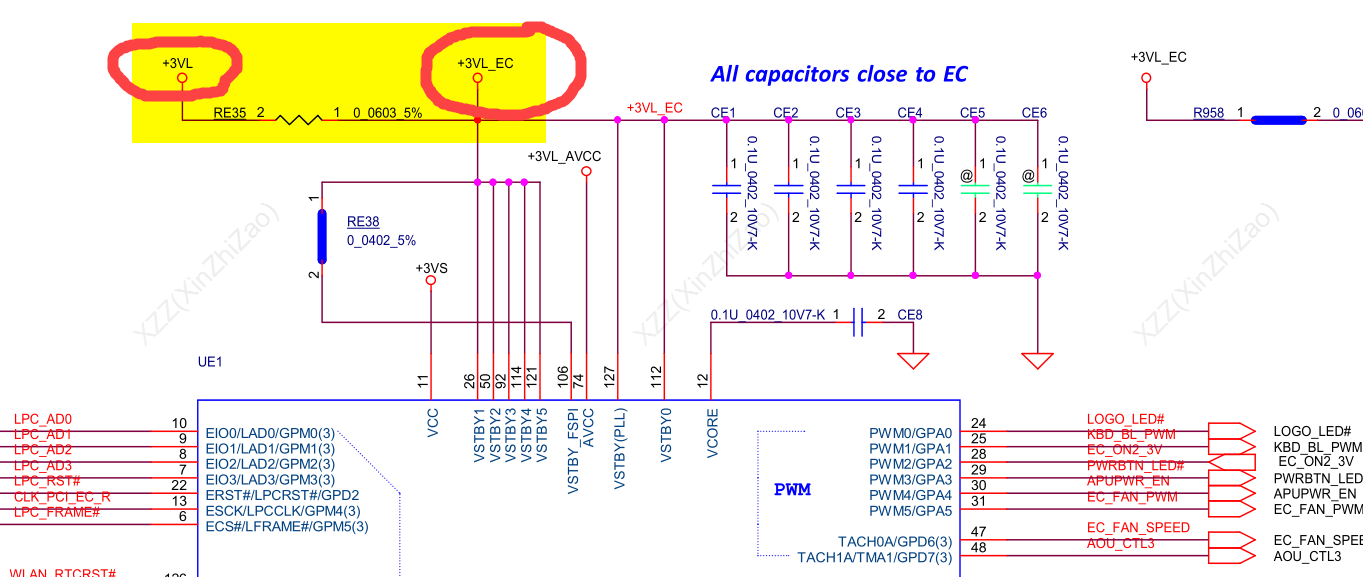

                              I checked it once as far as I understood.
                              +3VL is available with 3.3V. However, the other voltages on PU201 do not seem to be correct. I painted the measured values into the following image.
                              On the UE1 I was also able to measure the +3VL_EC with 3.3V which also arrives at 6 inputs from the UE1. I didn't detect any voltage at pin 11 (VCC) of UE1. This voltage should be +3VS.

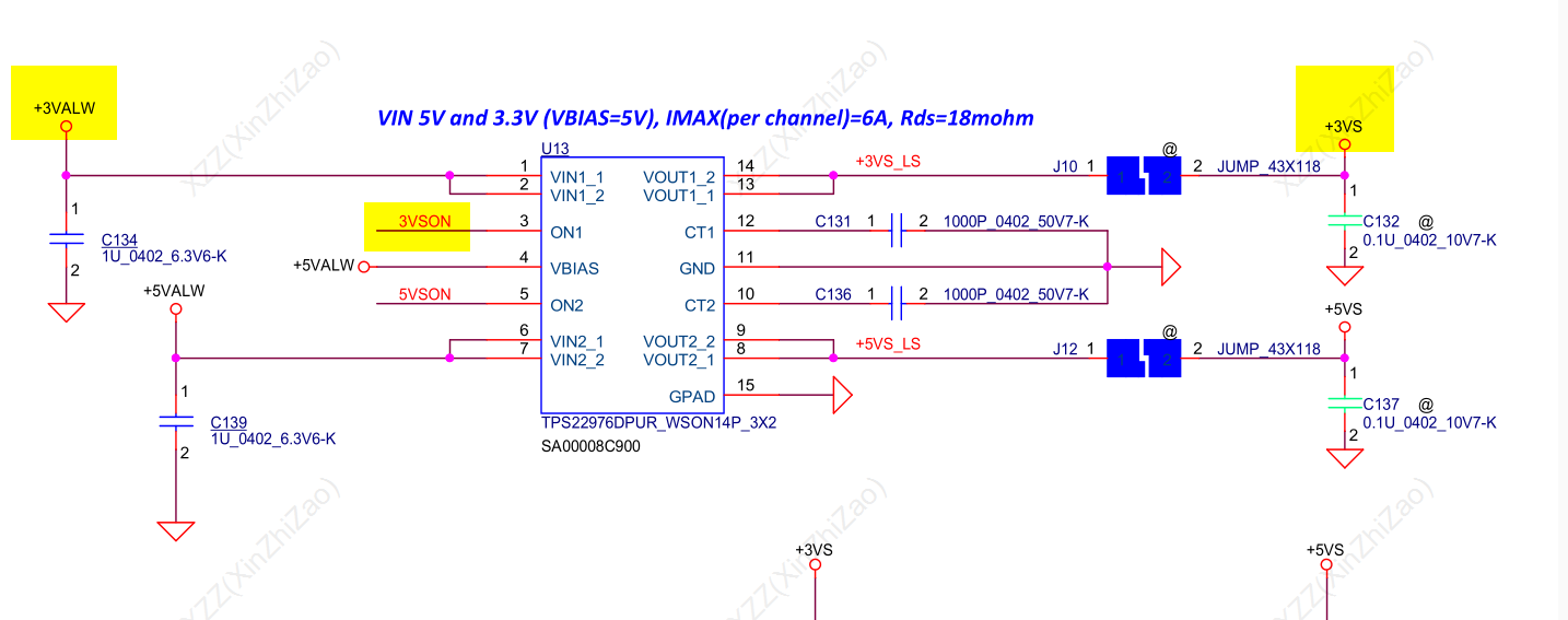

                              Since I was looking for this +3VS, I found the U13.
                              I measured the U13 and didn't find any voltage either.
                              Unfortunately I didn't understand the last image with ACIN. Pin 4 of the charger is the 20V, right?
                              If that is the case, this contact should go to the ACPRN of UE1 (pin 108). But only 0V arrives there. and there is no contact with pin 4 of the USB-C socket.​

                                +3VS is a rail that is created by +3VALW and is passed through the load switch (solid state relay) @ U13 provided the enable signal on pin #3 is active '1'.
                                Confirm that you have +3VALW present. Confirm the voltage to ground of pin #3 = 3VSON. If both of these signals are present and you still do not have a voltage at +3VS, then remove all power. Meter in resistance mode.
                                Measure the resistance to ground of +3VS to check if there is a shorted part on this low current rail.

                                  No voltage comes in or out of any pin on the U13. Resistance to ground of +3VS is 2.5kohm.

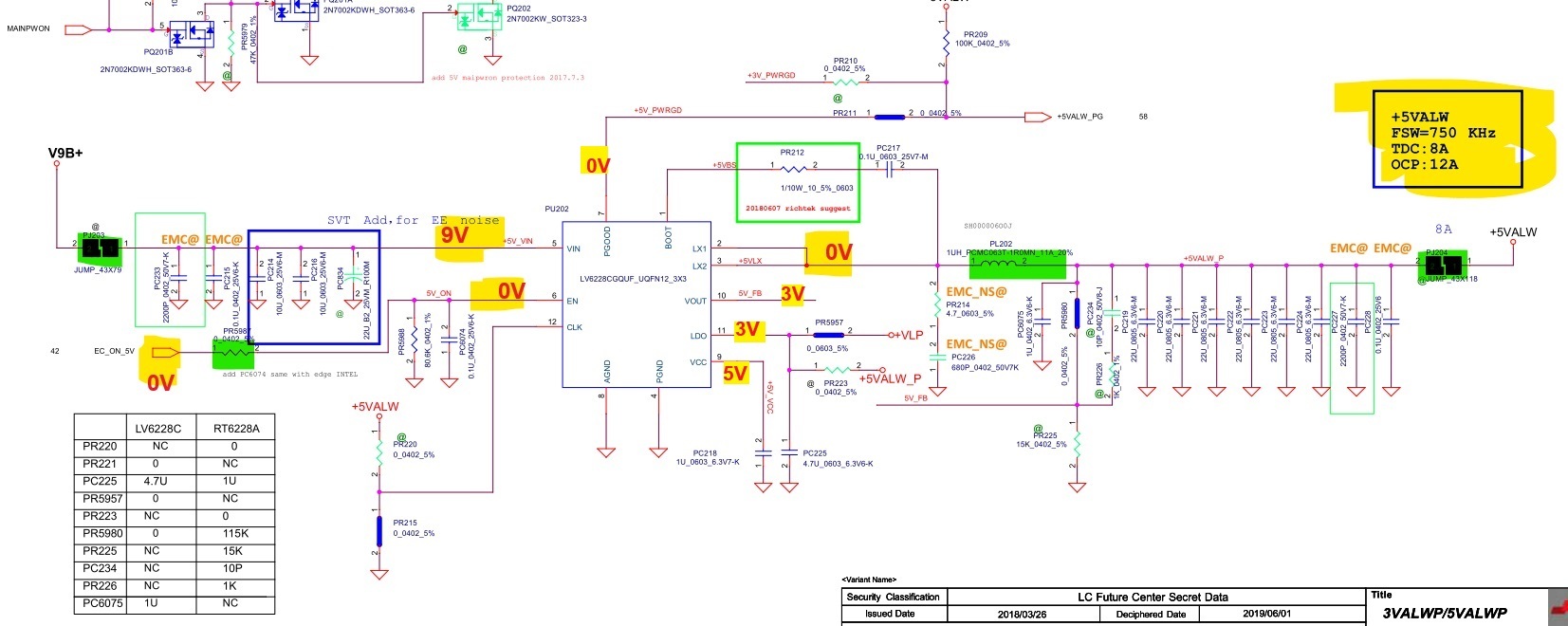

                                  I measured again on the PU201 (SYX198B). 9V arrives at pins 7 & 8. According to the schematic image there should be +3V_VIN...
                                  As you can see from my image from my previous post, only 0V comes out at pin 4 (OUT).​

                                    To see why the PU201 had 0V on the EN1, I traced the conductor path and came across the PR206 (20k). This one is fine. There is also the PQ201 and I measured the following voltages on it:
                                    • danny34
                                      • Jul 2024
                                      • 49
                                      Click image for larger version  Name:	1.jpg Views:	3 Size:	200.0 KB ID:	3329679
                                      If I understood correctly, EC_ON2_3V will come from PU1901 pin 16. There is 0V there. That's why I measured VCC of this PU1901 and there is 0V instead of +5VALW. I measured for +5VALW everywhere where this 5V should be present, but it was always 0V. So I continued looking for where this +5VALW came from.
                                      They come from PU202!
                                      At the PU202 at pin 5 (VIN) there is 9V, but at pin 6 (EN) there is only 0V instead of 5V.
                                      So it's due to the missing EC_ON_5V. Unfortunately I can't find where EC_ON_5V comes from.
