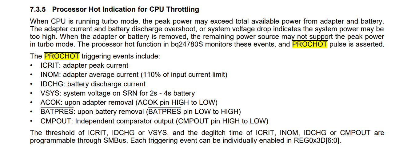

              Locate the charger IC. Is it the BQ24780S?

                Originally posted by mon2
                Any schematics?
                Click image for larger version  Name:	prochot.png Views:	0 Size:	195.9 KB ID:	3319435
                Charger iC Schematic

                  Measure the voltage to ground of pin # 23 on this charger IC.
                    3.97V

                      So this throttle action is NOT from this charger IC. When does this board 'slow down'? Is it after the logic board is mounted inside of an enclosure? There is a thread on this forum where there was a shorting during the clamshell assembly and this led to the logic board being throttled.

                              • mon2
                                • Dec 2019
                                • 13953
                                At this time, the CPU is being throttled. What is the voltage to ground of PROCHOT#? This is pin #23 of the charger IC you have linked earlier. This label is with a '#' suffix which means the logic line is active LOW. That is, only if this signal is LOW = ~0 volts then the CPU will be throttled due to this signal.
                                The fault may be elsewhere since this signal is ~3v97 = logic high.
                                Does the ThrottleStop software work for you? When you run this software, what is the voltage to ground of PROCHOT#?
