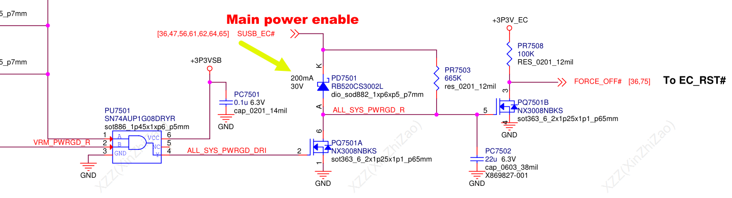

                          VDD_BATA_PACK seems good, I checked PD5501 and D7403, they don't leak.
                          I checked all PD parts on the board and find a leak on PD7501 (tested with PD on the board).
                          Red probe on Anode is 0.273 and Red probe on Katode is 1.043

                            Is it the attached diode you are testing?
                            If yes, flux and carefully lift one leg of the part but only if you feel comfortable. Do not believe this is a fault but can double-check.
                            After you lift one leg -> allow this part to cool. Then test again while one leg remains on the board. The diode must block in the one direction (not boy band).

                              Yes, that is the one, but it measures fine when I take it off the board
