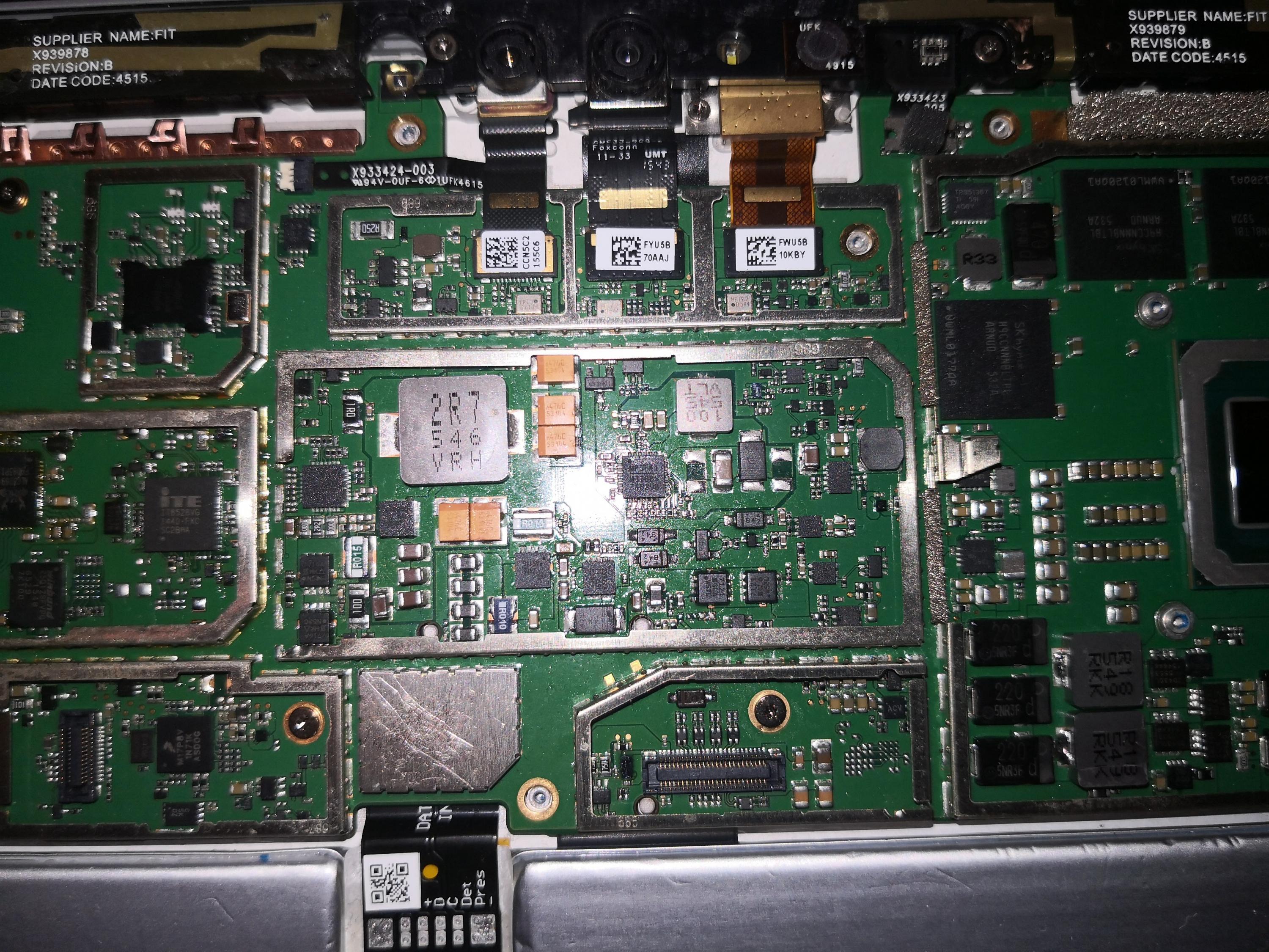

    My name is Nicolas, I live in a little town near Paris, France.
    I like to try to fix electronic stuff principally game console but I try to change device type.
    I bought few days ago an Surface Pro 4 (core i7 cpu, 8Go of memory). Seller told me that I had a lot of difficulties to wake tablet after puting it in sleep mode and one day it was impossible to switch on his tablet.
    I managed to remove screen (but I broke it ) and check what if found as common faillure on net :
    * charging diode
    * bad fuse
    * bad it8528g
    All my mesurments on this 3 points were fines. Nevertheless I decided to replace the it8528g. I done that by reading this article : https://www.aonemobiles.com.au/2020/...cs-no-problem/
    After remplacement, 3.3 volts is present on cap near it8528g, so I think that I soldered new chip well but tablet doesn't switch on.
    I decided to mesure some voltages and resistances to check if all rails were presents and if there was no short to groud.

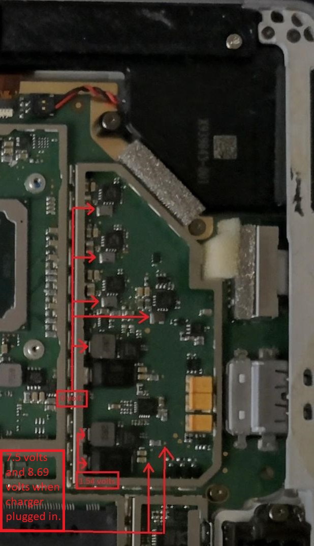

    What I noticed with measurements :
    * no obvious short
    * Battery charge well
    * 3.3 volts presents on switch button
    * voltage on pin 3 and 4 from buttons connectors (where switch and volume buttons are connected) are fluctated between 0 and 1.78
    * others voltages are quiet complexe to explain so I put my measurements on an picture joined with this message.
    This varying voltage between 7.5 volts and 8.69 volts seems very strange for me and 1.54 volts on inductor near usb port instead of 3.3 volts is obviously an problem. Fact I have no 5 volts on inductor lying between usb port and display port connectors is also an problem.
    Have some advice in order to understand whats happens ?
    Wich measurements may I do ?
    Where are test points ou points too check power rails ?

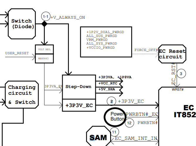

                  I also try to find some clues by using page 5 of schematics. This page deals with power sequence. I focus on first steps.
                  According this page, voltages of always_on and 3P3VA_EN go to an step-down converter which produce differents voltages. I could see it on first attachment.
                  With help of ifixit teardown, I think that I localised an step down converter. Values seem be good except 3P3VA_FB and 3P3VA_SLEEP. You could see values on second attachment.
                  Am I not be able to localise step down converter for 1.8 volts and 5 volts. Could you help me ?

                    Follow the numbers on Pg5. The EC (which you have replaced) is responsible for most of the enables for the S5 power supplies, however this does require some feedback from the PCH in order to output the enable.
                    For example, EC outputs PCH_DPWROK (6), which then requires SLP_SUS# (7), in order to then output VSUS_ON (8). Only with that enable will you see +3P3VSB etc turn on.
                    You have to start at the beginning and work your way through, this is why the power sequence diagram is a good troubleshooting tool. At the very least, you need +3PV3_EC @3.3V and EC_RST# high. If the latter line is 0V, then the EC is stuck in reset and won't do anything. Additionally, the EC has to load its code from the EEPROM U3104 on initial power on/reset. You need a scope to see if there is indeed any activity on the data lines and that's also assuming the code therein is ok.

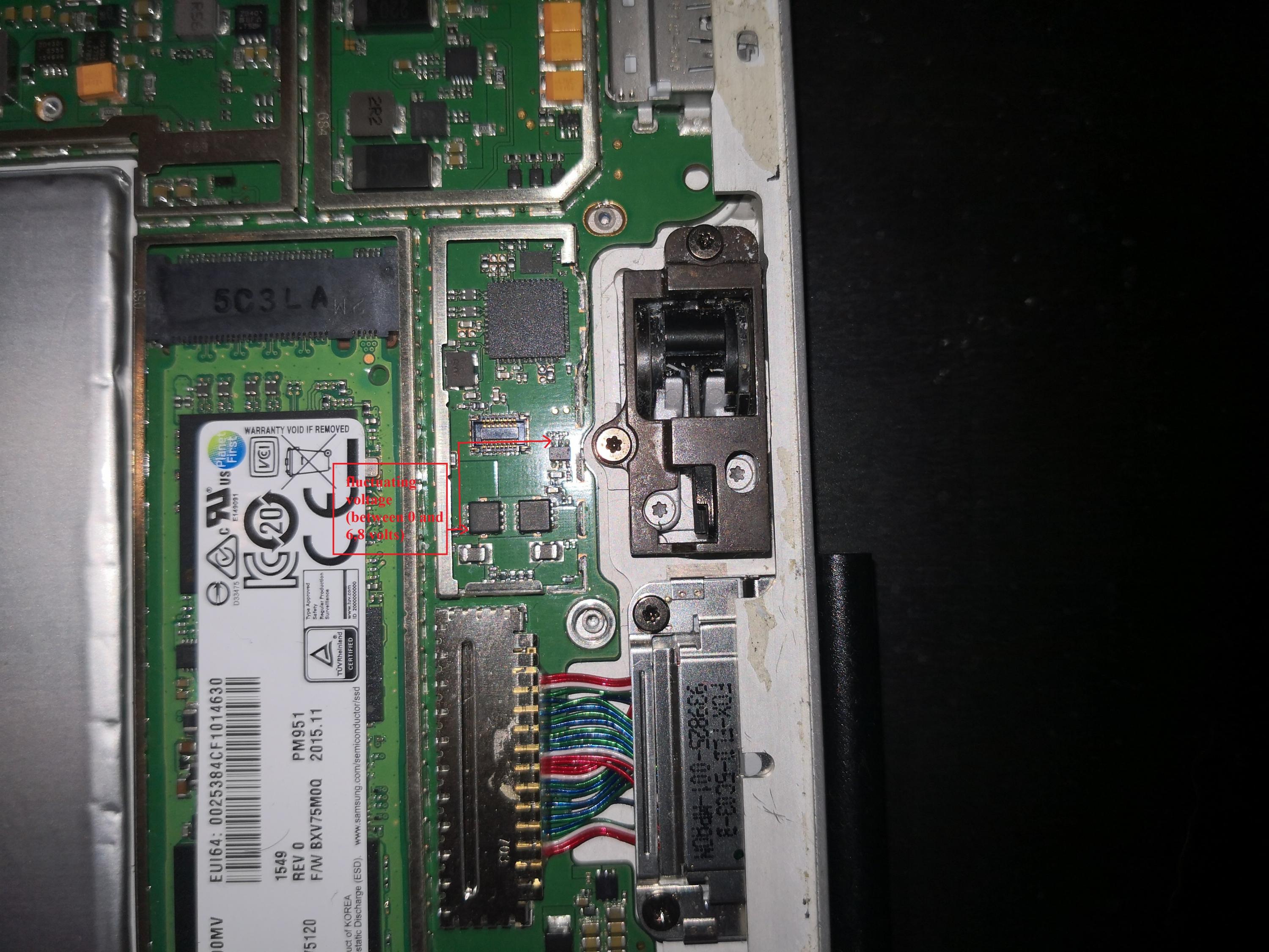

                        If I understand, at step 5 I have to find voltage for VCCDSW_EN. With boardview I found an point to meseaure this voltage which is 0 volts on my board.
                        According you, what value I have to find ?
                        An stupid question but what is meaning of EC after voltage value ? Same question for VSB ?

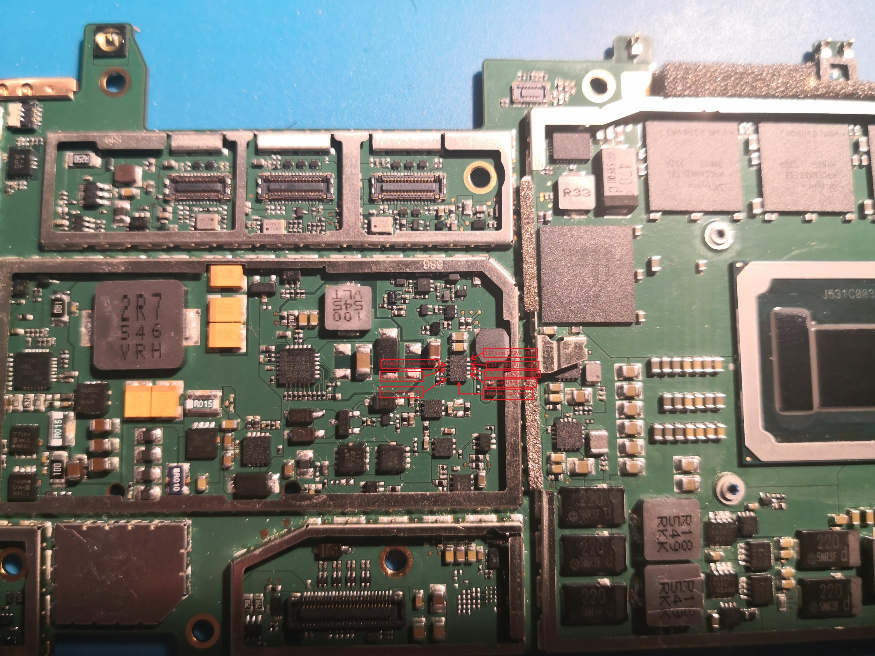

                                    Something change on my surface pro 4 motherboard.
                                    Last evening I decided to let charge battery during all night long to carry on my tests using battery.
                                    This morning I notice battery is flat whereas voltage was about 7.5 volts before I put battery in charge.
                                    Now I have only 2 volts on big coil and 0 volts on output mofset near charging port.
                                    I have 2.45 volts on coil from 3.3 volts rail and 0.62 volts on coli from 5.5 volts rail (near USB port).
                                    I can't figure what happens....
                                    Could you give me some help or give me some measures to do to highlight root cause of this sitaution ?

                                      I managed to retrieve my first situation by replacing another time the IT8520G. As before I have an fluctuating voltage (between 7.5 volts and 8.69 volts) on the big inductor mark with an red rectangle on the first picture when power adapter is plug in. Someone can tell me if this fluctuating voltage is normal ?
                                      I noticed that this fluctuating voltage is also present on mofset near power adpater connector (picture 2). If I am not wrong, according boardview, gate pin on the left mofset is connected to the third pin of an 6 pin labelled "DP". Voltage on this third pin is fluctuating too (between 0 and 6,8 volts). I wonder if it's normal or if this behaviour could be culprit ?
                                      I also noticed that the battery discharge completely after 3 or 4 days.
