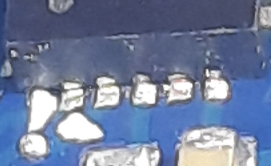

        Hello guys. need help again. This unit has no display after replacing shorted AOZ5547QI mosfet as you can see no voltage output in one of the three mosfet's. What could be the problem I am missing. Thank you in advance.Click image for larger version  Name:	HP X360 Convertible (Chewbacca) with values.jpg Views:	0 Size:	480.4 KB ID:	3308755

          Cpu got killed by 19V as AOZ5547 shorted.

            Also you did a horrible and likely insufficient soldering job. Maybe you clarify now why you have replaced this DrMOS, since the values are still somewhat inconclusive. +VCC_GT is not supposed to show voltage without load. And share resistance measurements of all power supplies around the CPU

                Thank you for noticing that, maybe I should invest with a better soldering iron and a microscope..
