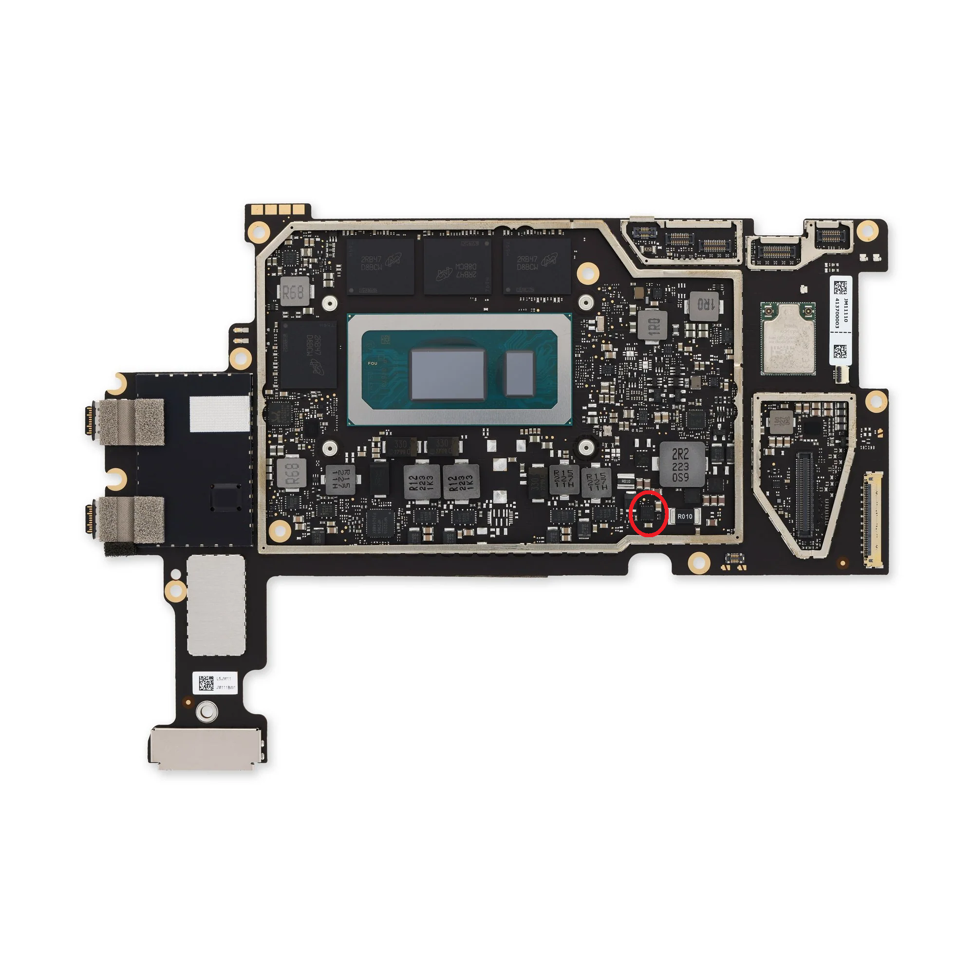

    Hi, my name is Fabrizio,
    I would like to take advantage of those who know more than me, this is a photo of a card from a Surface Pro 9 2038,
    Click image for larger version  Name:	Surface pro 9.png Views:	0 Size:	1.47 MB ID:	3302348
    does anyone know what the component with the circle is called? I have this code on the component but I haven't found the match, AT02 2E1X, It is located at the power input,
    Thanks in advance to anyone who can help me,
    Thank you.

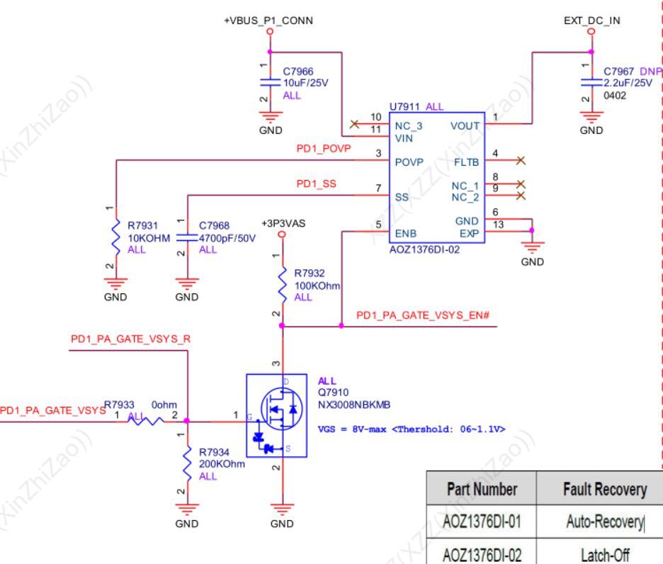

    The schematic of the Pro 9 is not out yet. It looks like the mosfet of the charging circuit. However, there needs to be another number on the integrated circuit.

      Probably an Alpha & Omega AOZ1376DI-02 Type C Protection Switch .Datasheet - https://www.aosmd.com/sites/default/...Z1376DI-02.pdf
      https://www.badcaps.net/forum/troubl...15#post1538441

        Pro 8 also has the same integrated. High probability correct diagnosis. As an alternative to the charging adapter, it transfers the type C supply to the charging integrated.
