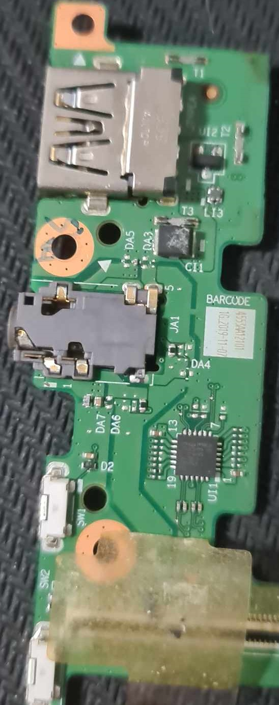

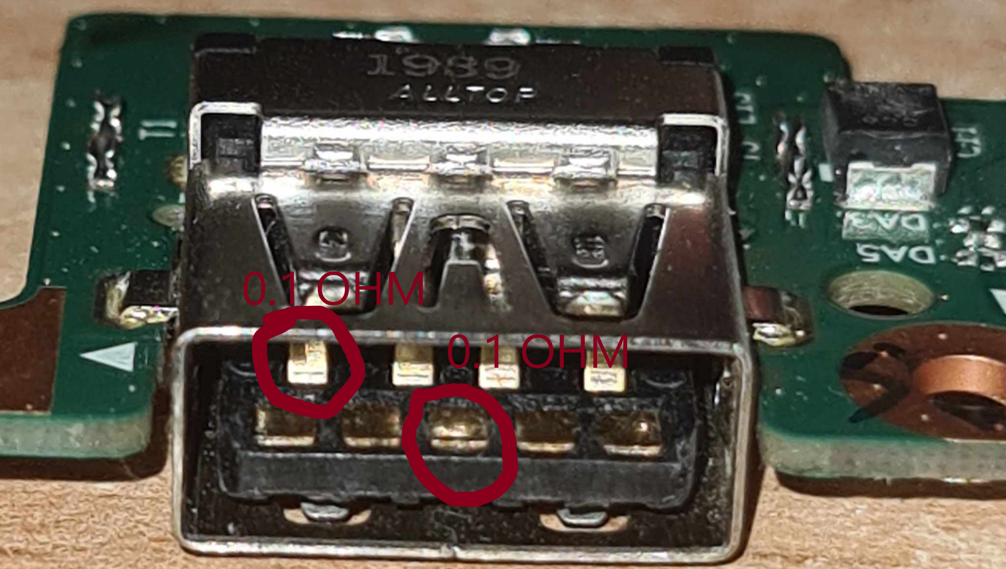

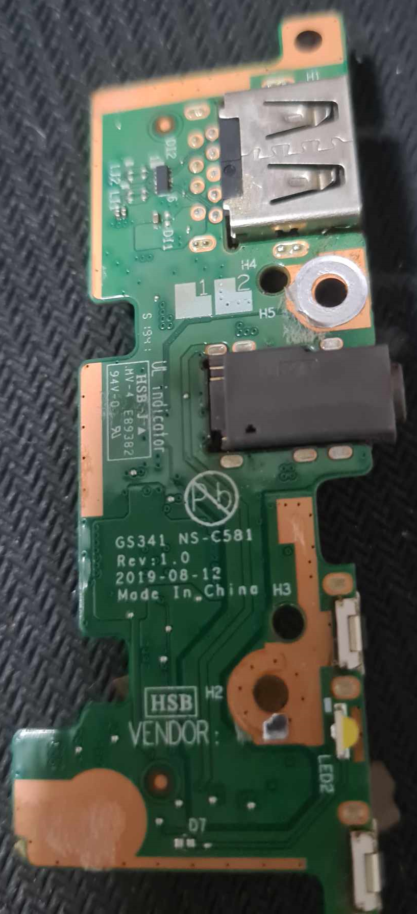

    So, there's this Lenovo, the USB is on a separate board, as far as I could tell, I examined it and didn't find anything unusual.
    When I checked the board with the multimeter, I didn't find 5V present, instead, there are 3V, 1V, and 0.7V. I'll attach everything I managed to measure
    Unfortunately, I couldn't find any documentation, boardview, or anything about this board
    Sometimes, Windows displayed the message, "The power consumption has exceeded the power supply capabilities of the receiving hub."
    What else should I measure to figure out why the USB isn't working?
    gs341 ns-c581 rev 1

    Somewhere on this or perhaps the main board should be a USB load switch. It is the USB load switch that alerts the host USB controller of an excessive current draw. Very likely that load switch is damaged - most are just crap by design. Once damaged, the VBUS rail is lost and so are the USB functions. You will have to use the DIODE mode of testing from point to point to trace back the VBUS pin of the USB connector till you can load the load switch. Share more details of the load switch once it is found. The load switches are quite common and easy to replace with other brands.
