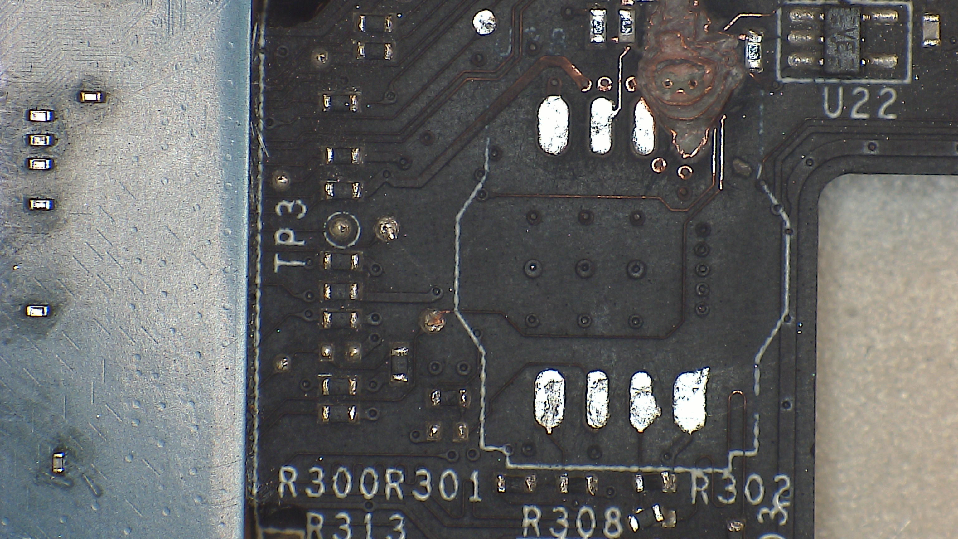

    I am missing 3x capacitors on this very damaged board and was wondering if anyone would know their values?
    Could 3.3k work?
    They are for CS pin 1 and DO (IO1) pin 2
    Thanks in advance

    Also I got the bios chip back and ran jumper wires but I think without the resistors to pull cs low it won't run firmware from bios?
    Can anyone assist?
    Thank you.

      Try with 33 ohms resistors.

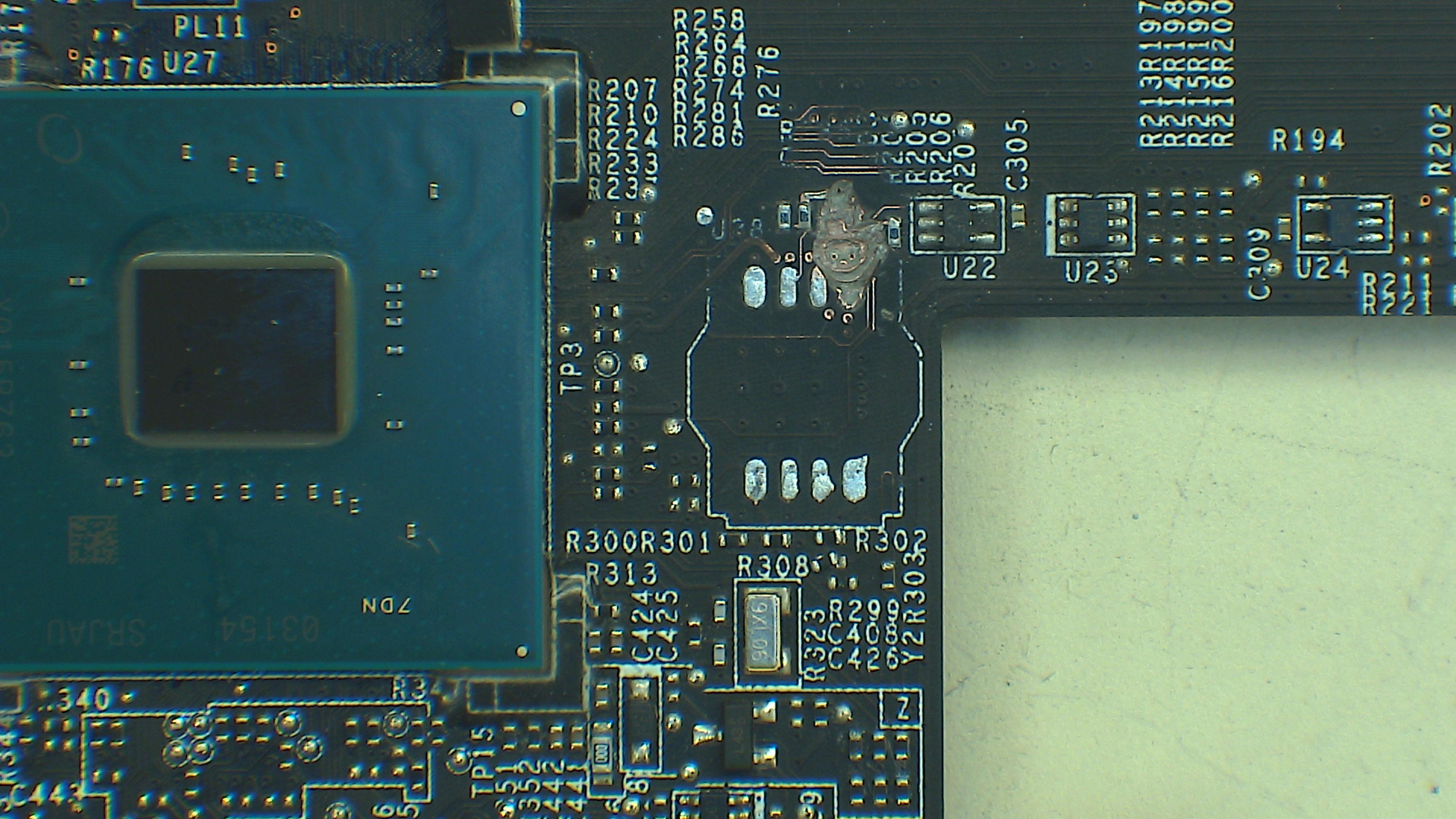

        adding another photo before it was destroyed=)
        Can you please mark up best way to add missing resistors.
        Thank you.

            The resistor pads seems intact ,so you can easily solder the resistor there and run a jumper wire from pin1 of bios chip to the missing resistor.

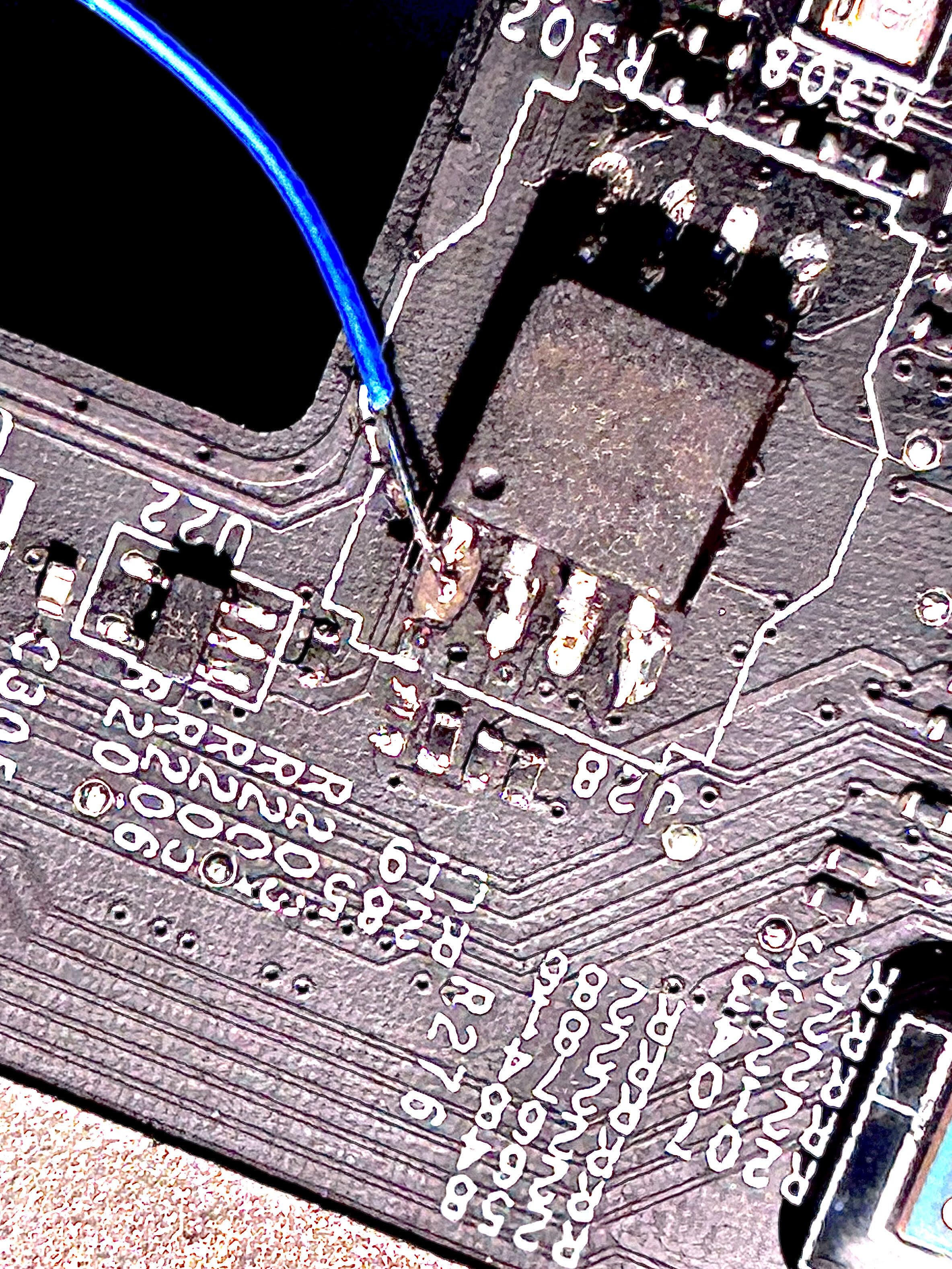

              please see TOP photo as bottom photo was previous state- TOP photo is more accurate as to what state board is in now-
              thank you.

                Can you please mark up photo as to what is what?
                I am confused with adding in 2 resistors as I need to run jump wires from ENE chip-1 wire from CS# to a resistor-->pin 1 of bios chip and 1 wire from ENE spi output to resistor--> pin 2 bios chip?
