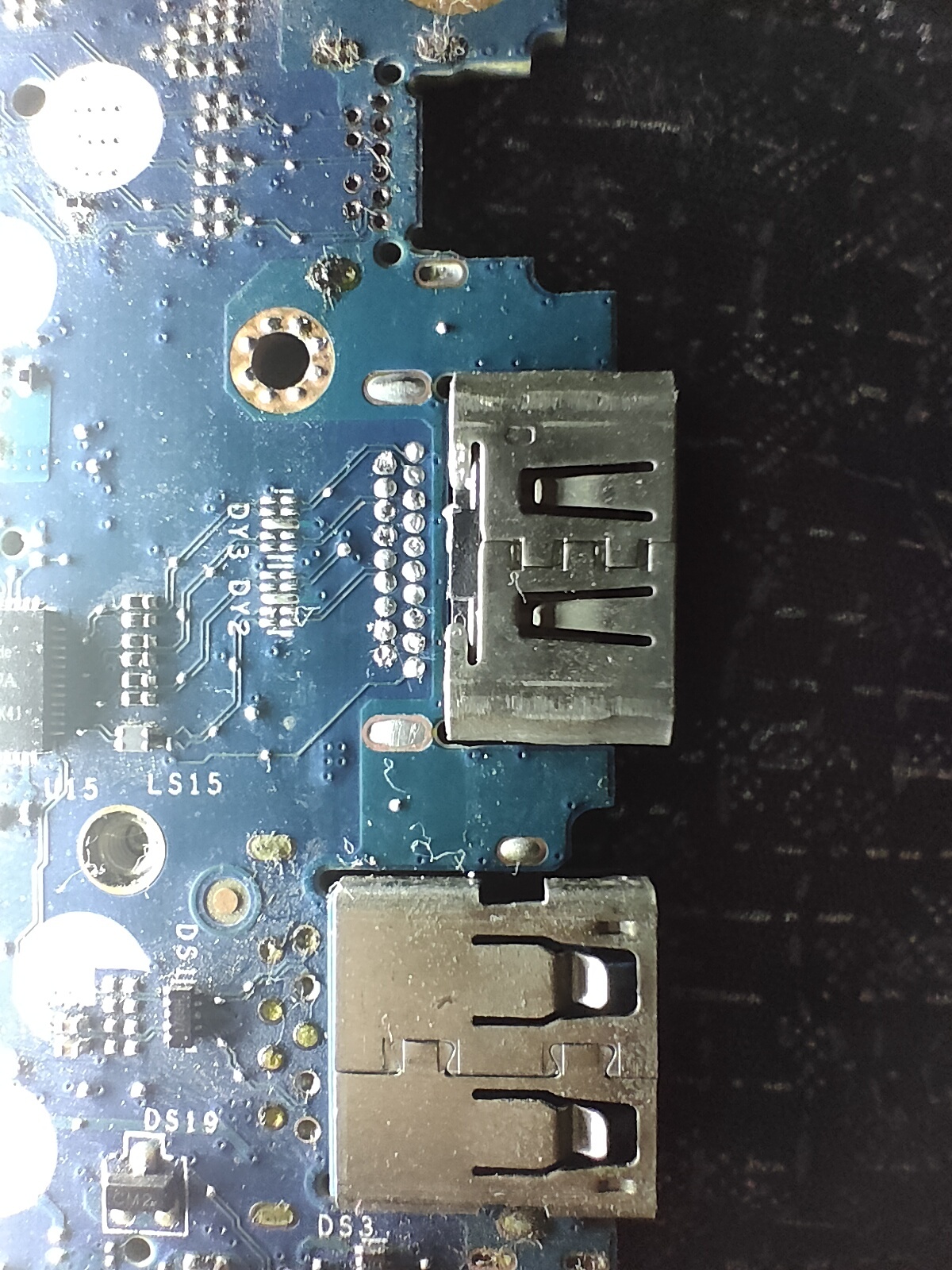

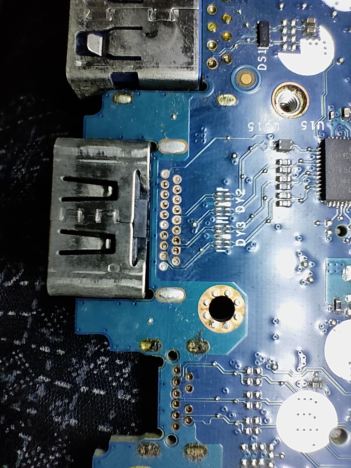

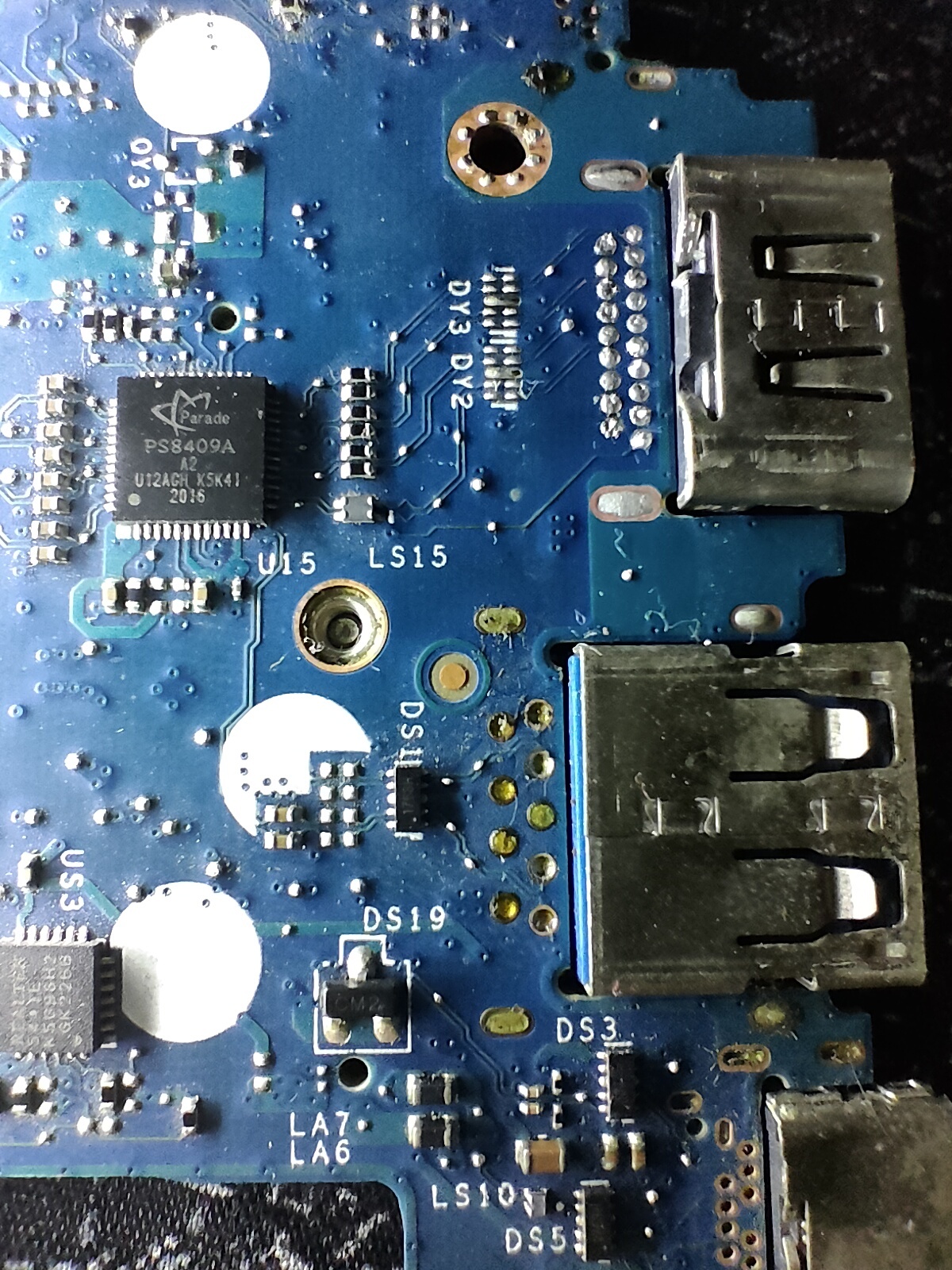

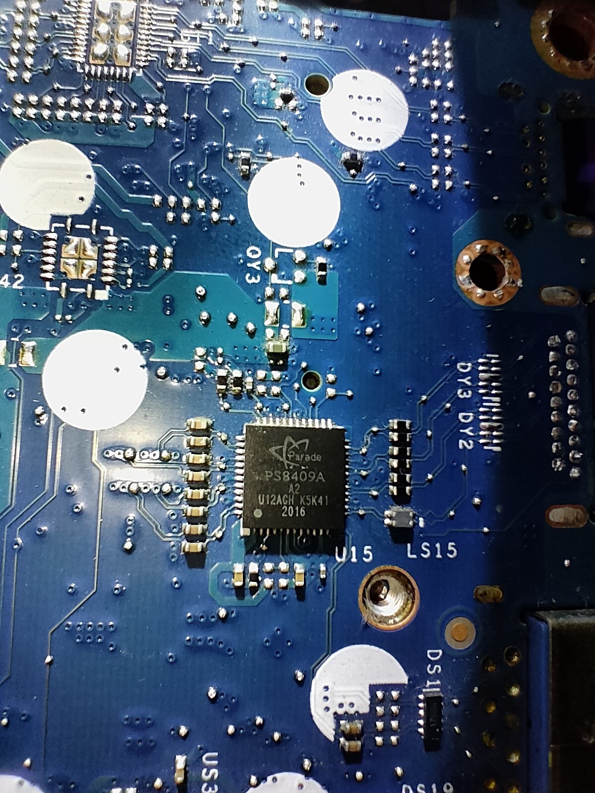

    My laptop was working fine until I made a grave mistake of changing the thermal pad and paste because my laptop was getting old and pretty hot. After changing and successfully testing temperatures, I was shocked when I tried to connect my external display, a 1440p 75Hz monitor, to it. My display never showed up; it always said 'no signal.' I tried swapping the HDMI cable, using both source 1 and 2 on my monitor, also tried connecting my laptop to a smart TV, but to no avail - still no signal. I also tried reflowing hdmi ports because i saw some detached pins.
    I have attached some close-up pictures of my motherboard's HDMI port and signaling chip, the 'Parade PS8409A A2.' Can someone guide me through the steps of what to check? I know I could easily get it fixed by technicians, but I do enjoy learning new things and improving myself.

    My suggestion is to flux and use a traditional soldering iron to flood the through hole connector pins for this HDMI connector. Do review the front face of the same HDMI connector to check if there is any damage.
    Is the Parade IC getting warmer than usual? It takes only a single missing signal to raise the fault you are observing from the HDMI interface.
    Consider to remove all power -> meter in DIODE mode -> short your meter probes and you should hear a tone beep -> then perform a point to HDMI connector through hole pad continuity testing from the Parade controller to the sink HDMI connector. Compare against the schematics.

      Does it work on some angles? Is the port moving out of position when you bend the cable up and down? What mon2 said is correct, "traditional soldering iron to flood the through hole connector pins for this HDMI connector".

        Thank you, mon2 and sikocan, for your reply. Yes, sikocan, I did try wiggling the HDMI cable slowly in and out at different angles, but unfortunately, it didn't work. I will try the above solutions and update you. 🙂

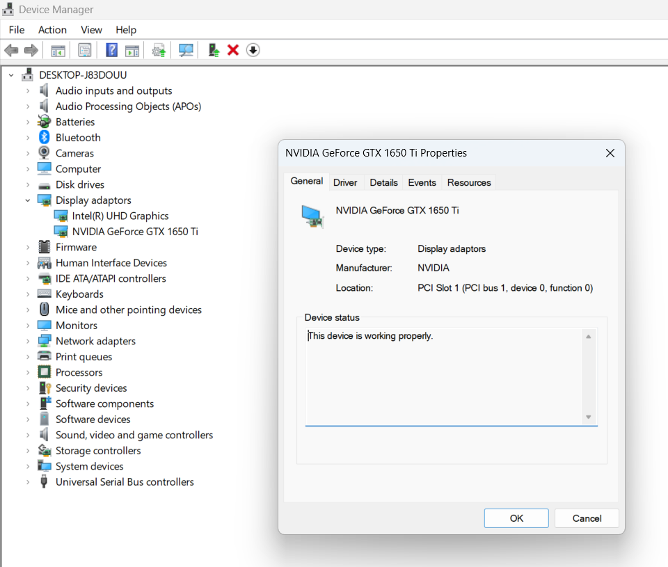

                  Hi Jayanta, I just finished a repair on AN515-52, and HDMI was unresponsive until I install the Nvidia graphic driver, without that no picture at all.
                  Just to check, have you any yellow mark under device manager for the 1650ti nvidia graphic part ?
                  We need to check that all software is working as it should. And try to reinstall the driver just in case that some update may have triggered the issue before touching the hardware more.

                    thankyou titomno2 for replying and No, i have the latest nvidia drivers installed and no "yellow mark" on device manager see attached "pic" I am inclining on trying mon2 and sikocan 's suggestion on reflowing solder joints and mutimeter's diode mode. As I am on a tight schedule (Work) I may try the above during weekends. 😊
