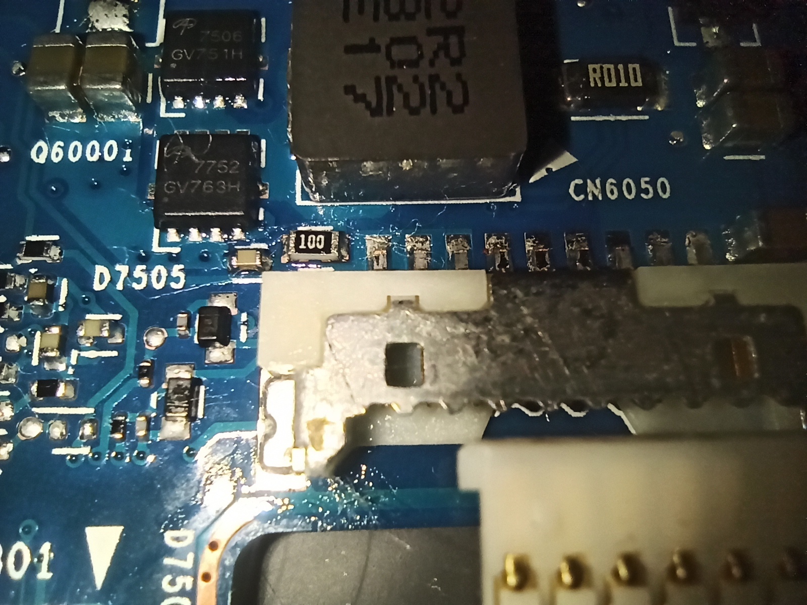

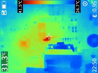

                            Because why battery coil has a pulsing voltage when no battery is connected ? Even the BQ chip is pulsing.
                            There is also a 10 ohm resistor very hot (nearly 90°C). This resistor is connected to the + of battery terminal and is in series to a capacitor. The other end of the capacitor is connected to GND.
                            This resistor is pulsing too.
                            Another thing when I plug a HDMI cable and start laptop I can see resistors near the HDMI connector pulsing too.
                            Quite difficult without any schematic

                              Some pictures of resistor + capacitor quite hot.
