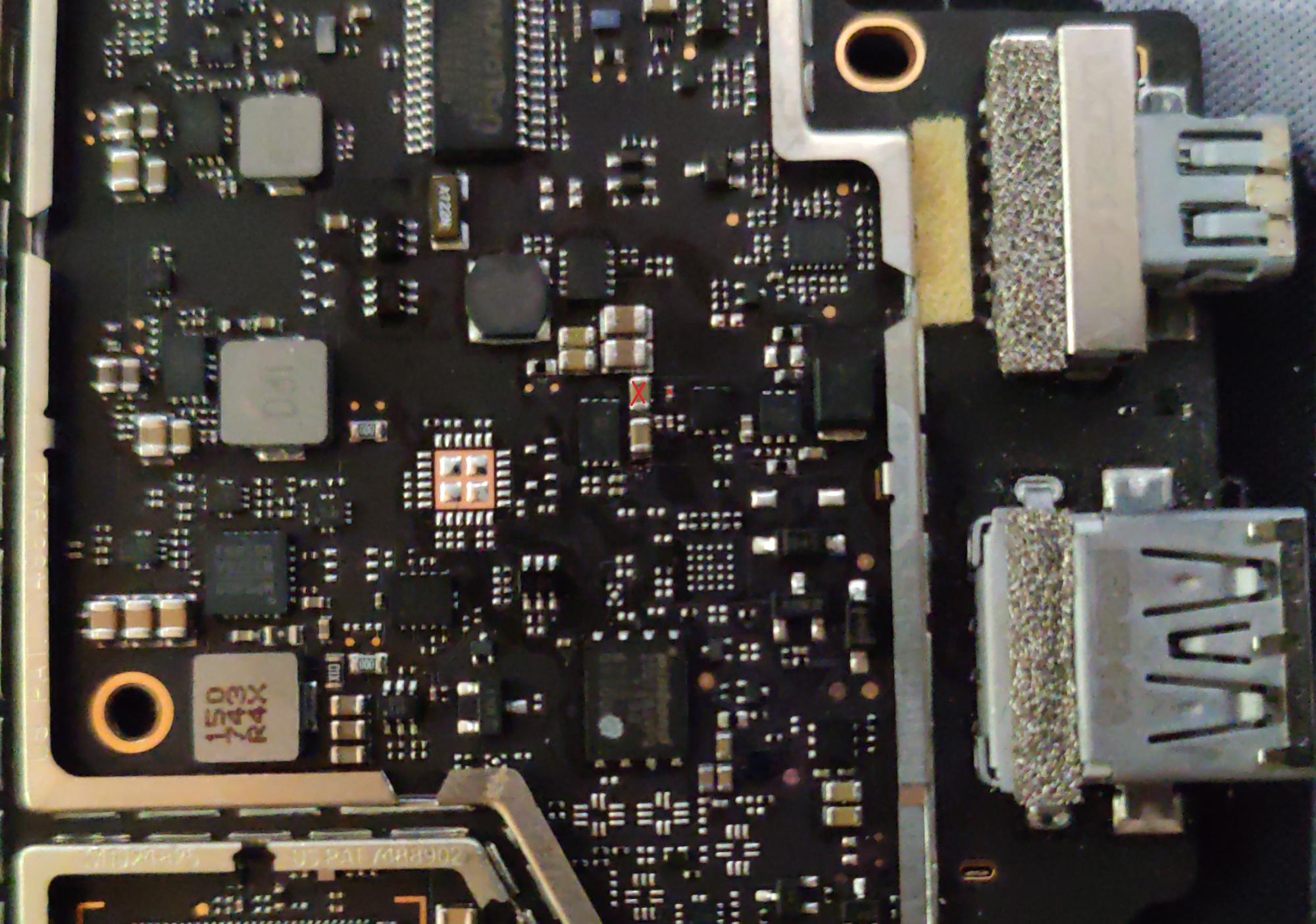

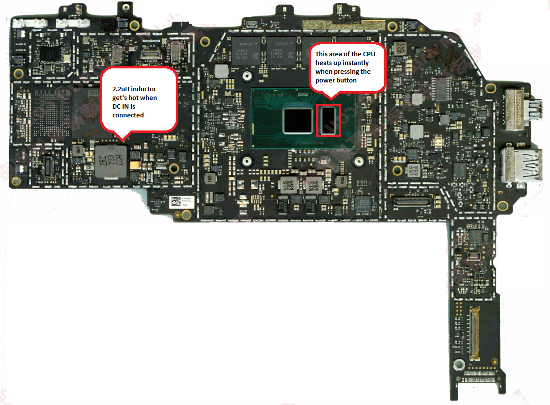

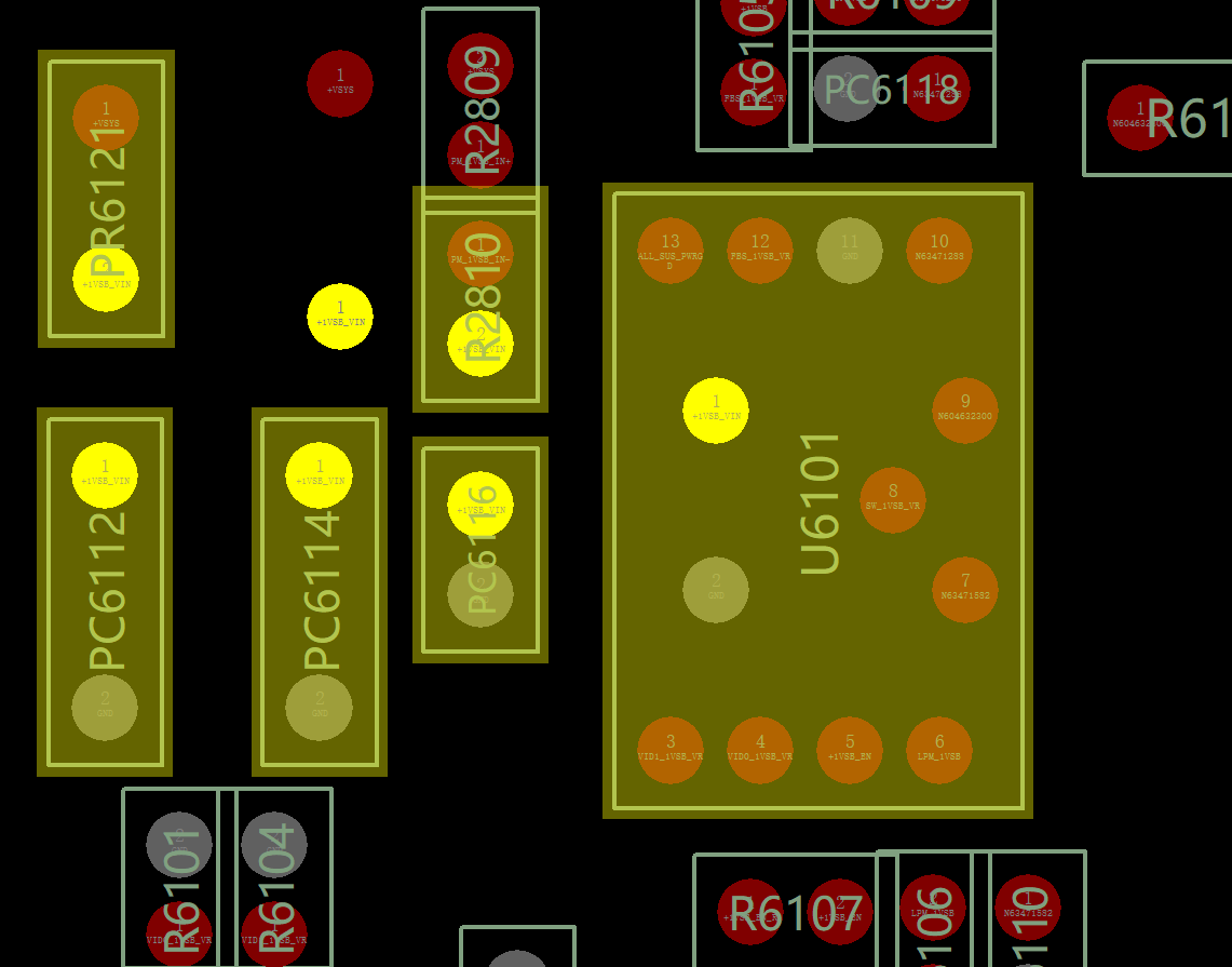

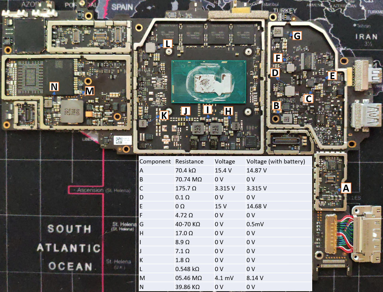

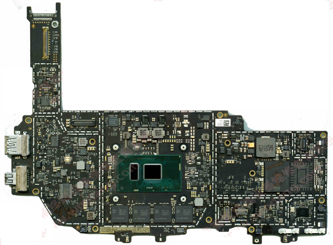

    Hey There,
    Trying to troubleshoot a SP 5 1796 (M1007506-015), most of the caps around the CPU area are shorted.
    When tracing from the DC in the first shorts I could find is near the USB & DP connectors.
    Tested with diode mode, red to ground.
    Two bad caps, marked in red on the attached picture, I currently don't have a bench PSU to attempt power injection, any best guesses as to which of the two could be the culprit?

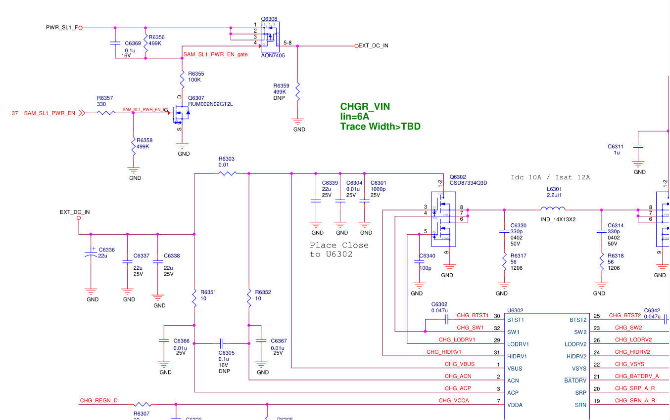

    Re: Microsoft Surface Pro 5 1796 - No Power
    Link or post a schematic for the logic board.
    Cpu power rails are low voltage rails. Respectively, they will also be low resistance rails.
    With no power, measure the resistance of these rails and post their exact resistance readings.
    With power, check the voltage to ground of each large coil. Each coil is an inductor and is linked to a local switching power supply.
      Unfortunately I don't have schematics, really wish I did, couldn't find them without some sort of paywall.
      I measured the voltage with the 15v DC connected with and without the battery, it appears that the battery does receive some voltage.

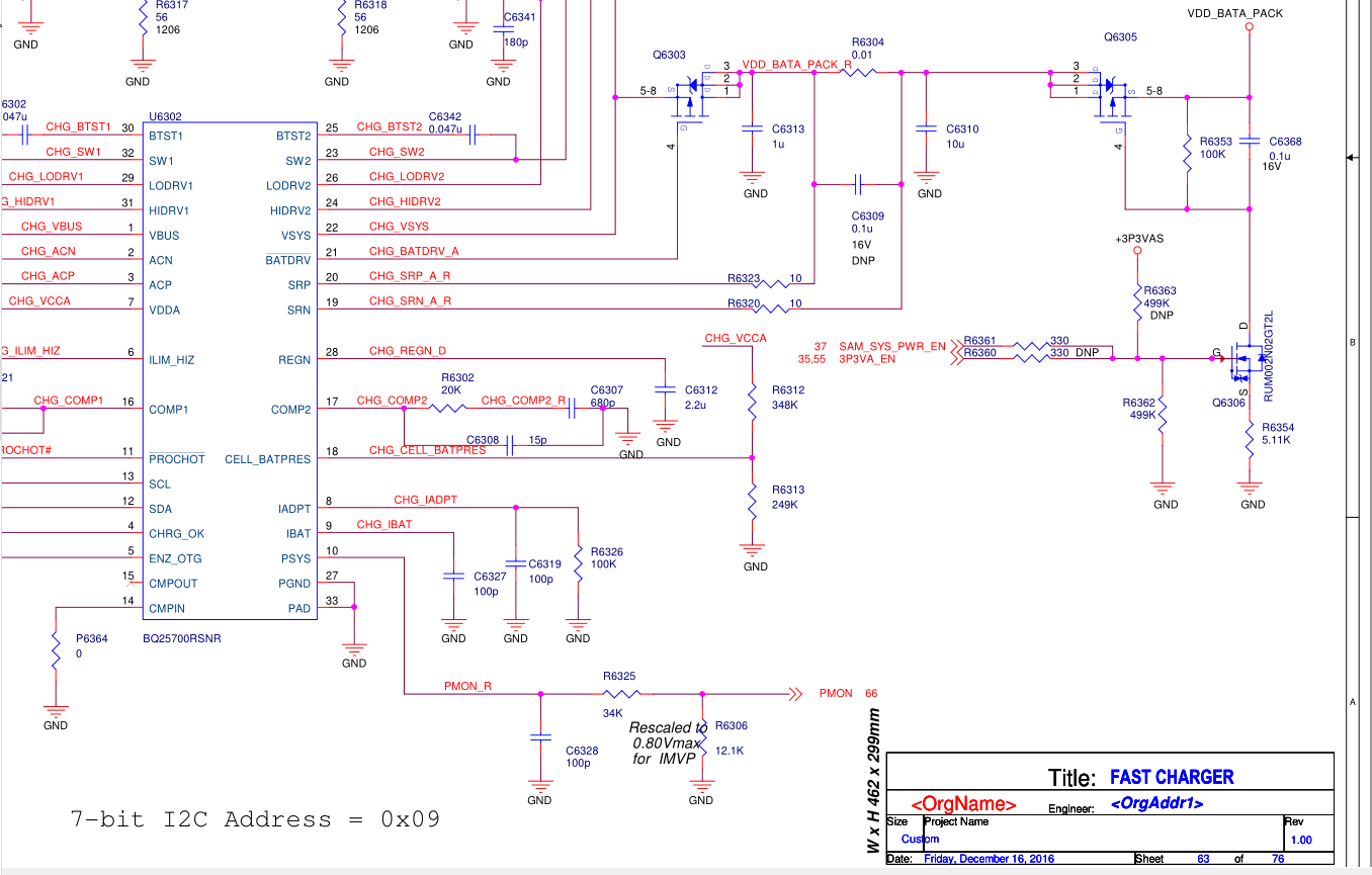

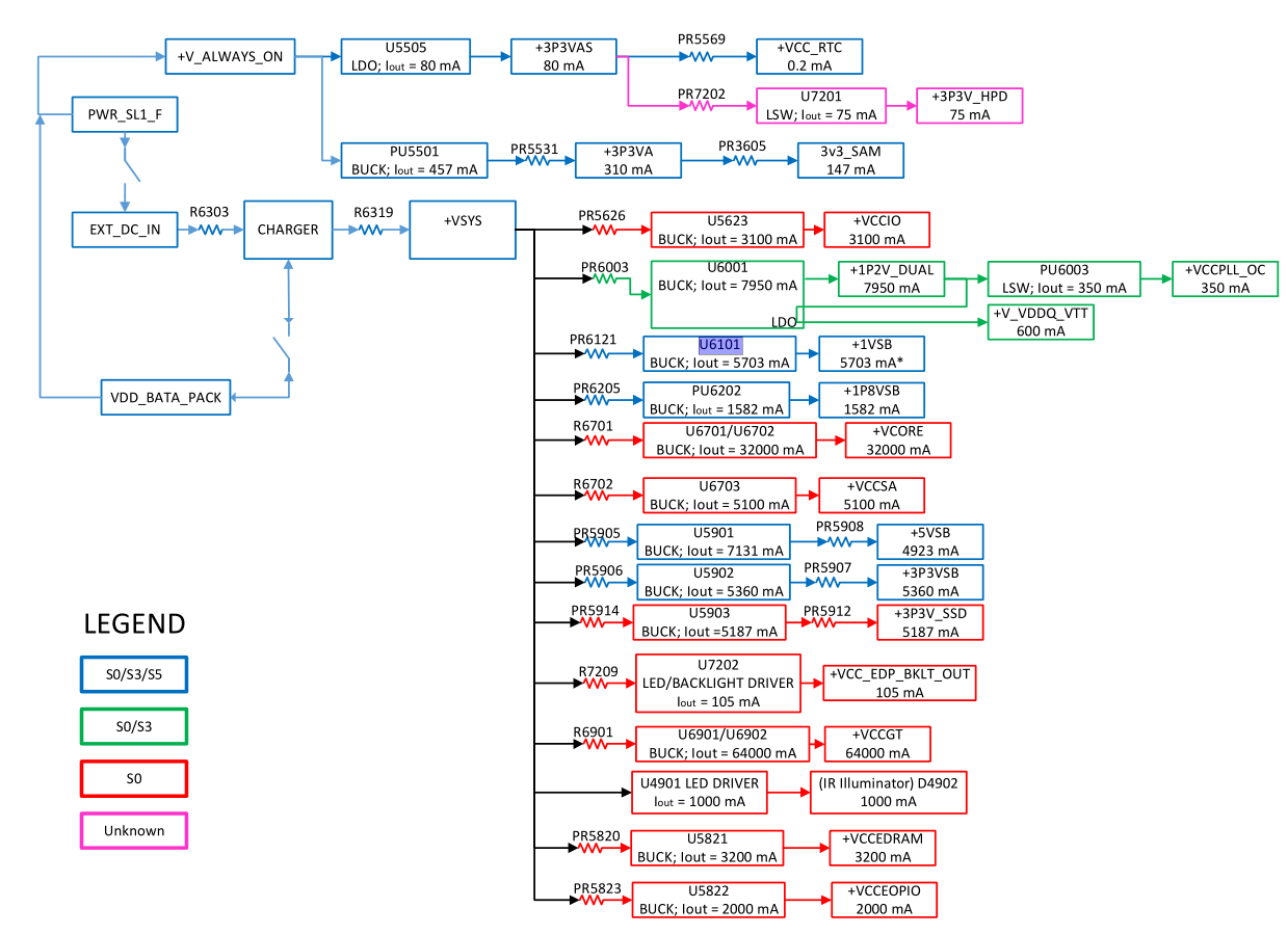

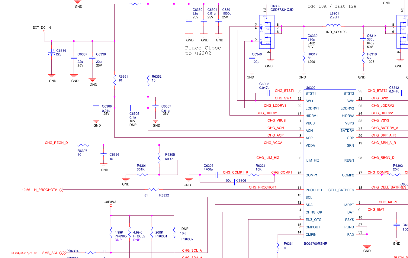

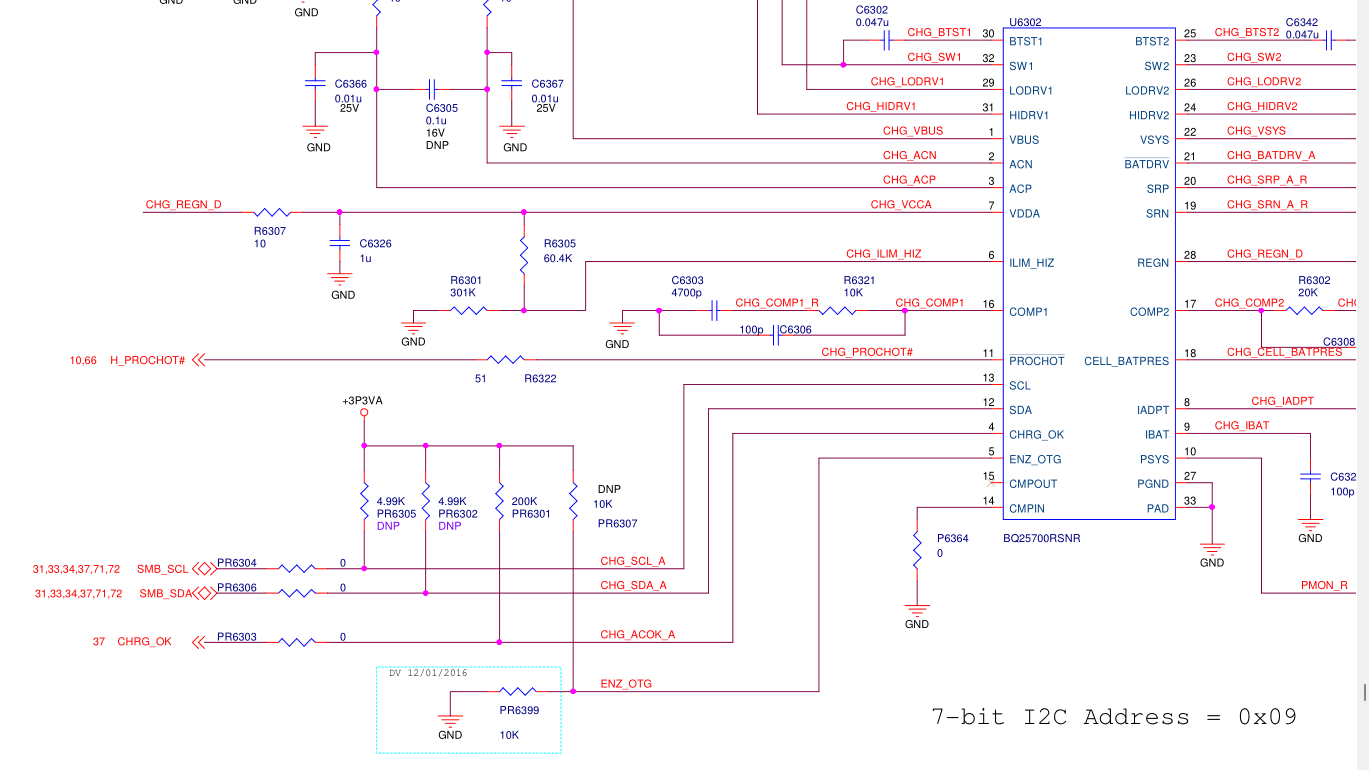

        See attached.
        • mon2
          • Dec 2019
          • 14662
          Start with measuring the voltage to ground of:
          a) charger IC U6302 -> pin #28 REGN
          b) +VSYS
            Thank you so much for the power rail info.
            on IC U6302
            pin #28 REGN = 5.98 V
            pin #22 VSYS = 8.8 V

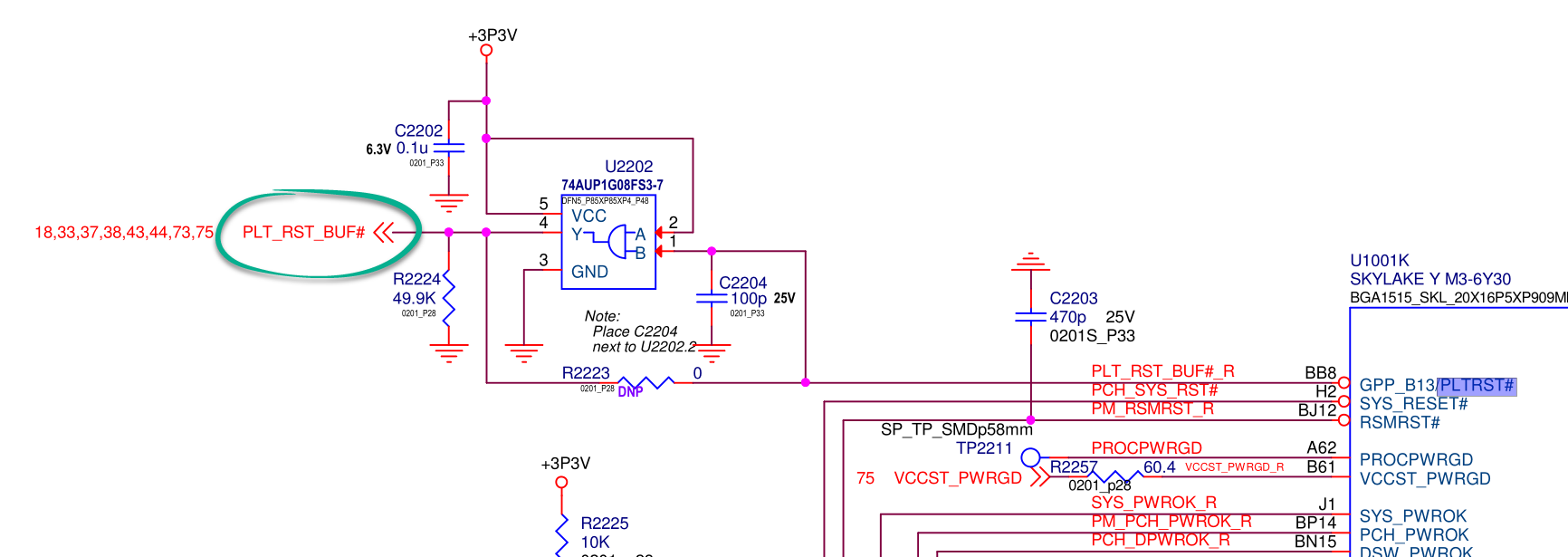

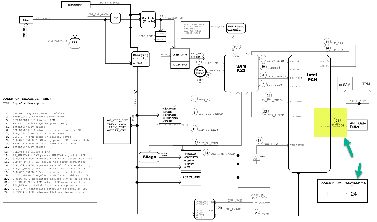

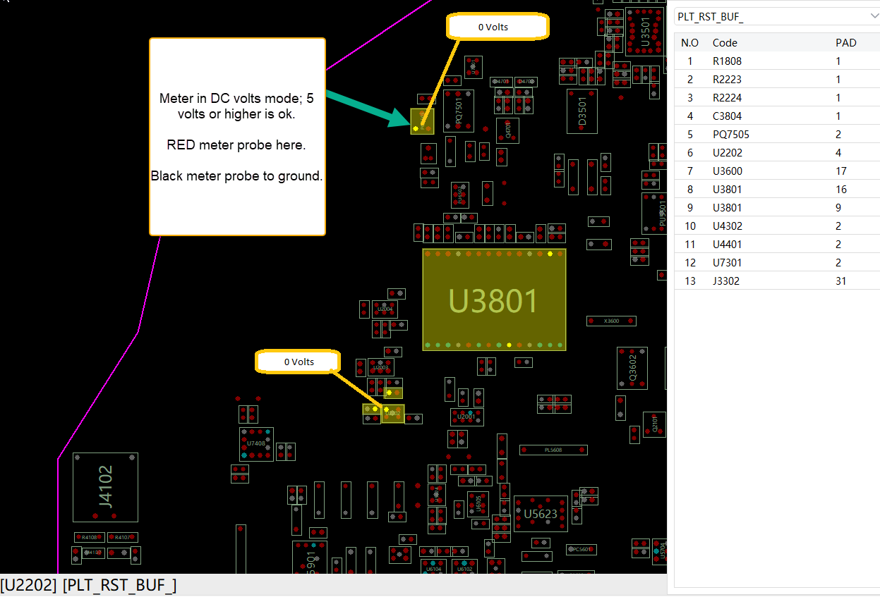

              Personally have not worked on one of these but the rails look to be ok.

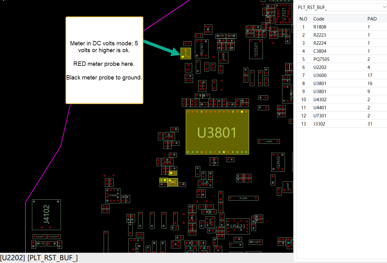

              See attached for the power up sequence. In the end, step # 24 is the critical one and this voltage should not be 0 volts. That is, this is an active LOW signal (denoted with the # suffix) so if this rail is 0 volts = logic low, the target is in RESET mode. Respectively, if all is well, this output should be a logic '1' = ~3 volts.
              Can you confirm it? It if is indeed ~0 volts, then each step from #1 onwards must be reviewed as shown in this chart to locate the fault.
              What is the voltage to ground of the attached and gate @ U2202 ?
                It's my first time attempting board level repair on something as advanced as this.
                Good news, step 24 is reading 0 Volts, so I have the opportunity to troubleshoot Steps 1-23
                  Yes, proceed with the chart in order and you should locate your fault. Continue to update your review. At this time, the conditions have not been met to release this reset line to be a logic '1'. Have to do some toilet repair for my mother. Yuch. Will check back later.

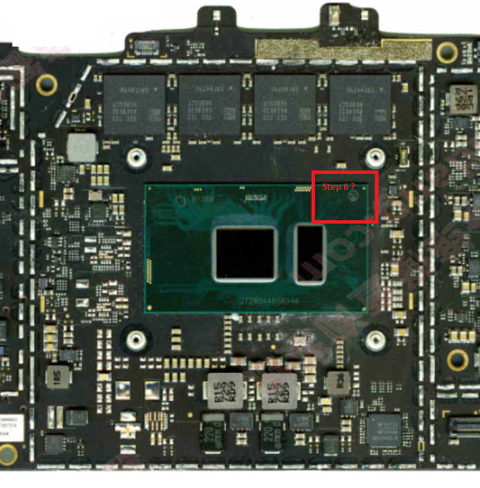

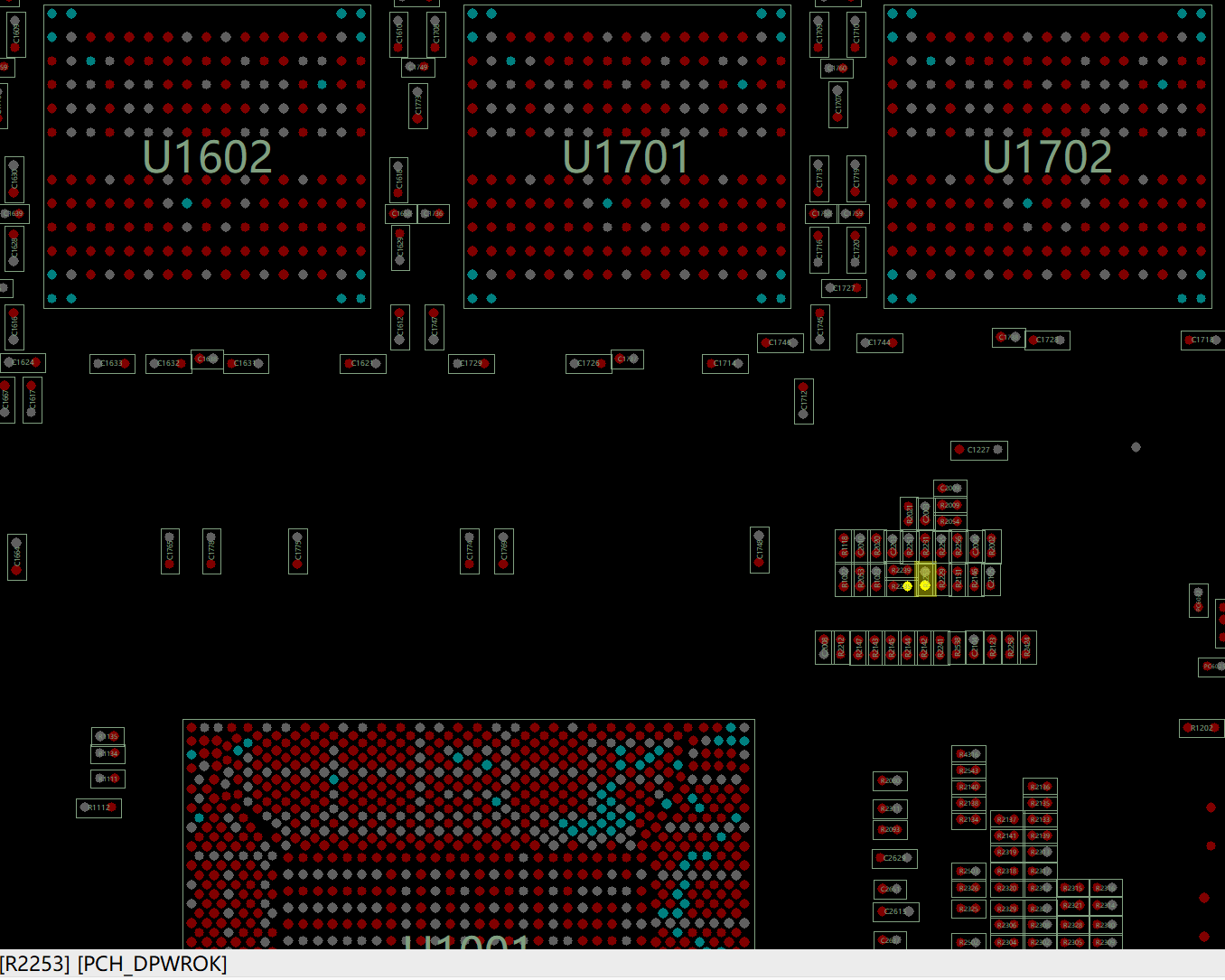

                    Good luck with the plumbing!
                    Had a go at testing voltage on the various component. Couldn't perform step 6 as the group of components is not present on my board, the other point is under the processor. Step 7&8 are both 0 volts, Step 7 has a # so assuming it should have positive voltage.
                    Now I'm not sure if the answer to the riddle is in Step 6?
                    Step 1: 3.299V
                    Step 2 3.3V
                    Step 3. 3.291 V
                    Step 4: 8.8v
                    Step 5: Skip
                    Step 6: PCH_DPWROK / Declare deep power good to PCH (can't locate on board)
                    Step 7: 0 Volts!
                    Step 8: 0 volts
                    Step 6
                    It's getting late this side, happy festivities!

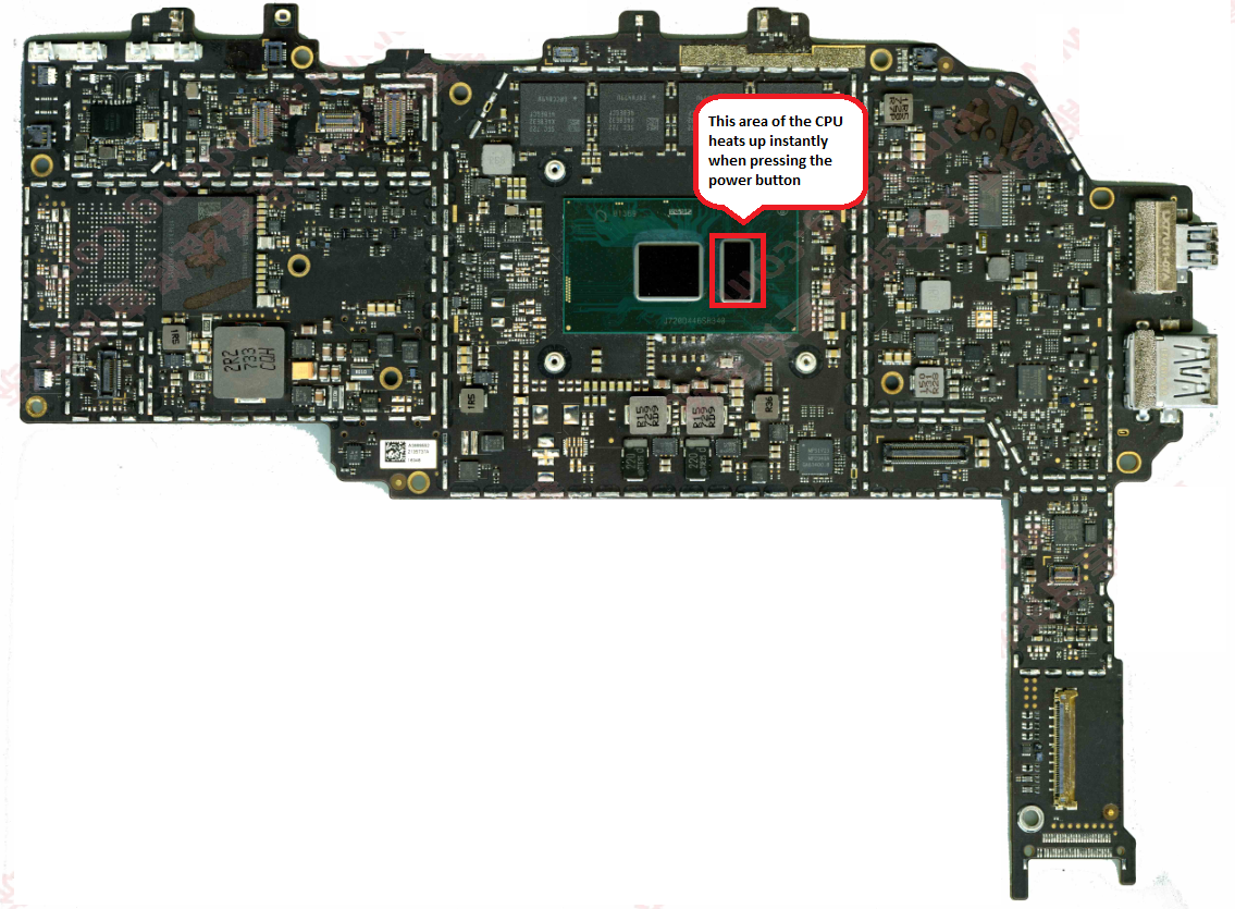

                      Interesting observation, when pressing the power button the smaller portion of the CPU instantly heats up for a moment....
                      Not sure what this means but it's a new data point.
                      • reformatt
                        • Feb 2020
                        • 1495
                        That's the PCH ;-(. Check the PCH power rail (usually +1.05V) resistance to ground. Usually thats at least 100 ohms or more.

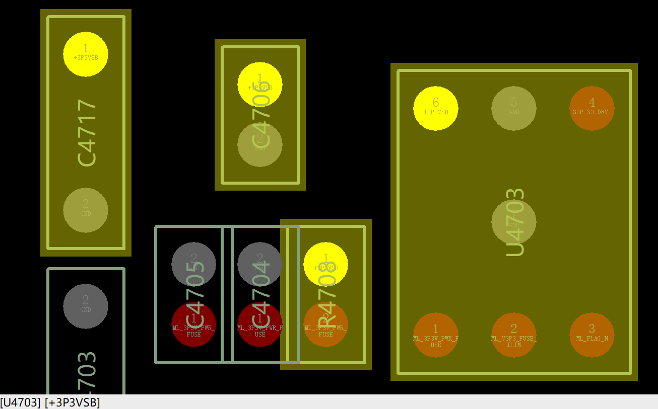

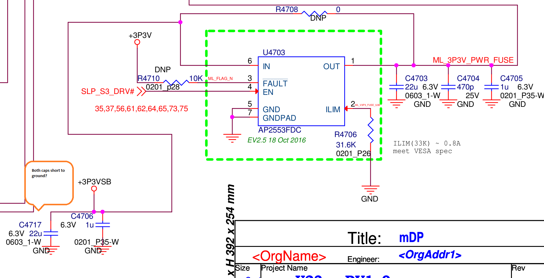

                          I tested this +1VSB to ground and it's 0 ohms...
                          The caps connected to this fuse U4703 are also shorting to ground, not sure if this is the behavior of the fuse or not (pn AP2553FDC).. U4703 seems to be related to the display port so might be OK to ignore,
                          I know the the 3.3v rail does have power as I get 3.3V from the SAM, not sure where it's shorting

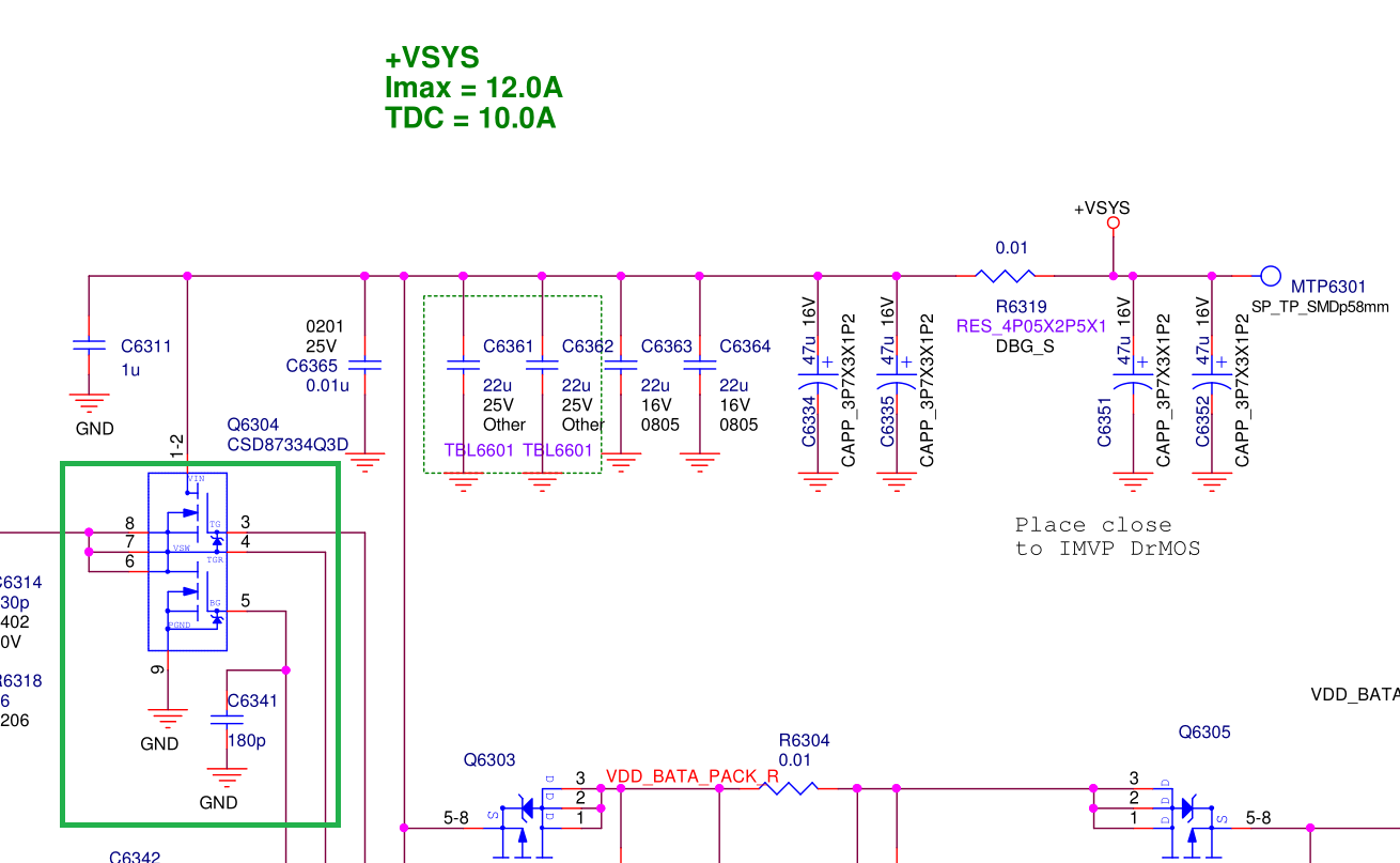

                            • South Africa

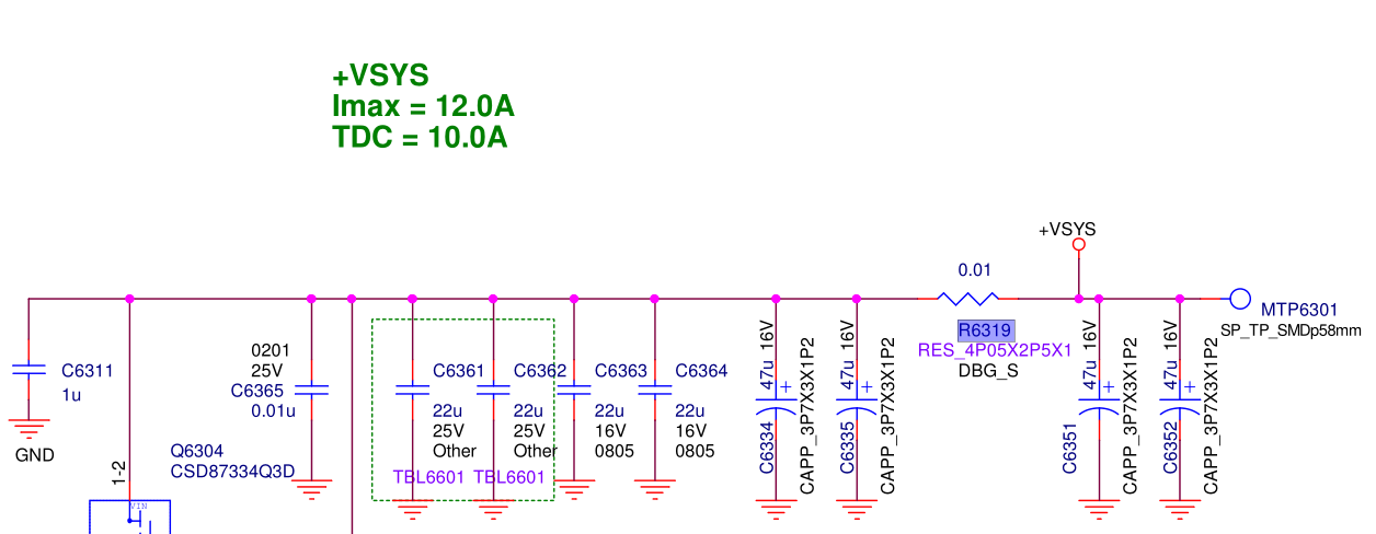

                            Re-testing a bunch of things..
                            If I measure VSYS on R6319 I get 0.737 V is this a little low?

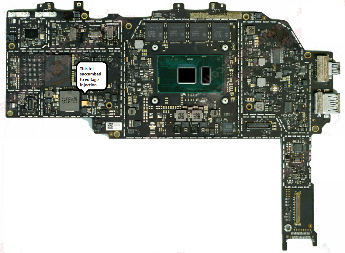

                                  Inject voltage see what gets warm. I’ve had a bad MLCC in the mix of the cpu caps on the pro 5 ��

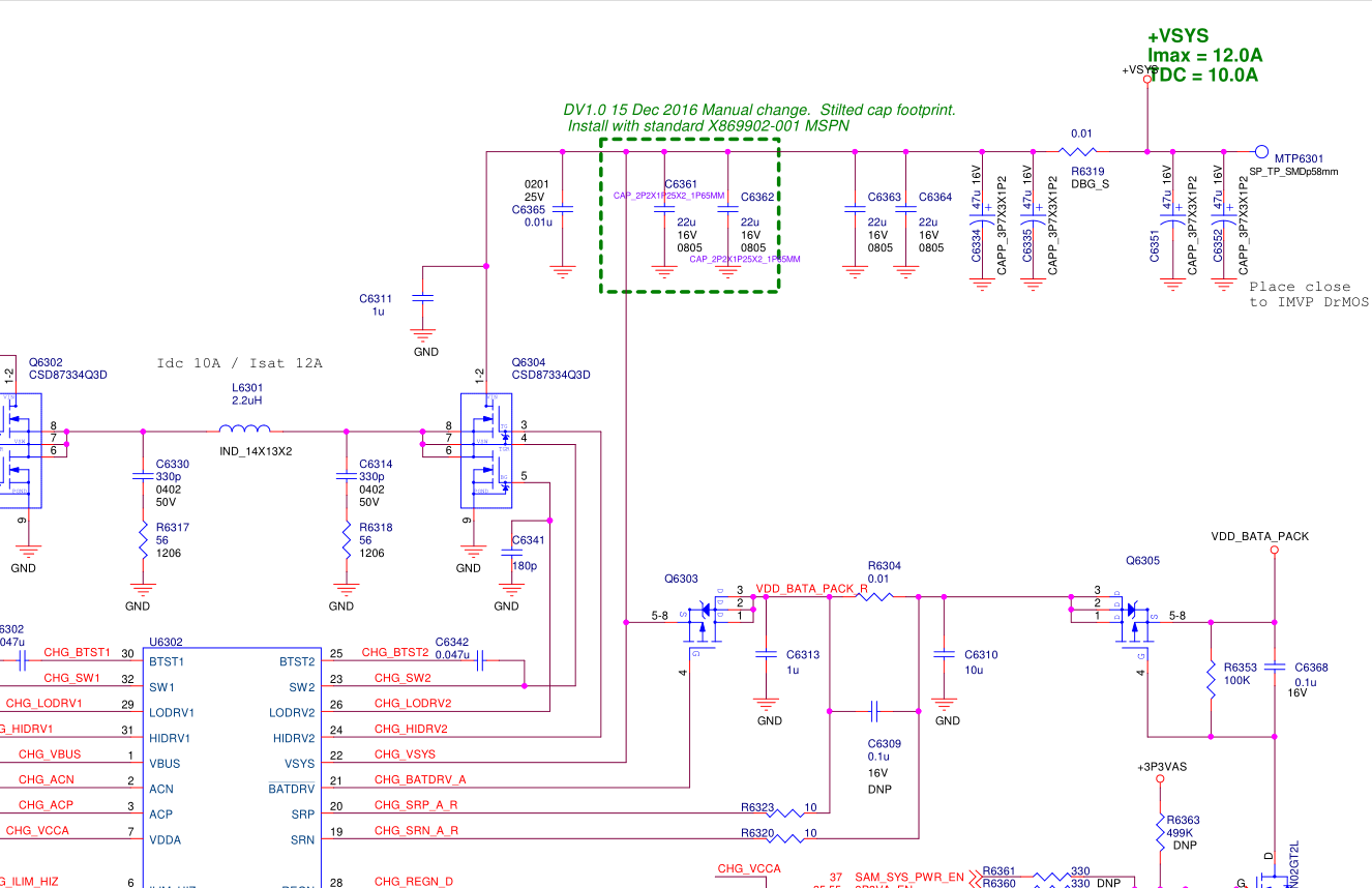

                                      Originally posted by ReeceyBurger123
                                      Inject voltage see what gets warm. I've had a bad MLCC in the mix of the cpu caps on the pro 5 ��
                                      I took a chance and injected onto VSYS rail and this FET (CSD87334Q3D) heated up, after removal short to ground on VSYS is resolved.
                                      Now VSYS powers the VCORE rail... not sure if the PCH is toast as a result of the failed FET or if it somehow was protected.
                                      VCORE is open, probably because VSYS is awol
