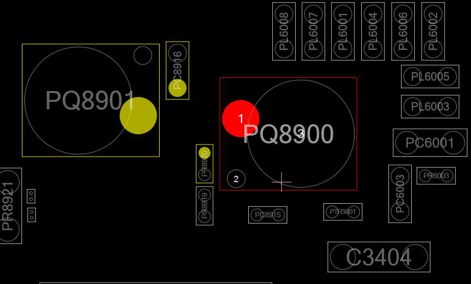

    working on a ASUS ROG STRIX GL702VSK 60NB0DZ0-MB1260 that does not power on. At the PQ8900 PIN2 (P_CHG_ACMOS_G_20) I am receiving 24.7V and PIN1 (P_CHG_ACMOS_S_20) 20V, however when I place the PQ8901 P_CHG_ACMOS_G_20 it drops 0V. I don't have the replacement mosfets ( N-MOSFET QM3058M6AC PRPAK5*6
    UBIQ) however will any N-channel mosfet with similar parameters work ? I also found that PCI8703, PCI8701 are shorted. any help would be grateful.​

      PQ8901 - N-MOSFET QM3058M6AC PRPAK5*6
      UBIQ
      PQ8900 - N-MOSFET QM3058M6AC PRPAK5*6
      UBIQ​
      Don't have the exact n-channel mosfet but I do have AON6382

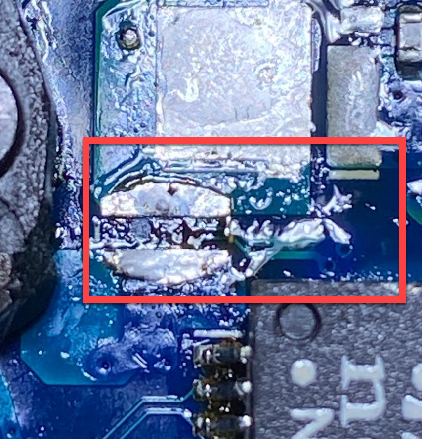

                    Was this resistor removed or reworked?
                    • ub6ib969
                      • Jul 2010
                      • 201
                      reworked.
                      • mon2
                        • Dec 2019
                        • 14659
                        Flux and remove that solder blob at the end. I do not believe it should be there and most likely is causing your short condition. Even better to flux and remove this part to confirm how the pads should be soldered back onto the board. This current sense resistor is just before the use of the main power rail. If this is shorted, this will cause your adapter voltage to tank like you are observing.

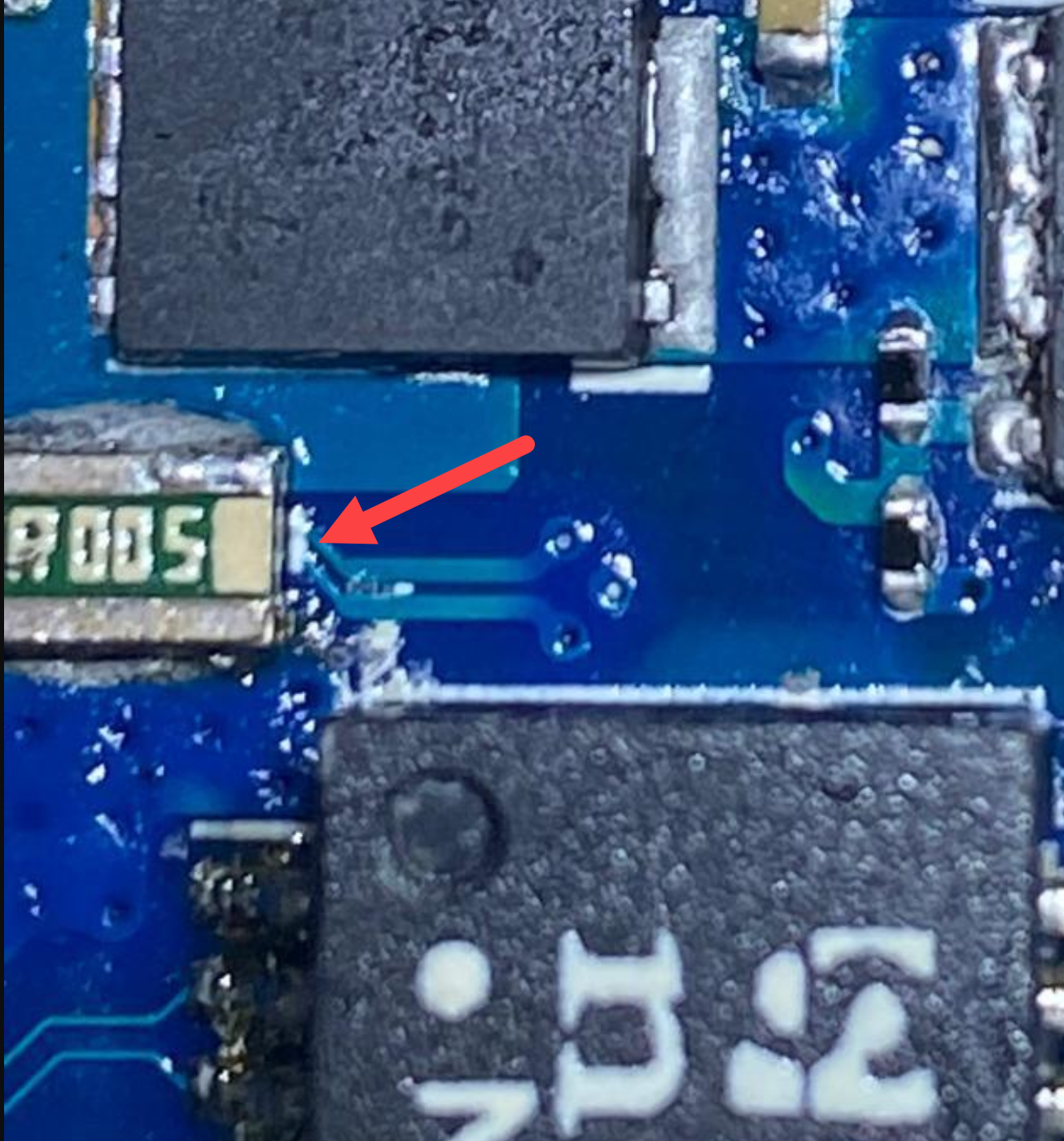

                                    Clean up the current sense resistor target PCB pads with flux and desolder braid. You should have only 2 bars with pre-tinned solder to match the current sense resistor. Like an 'oreo sandwich'. The end edges cannot be shorting like the earlier picture. If they do, the current sense resistor is bridged and the charger IC is unable to gauge the current draw of the power rail.
