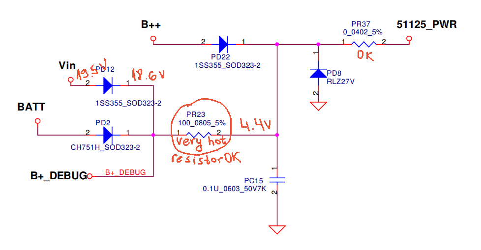

    The laptop won't start. When plug power supply, on 19V in gives me 0,14A, without turning on the laptop.
    I check it with thermal camera, and there is one resistor that is very hot, I change the resistor with new on but the result is the same.
    In the attachment there is schematic of the resistor area, and schematic of the laptop.
    I can't understand, why this resistor is getting so hot.

    Remove all power. Meter in resistance mode. Measure the resistance to ground on the side at ~4v4. Post the measurement.

        Flux and lift up one leg of diode PD22.
        Power up again and check if this resistor is still getting hot.
        What is the voltage to ground now on each side of this resistor?

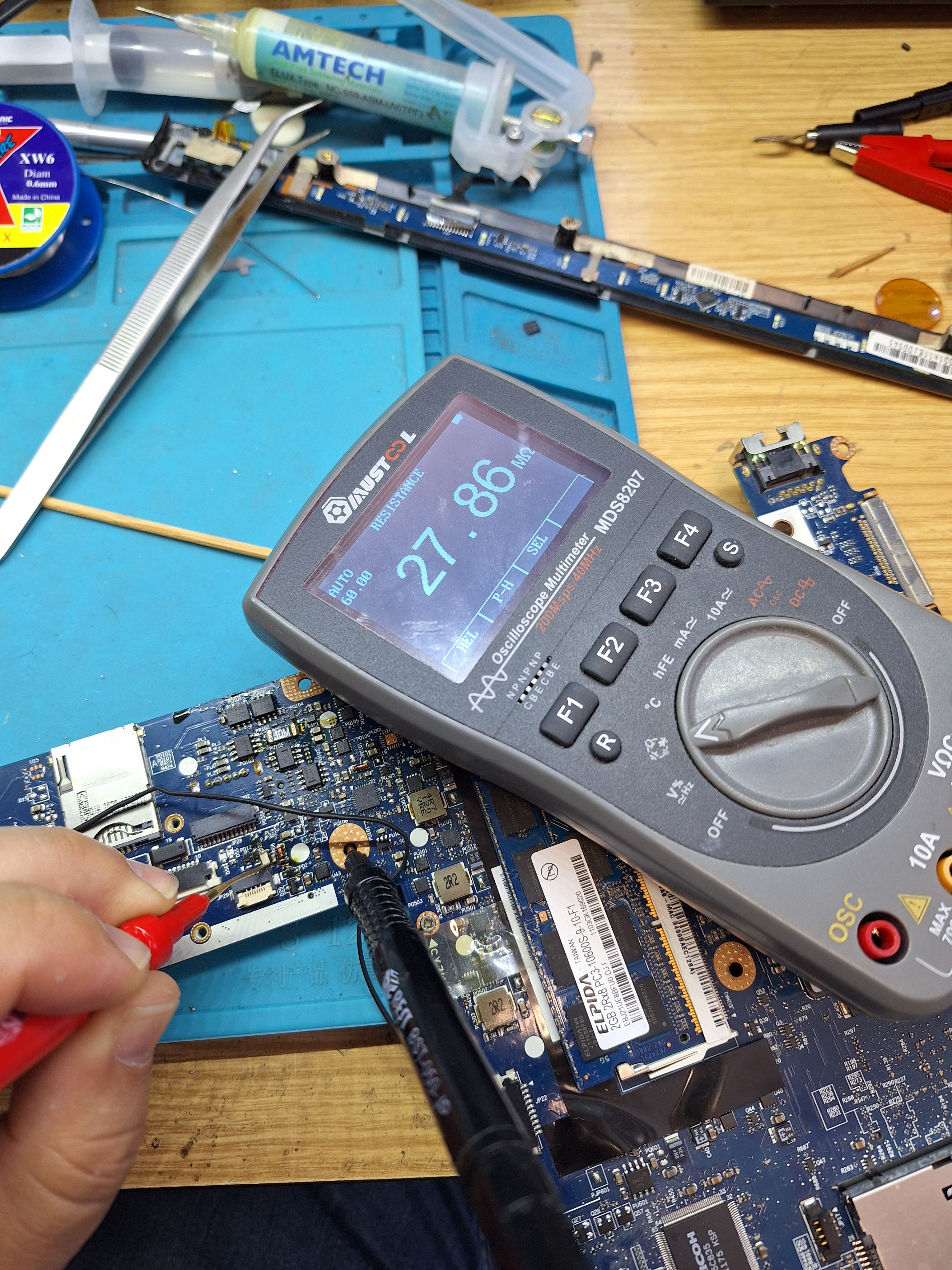

              Then the earlier resistance check to ground was in error. Measure the resistance to ground again after this 100 ohm resistor and post a pic of your meter face with the measurement. This resistor will only be hot if there is a heavy load on the downstream side.

                This is after 100ohm resistor to ground now, without TPS51125RGER.

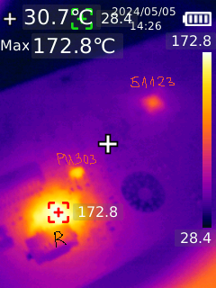

                  I found TPS51123 on one of my old motherboards, and I put it instead of old one TPS51125 /that was on the board originally/. The result is the same, this resistor is still very hot.
                  • smaniak
                    • Nov 2017
                    • 80
                    • Bulgaria
                    This is from the thermal camera.
                    The hotest one is the resistor.
                    The other one near to resistor is PU303 - APL5317.
                    And the far right is TPS51123​

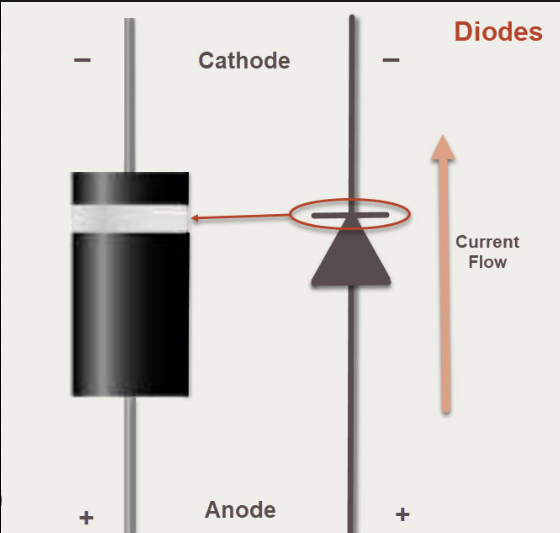

                        PD22 is a diode so has a polarity. In the post with the meter, unable to confirm that this diode is properly mounted. Be sure that the band on the diode is in the proper direction.
                        The backside of the arrowhead = ANODE = "+' or input to the diode. Respectively, the front side of the arrowhead = CATHODE = "-". The current will flow in the direction of the arrowhead and must match the schematic.
                        Confirm this important detail.
