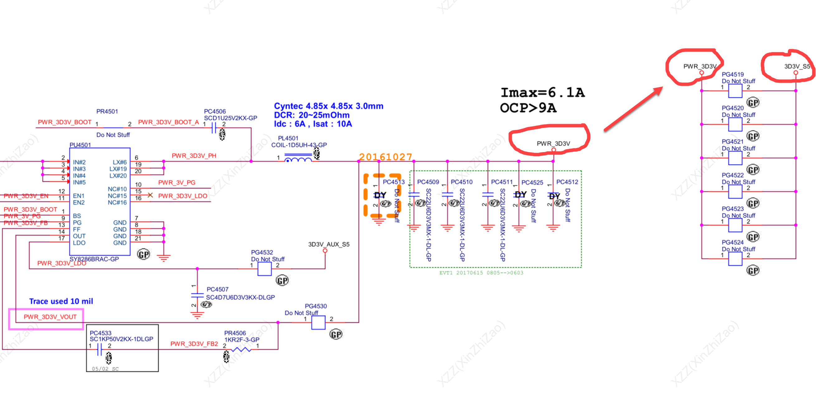

Main rail / charging circuit issues on Bucky/BenSolo 17859-1 board from Dell Vostro 5581

    Remove all power. Meter in resistance mode. Measure the resistance (not diode mode) to ground of 3D3V_S5.
    4.7 ohm.....
    • mon2
      • Dec 2019
      • 14726
      Ouch. Someone is shorted here and hope it is not the PCH. This is a critical rail that travels all over the PCB.
      Would you have an adjustable power supply that can dial up 1 volt?

        I certainly do - are we suggesting voltage injection?
        • mon2
          • Dec 2019
          • 14726
          Great. Dial it up to 1 volt - not higher; 3-5A and inject it onto this same line that is shorted. Review who is heating up with this injection. Checking where this rail is created now...but it should not really matter for the injection. The component with the 4R7 short will heat up. Do monitor the CPU / PCH which also uses this rail.

            Its here i believe

              Perhaps not - That takes in 3D3V_S5 and spits out 3D3V_S0
              • mon2
                • Dec 2019
                • 14726
                Inject at PL4501 is convenient. The rail is created here by PU4501.

                  Ok I will try that (I have thermal camera also)

                    #29
                    Its only pulling 256ma (at 1V / 3A) so not enough to show anything
                    • mon2
                      • Dec 2019
                      • 14726
                      #30
                      Measure the resistance to ground at PL4501​. Still see 4R7 there?

                        #31
                        Yeah, same resistance at that coil.
                        Tried on back of board and the only thing that warms up is...... U2401

                          #32
                          No worries, thank you very much for your help with this - very insightful.
                          I have another identical board that is missing some mosfets (it had blown PU4403) and the ISL chip was also removed (I just checked that board and has no short on that 3V3 line).
                          I will transplant those components from this board and see if that one will work (and report back if so). (I also have another whole laptop coming with hinge damage I can use also).
                          Cheers, Ben
                          • mon2
                            • Dec 2019
                            • 14726
                            #33
                            That is the EC. You can consider to increase the voltage for the injection slightly and confirm that indeed U2401 is the one who is heating up. If yes, then this component is most likely defective. Do inspect for nearby caps that may be shorted.
