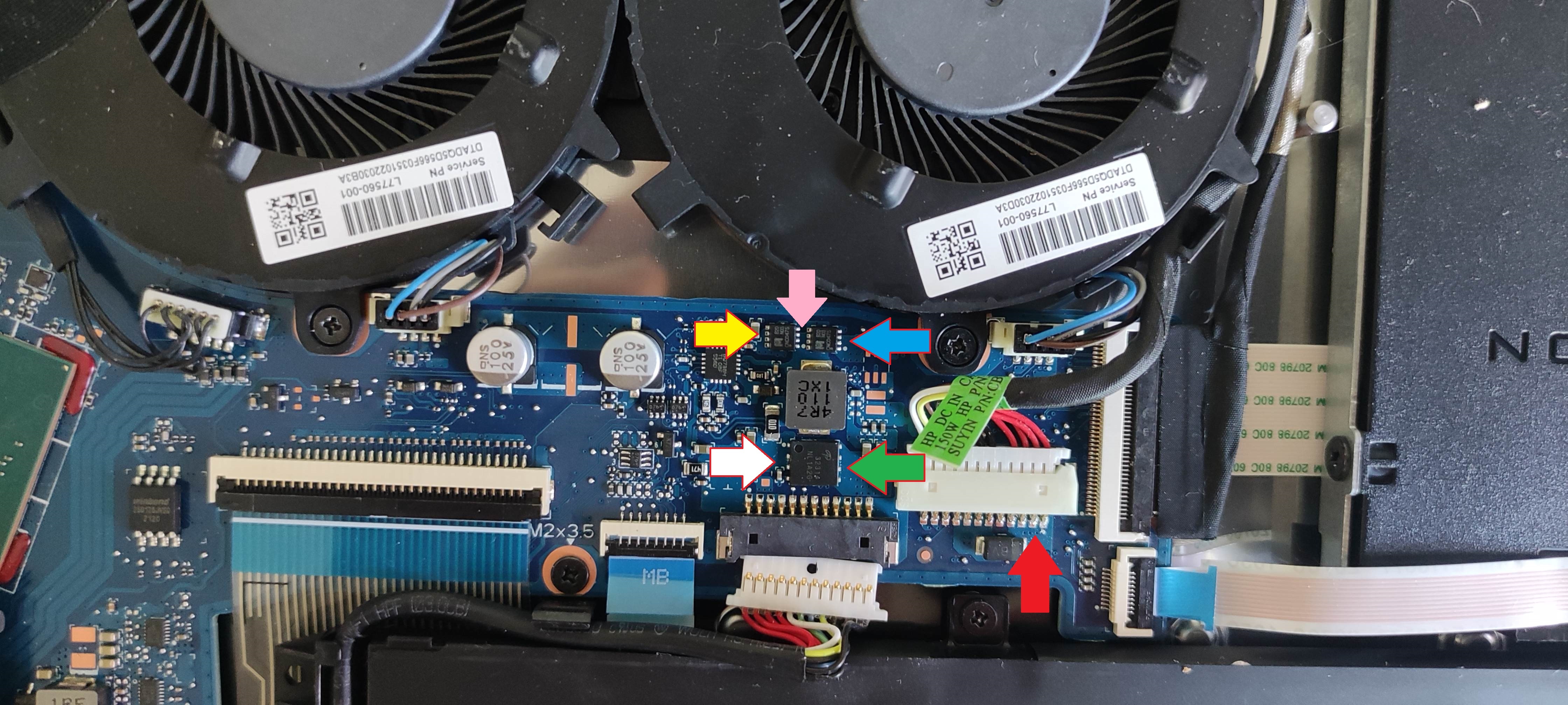

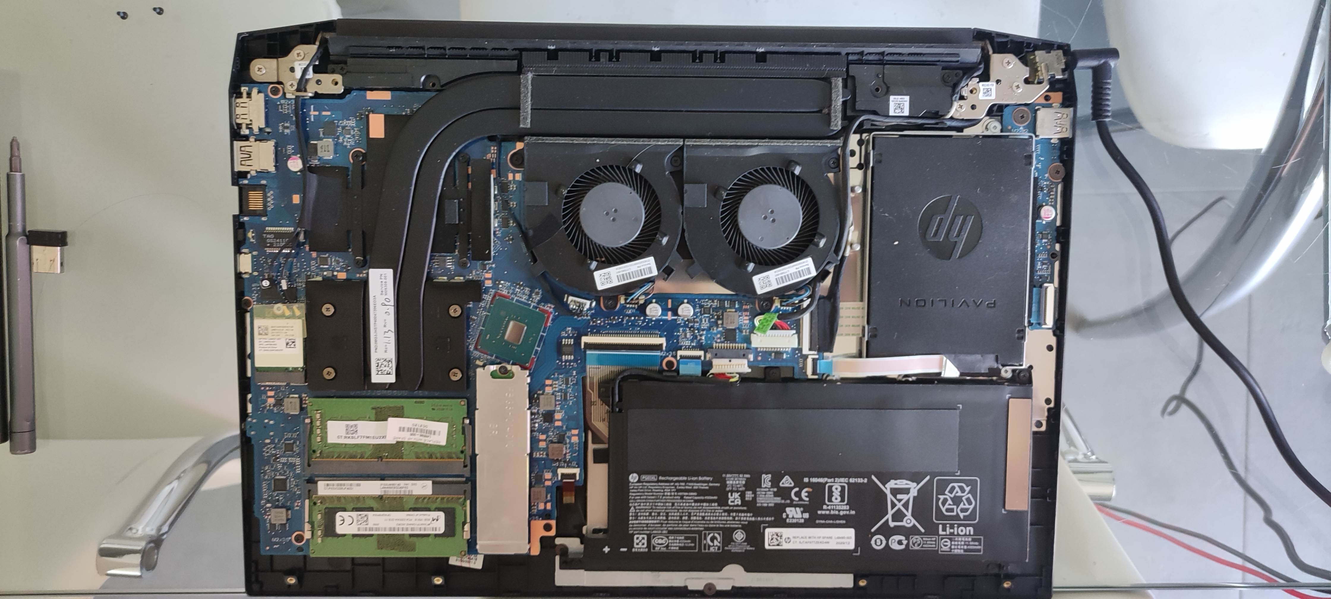

    I have this dead laptop, if I plug the charger I see only charging led light blinking 3 times.
    I disassembled it, removed the battery and checked with my multimeter:
    red arrow input connector 19v
    green arrow first mosfet drain 19v
    white arrow first mosfet source 3v
    yellow arrow second mosfet 19v
    pink arrow 3v
    blue arrow third mosfet shorted to ground
    current resistor 3 volts on both sides
    Any advice? I have a thermal camera and I could inject low voltage if needed.
    Thanks in advance
