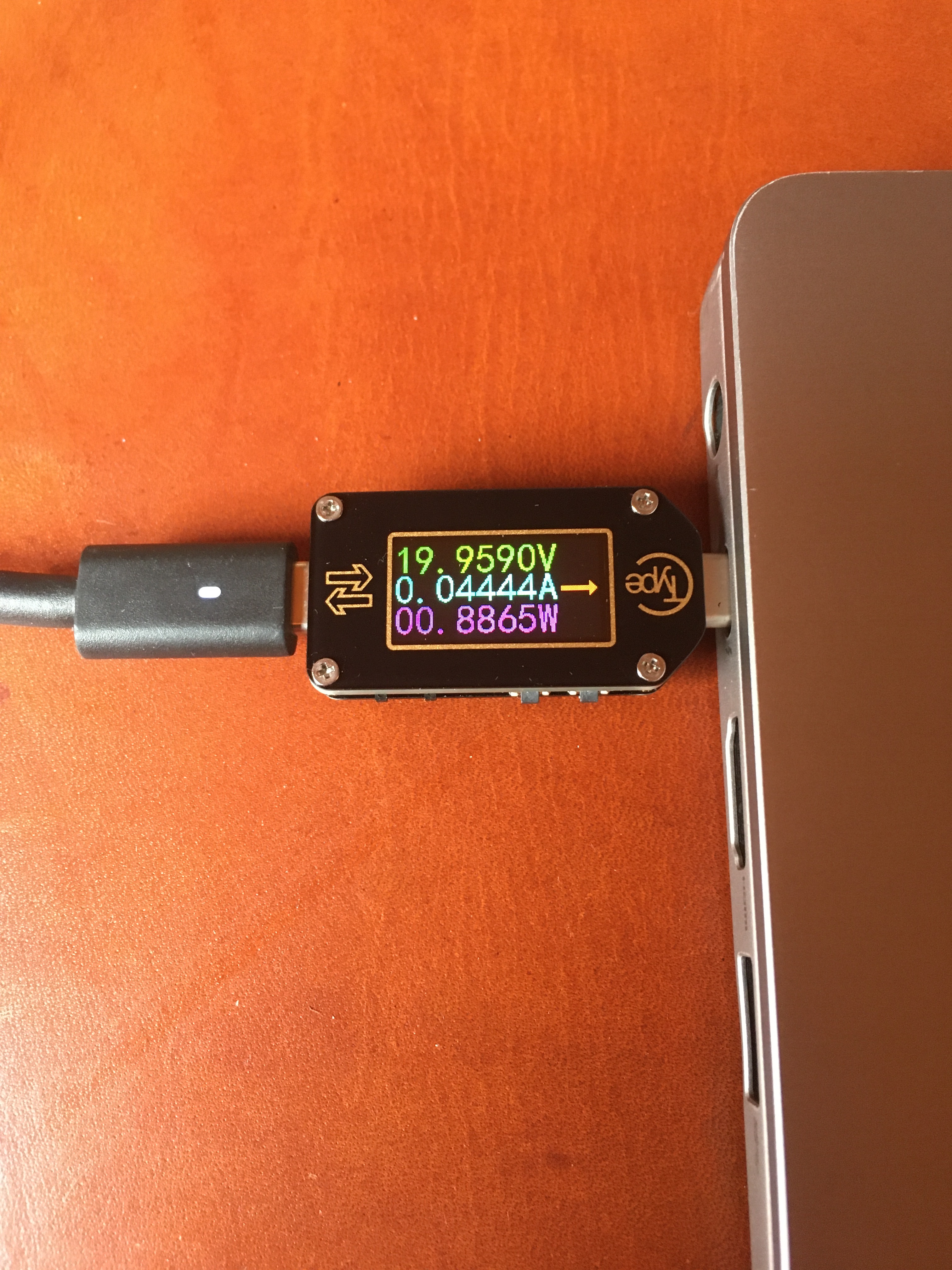

    Hello, maybe someone can help me.
    The following problem with a Dell Latitude 7400 notebook.
    ServiceTag: C5RBL13 Board number: LA-G871P Rev:1.0 (A00)
    It doesn't start and when I read the voltage on the USB-C port, it fluctuates around 0.8 watts.

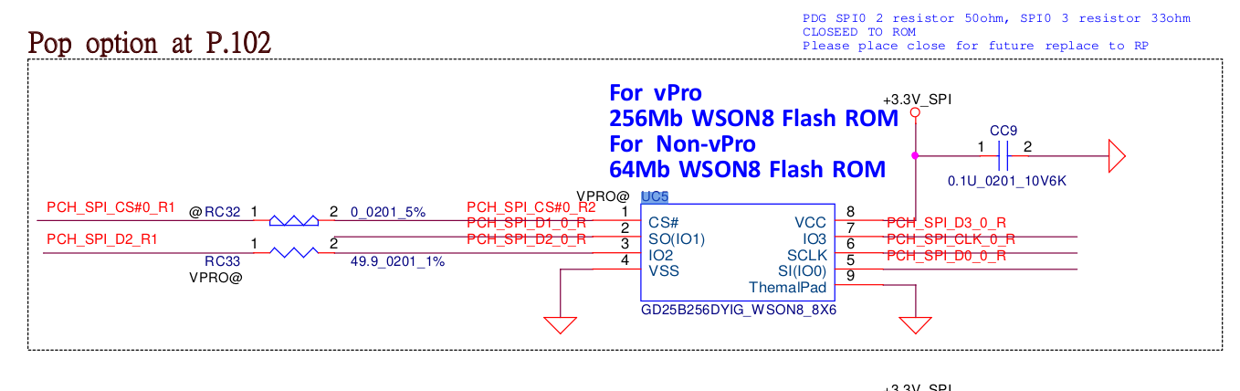

    I measure it on the BIOS chip pin 8. It should be 3,3 volts.
    There are 3,3 volts but I can only measure 0.2 volts. (+3.3V_SPI)
    Is this the possibility that the PCH has a short circuit.
    Schematic - https://www.badcaps.net/forum/troubl...56#post1587856

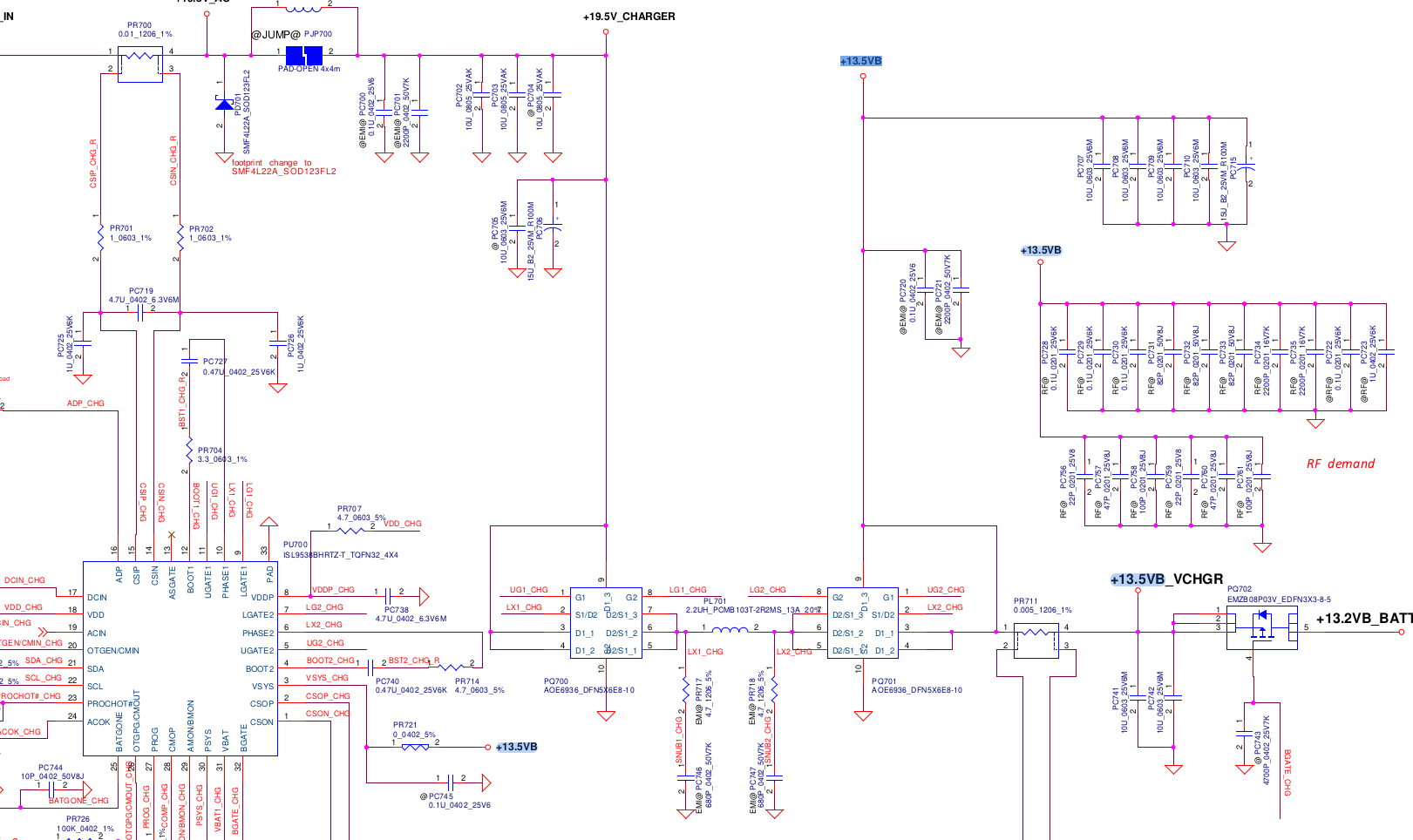

    Review the voltage to ground of:
    DCIN_CHG (pin 17 on PU700)
    ADP (pin 16 on PU700)
    ACOK (pin 24 on PU700)
    PBAT_CHARGER_SMBDAT (pin 21 on PU700)
    PBAT_CHARGER_SMBCLK (pin 22 on PU700)

      • mon2
        • Dec 2019
        • 13995
        Remove all power. Meter in resistance mode (not diode mode).
        Measure the resistance to ground of:
        +13.5VB - this is the main power rail for the logic board. Checking for a shorted component with the resistance check.
        +3.3V_ALW ; this rail is OFF as it can be observed with the ACOK / SMBDAT / SMBCLK lines being parked to a logic low - they need this rail to supply the pull-up voltage
        +5V_ALW
        The above rails will enable provided there is no short on each of the lines. Post each measurement.

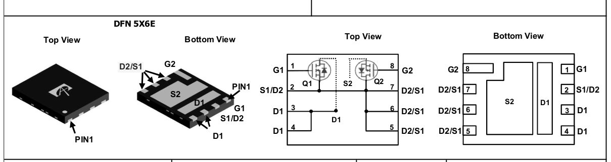

            Hello, I have +19.5V to PQ700 - AOE6936 then nothing, maybe 0.2V. I've already replaced the PQ700 Mosfet, no change.
            • Markus1741
              • Sep 2020
              • 843
              • N/A
              Measure the resistance across the following DCin mosfet pins of PQ700:
              D2/S1 = 53,1 k Ohm
              D1 = 143 k Ohm
              G2 = 10,7 M Ohm
              G1+S1/D1 = 146 k Ohm
