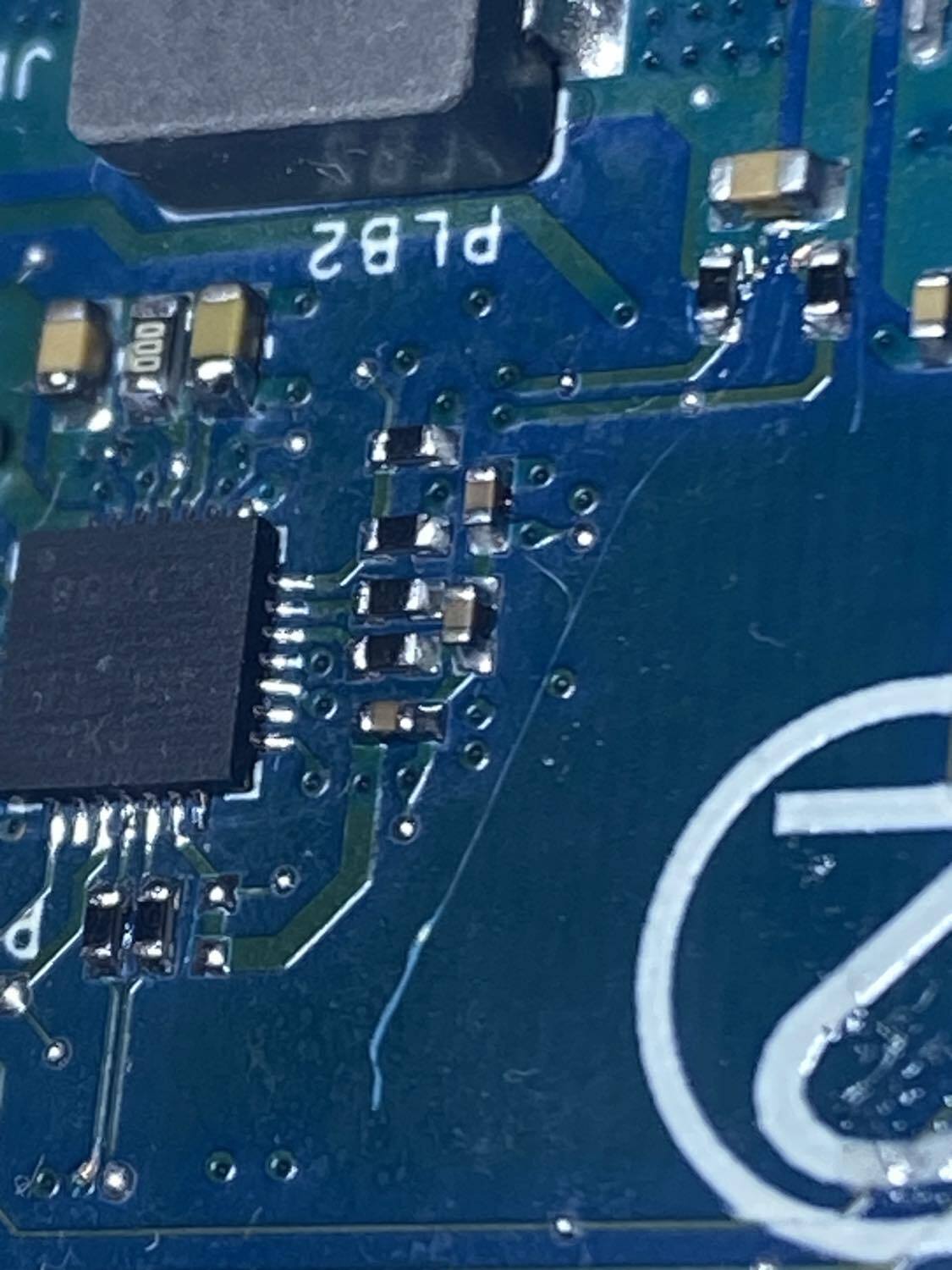

                        The mosfet readings are good and the mosfet is not shorted. High resistance readings = not a leaky mosfet.

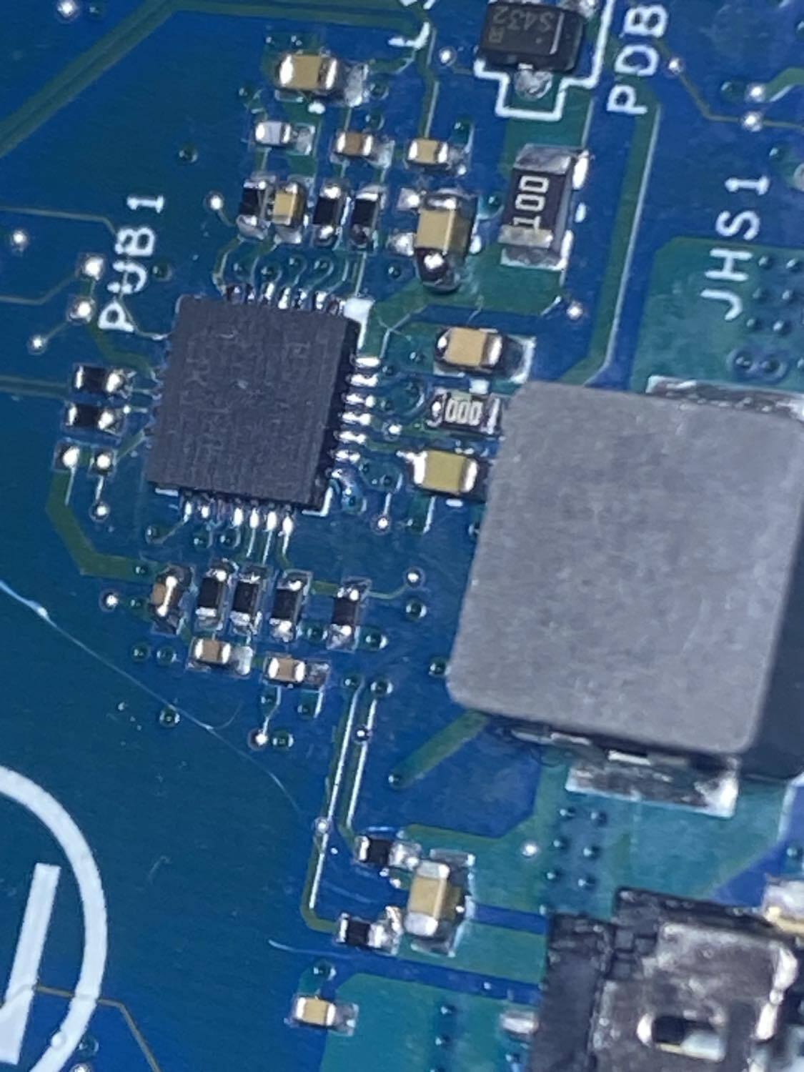

                        1) Share a close up pic of the reworked battery charger IC for a review.
                        2) The charger IC will enable the DCin power path provided a number of conditions are met. Respectively, it is possible that the DCin power path is enabled but quickly shutdown due to an excessive current draw event. Then this shutdown event will be missed by the time the signals are monitored.
                        3) Can you link the exact schematic you are using? I may be out of sync with my schematic and want to be on the same page.

                          I use the diagram that I attached on the first page (LA-J871P).
                          It seems as you say that this resembles excessive consumption when the battery is connected, so the bq24 goes into safety mode and no longer gives the signal, but where can this consumption come from?
                          for welds I always check under the microscope that everything is well connected​
                          • mon2
                            • Dec 2019
                            • 14631

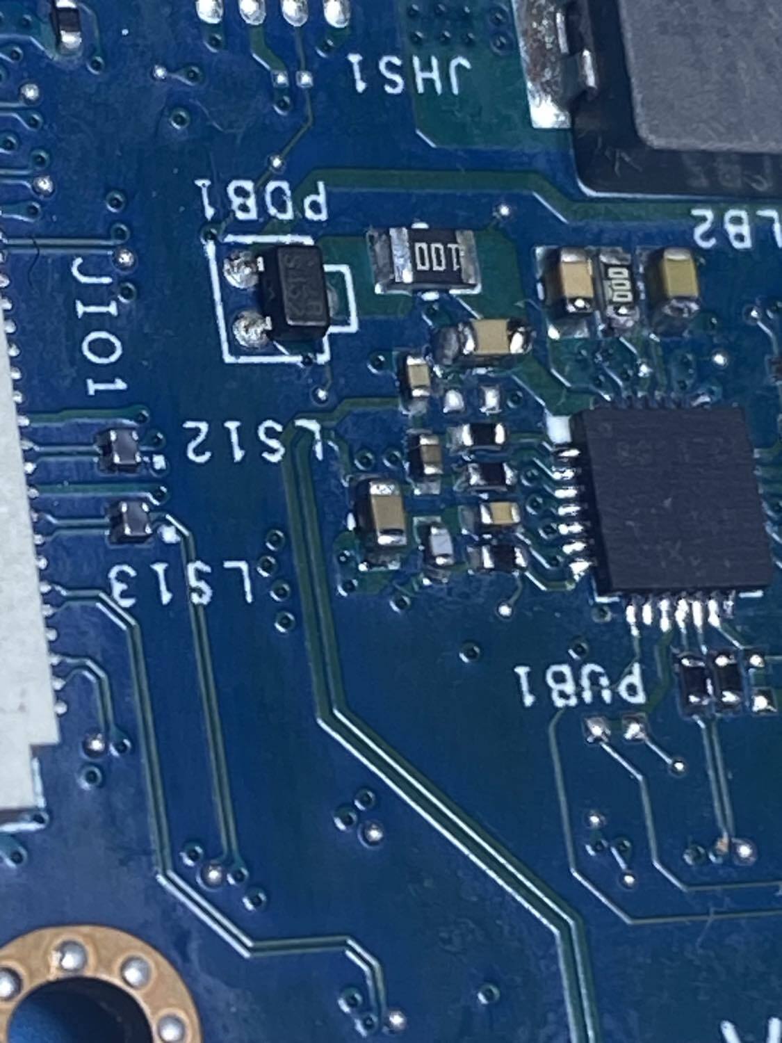

                            Soldering looks very clean to me. We have the same schematics.

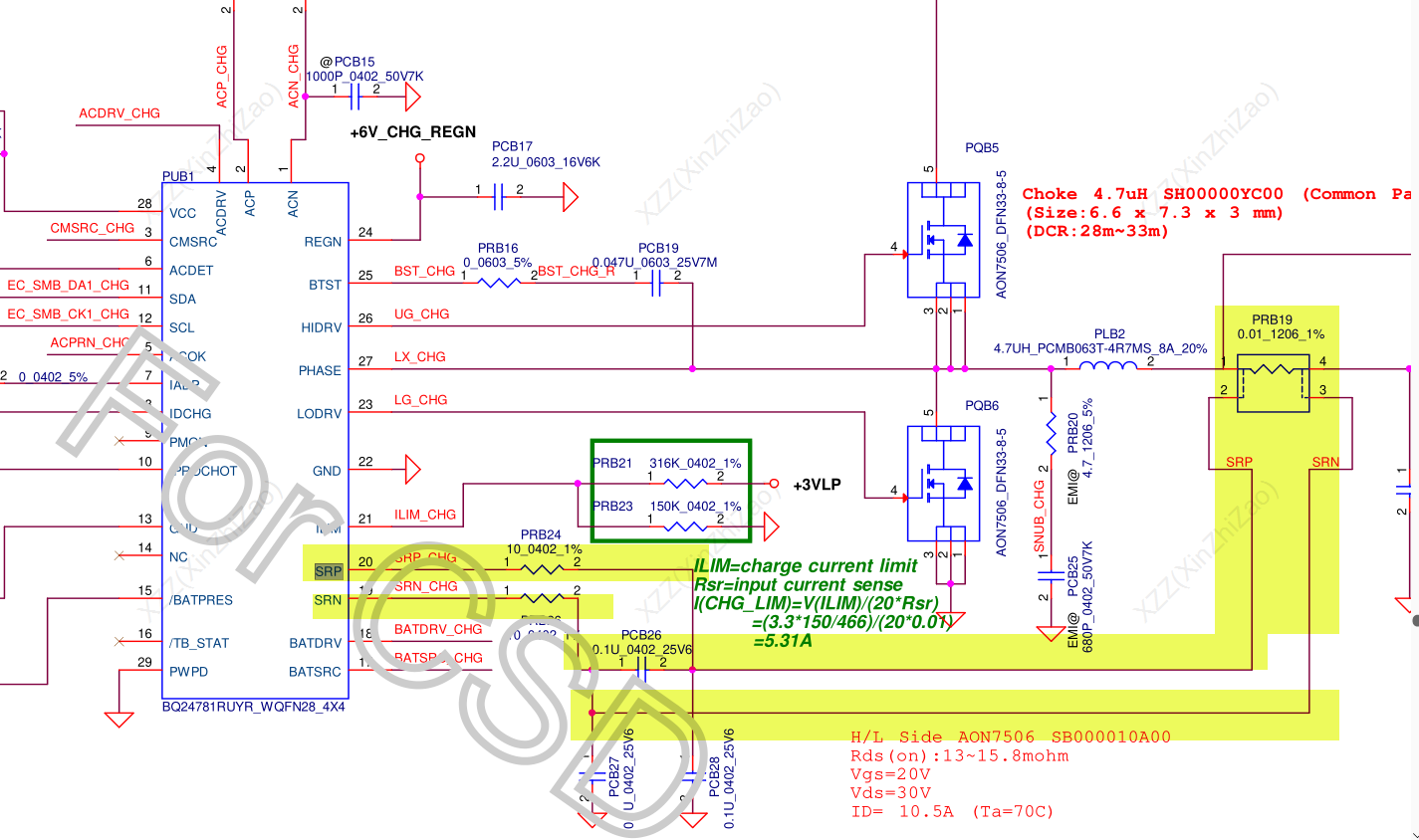

                            Remove all power. Meter in the lowest resistance scale. Measure directly on the charger IC - the resistance between pins 19 & 20. One meter probe on pin # 19; other on pin # 20. You are measuring the current sense path resistance and need to compare this measurement against the schematic. If it is different, the fault is here. Last year, we invested 3 weeks in another case in the forum and the fault was here.
                            You are checking the SRP / SRN path resistance which is used by the battery charge circuit.

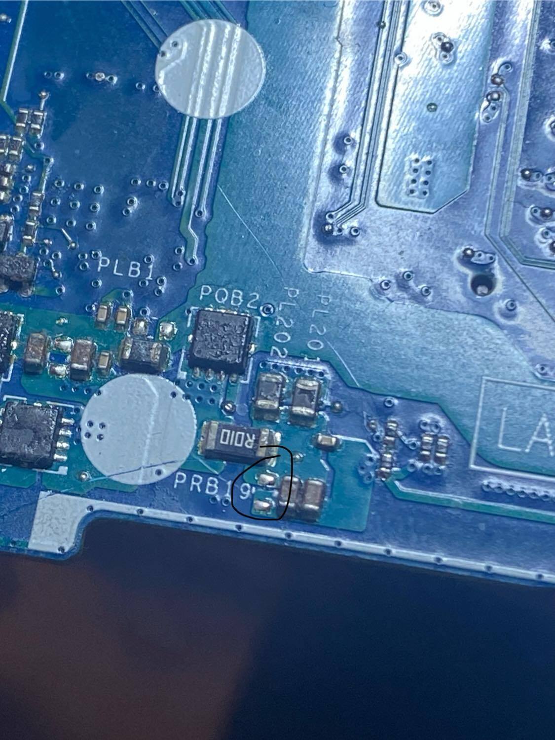

                              broches 19 et 20 : 20,2OHMS (résistance PRB26 and PRB24 are good 10HOMS)
                              résistance PRB19 is good 0HOM
                              on the other hand I don't have the PCB24 component, is this normal or is it a missing capacitor?

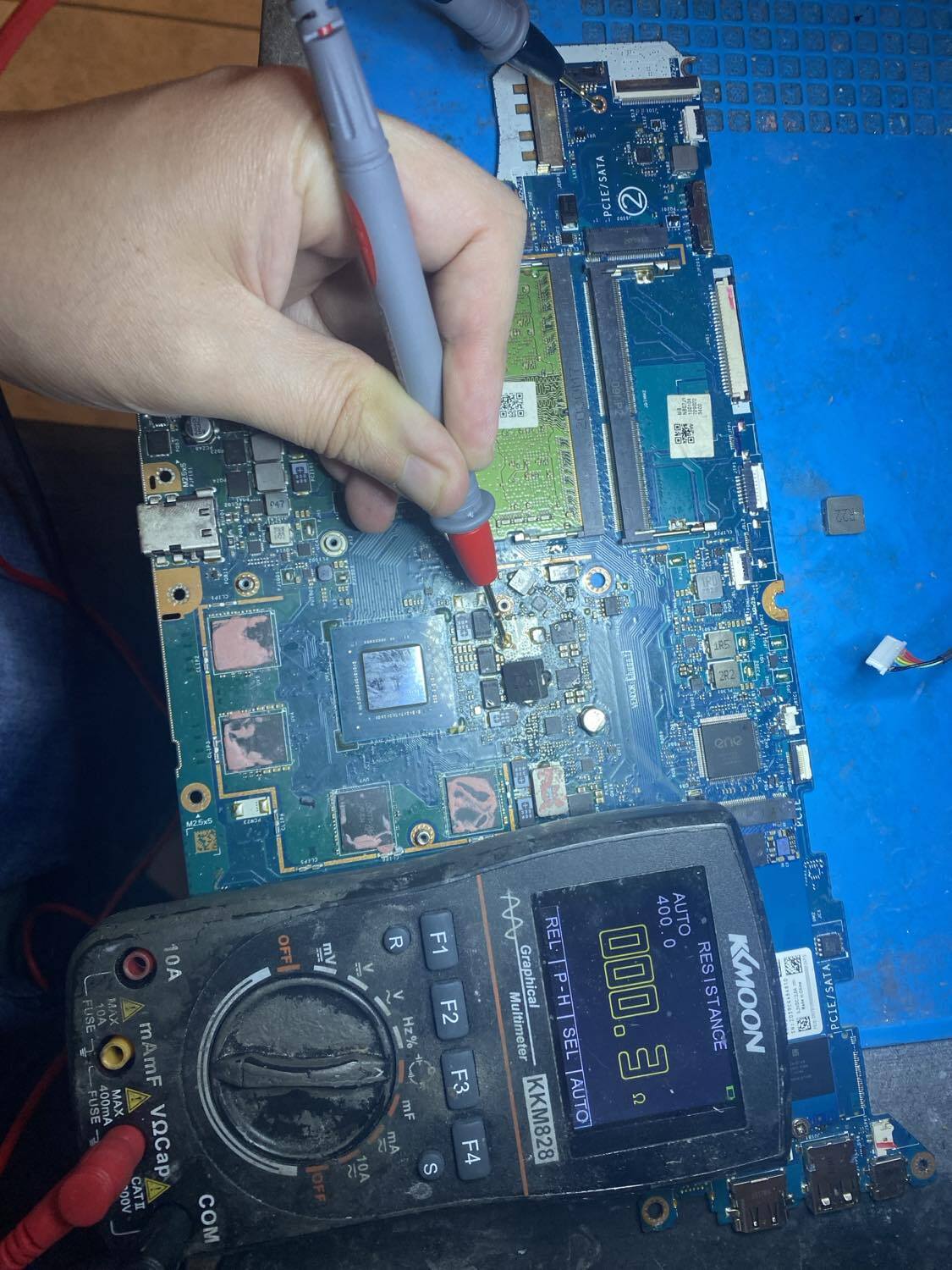

                                Originally this laptop came with a short circuit on the PCZ70 capacitor, two weeks later it was short circuited again so I had to change it twice, maybe the overconsumption comes from there?
                                The GPU has very low resistance, is it normal to have only 0.3 ohms on the GPU? I disconnected the coils but the result remains the same when I connect the battery the mosfets are no longer closed

                                  Resistance to GND as low as 0.1 Ohms is very very likely fine on gaming laptop's GPU.
