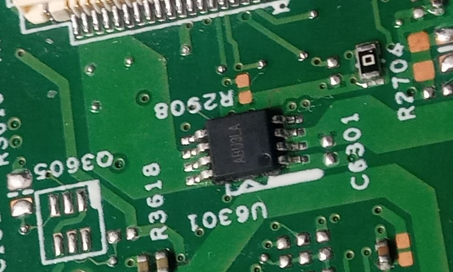

Help, has anyone identified this IC component ABU3LA (position u6301) ? in lenovo
  • valente222
    • Feb 2021
    • 91
    • PERU
    Click image for larger version  Name:	photo1712421644.jpg Views:	13 Size:	155.6 KB ID:	3248512Be reviewing this laptop without any schematic not available. LS41P MB 12293-1. the 5v and 3v sources of the TPS51225C IC, one of the inductors is shorted 1.2ohm PL4502 (could be the 5v alw), and several of those ICs go to USB. What manufacturers will they be? , I'm looking for equivalents. of the ABU3LA ic (position u6301)
  • mon2
    • Dec 2019
    • 14415
    SY6288CCAC
