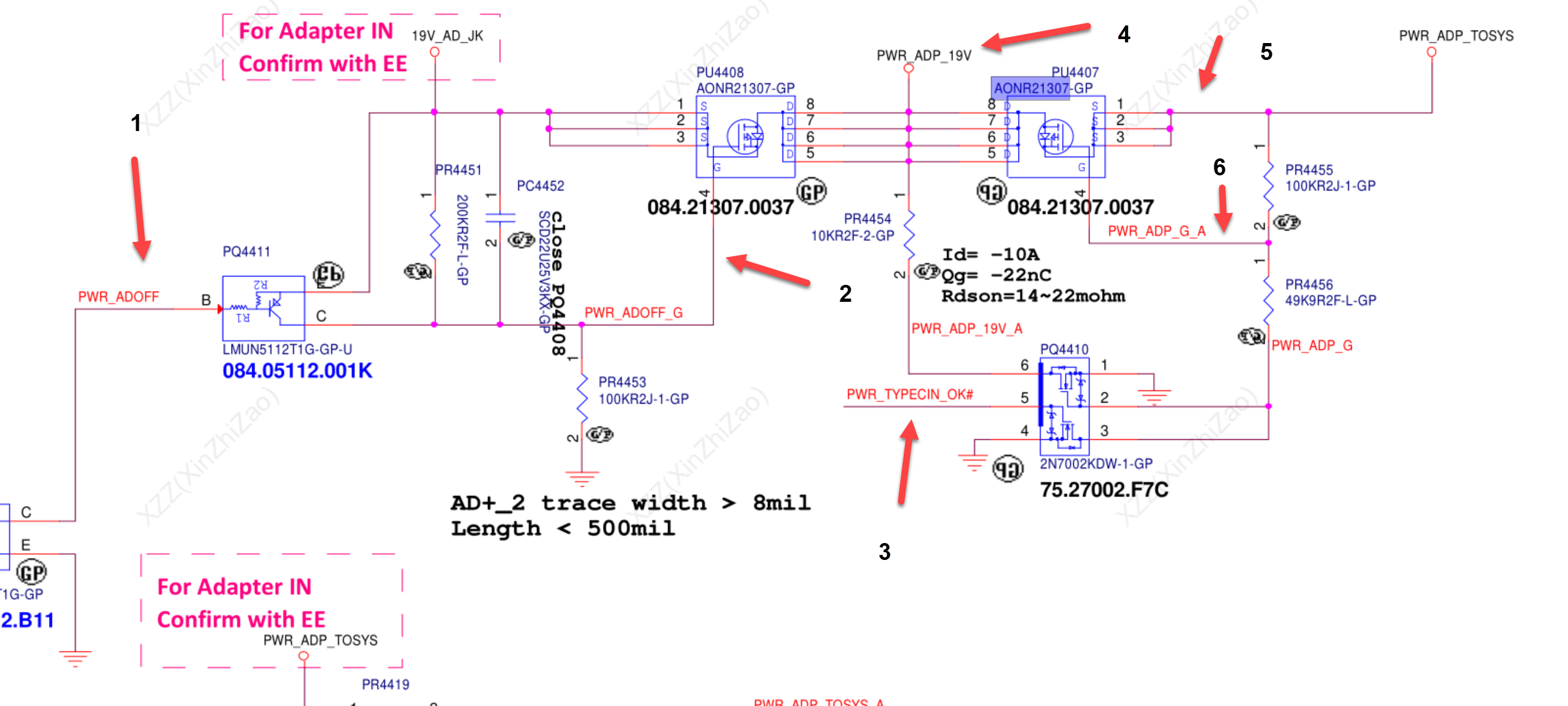

    Lenovo Flex 5 14ARE06 unit does not power on. When usb-c is attached U7204 (TPS66021YBGR-GP) gets very hot. I replaced it and still gets very hot. Unit is getting 20V and 0.228amps. when checking around I noticed that PC1051 & PC1052 are shorted (1V_VDDCR_SOC) does this mean that the APU1 is shorted ? or am i missing something? any help would be great.

        i also noticed that PU4408 mosfet is receiving 20v however I am not getting anything at PU4407. This unit also have a dc jack. ​

          Meter in DC volts (20 volts or higher is ok). Carefully measure the voltage to ground of the attached 6 points of interest. Red meter probe on point to test; black meter probe to ground.

            update
            • when i remove PU4408 i get 19V_AD_JK =20V and PWR_ADOFF_G= 6.7V however once I replace back on board goes to 19V_AD_JK is 1.0V.
            • with PU4408 on board and PU4407 remove 19V_AD_JK =20V and PWR_ADOFF_G return.
            • if both mosfets on board 1.0V and I can see both mosfets pulsing.

              Not what was asked in post #5 but let us continue.
              Remove all power. Meter in resistance mode.
              Measure the resistance across these same mosfets:
              source (1-2-3) & drain (5-6-7-8)
              source (1-2-3) & gate (4)
              gate (4) & drain (5-6-7-8)
              Check the above for PU4408 and PU4407.
              Post each measurement. Checking for a low resistance to determine if the mosfet is leaky or not.

                here are the measurements, and thanks again.
                PU4408
                source (1-2-3) & drain (5-6-7-8) = 0.498V
                source (1-2-3) & Gate 6 = .OL
                gate 4 & drain (5-6-7-8) = .OL
                PU4407
                source (1-2-3) & drain (5-6-7-8) = 0.460V
                source (1-2-3) & gate (4) = .OL
                gate (4) & drain (5-6-7-8) = .OL
                just a note when plugged in via dc jack PU4408 starts pulsing,

                  These are diode mode readings not resistance. On your meter you should have a resistance scale (omega symbol) and perhaps some scales. Post a front side pic of your meter to confirm. Proceed to use the resistance scales (not diode mode) for these checks. If you see 'OL' while in the resistance mode, then select a higher resistance scale.
                  A good mosfet that is not defective should have a high resistance reading.

                    thank you for the lesson mon2 and below are the correct measurements
                    PU4408 2M measurement
                    source (1-2-3) & drain (5-6-7-8) = 0.695 M
                    source (1-2-3) & Gate 6 = 0.671m-0.673m
                    gate 4 & drain (5-6-7-8) = 0.560m
                    PU4407
                    source (1-2-3) & drain (5-6-7-8) = 0.480M
                    source (1-2-3) & gate (4) = 0.100M
                    gate (4) & drain (5-6-7-8) = 0.480M
                    • mon2
                      • Dec 2019
                      • 14190
                      PU4407 source / gate readings are low at 100kohms. Appears to be leaky.
                      Carefully, flux and remove this mosfet and then check the mosfet when it is on your workbench after it has cooled down.

                        PU4407 20M - removed
                        source (1-2-3) & gate (4) = 0.L
                        • mon2
                          • Dec 2019
                          • 14190
                          Are these measurements on the mosfet while it is on your workbench? Check the same resistance mode measurements on the mosfet pcb pads. No power during resistance / diode mode checks.
                          • ub6ib969
                            • Jul 2010
                            • 198
                            mosfet has been removed off the board and on bench.
                            diode mode
                            source (1-2-3) & drain (5-6-7-8) = 0.490v
                            source (1-2-3) & gate (4) = O.Lv
                            gate (4) & drain (5-6-7-8) = O.L.v

                              Can you post the model of your meter? The above table of values should be in ohms. Not clear if the meter is being used properly here.
                              • ub6ib969
                                • Jul 2010
                                • 198
                                using victor vc890C
                                my bad measured in diode mode previously.
                                mosfet removed and tested using 20M resistance
                                source (1-2-3) & drain (5-6-7-8) = 1.12M
                                gate (4) & drain (5-6-7-8) = 0.L
                                • mon2
                                  • Dec 2019
                                  • 14190
                                  These are good resistance measurements for source/drain.
                                  Can you confirm the scale used for the other measurements? (source / gate; gate / drain)
                                  • ub6ib969
                                    • Jul 2010
                                    • 198
                                    scale used was 20M ohm
                                    source (1-2-3) & gate (4) = 0.Lm
                                    m
                                    PWR_ADP_TOSYS found that c7203 is shorted after PR445. removed cap and still short.
