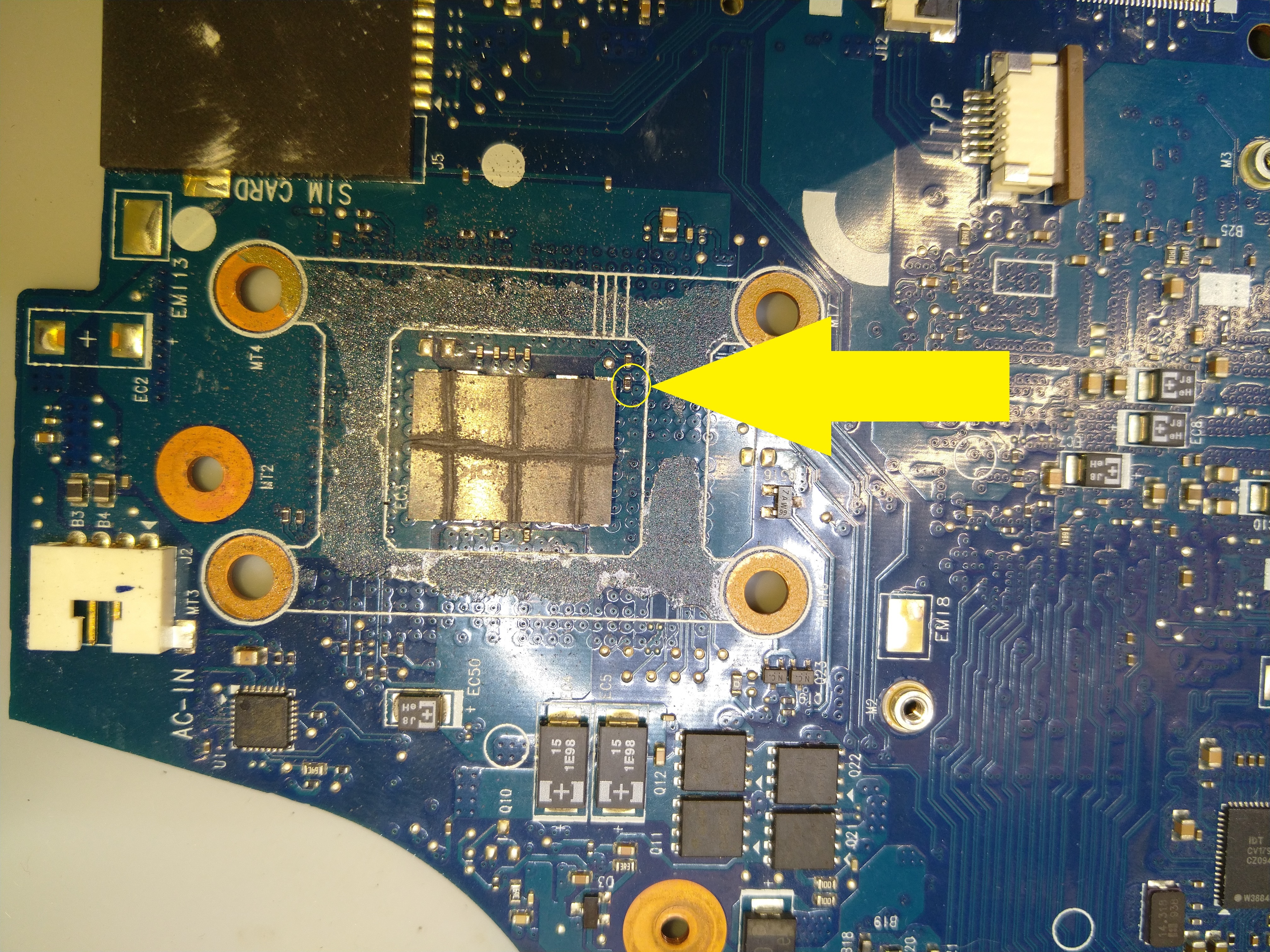

    Hello everyone. Do you know the value of this resistor? Or which resistor it is on the schematic, please?

      Seems like a NTC resistor. You can try 10K-100K value.

        Thanks. I actually saw a dual supply line to this cpu on the schematic. There is another resistor there of 56ohm, just next to it. All components there, were kinda mirrored around the Nec/Tokin, and schematic seemed to confirm it. I have already placed another 56ohm and all works.
        Thanks for your input.
