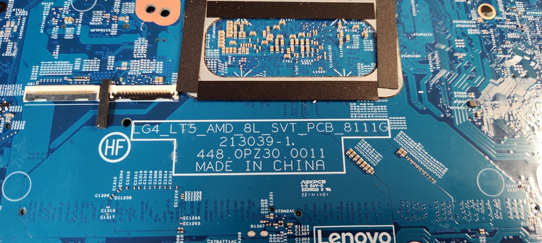

    Hi All,
    I tried two different power adapters.

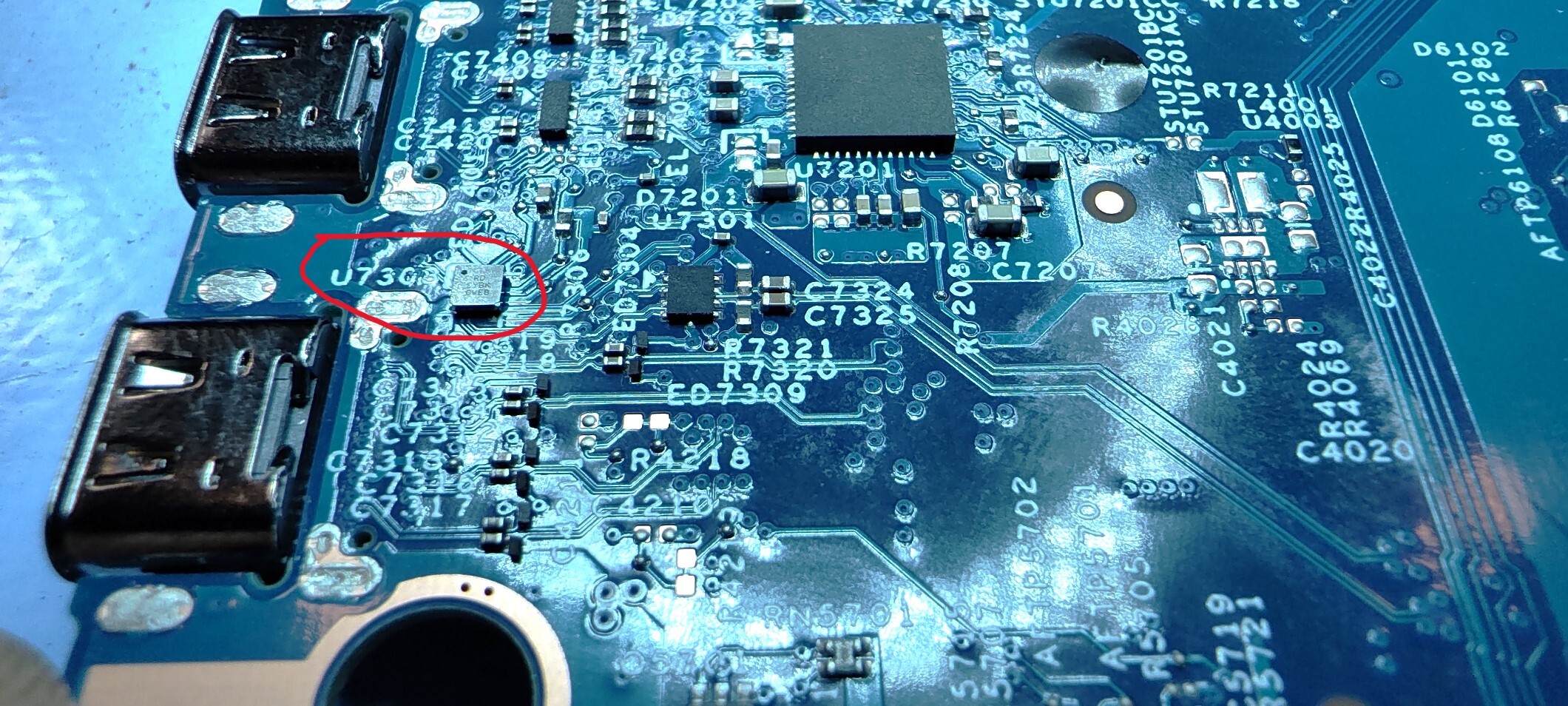

    On the lines that are marked as 20V on the boardview, I only have 5V. But there is no light that comes on at all when this think is plugged in.
    Customer stated that it just stopped charging and then when the battery died that was it.
    I have a suspicion that it could be U7303 which I believe controls the voltage setting for the adapter? Markings are RD LYBK CVEB
    Any help would be appreciated!

      How is this laptop powered? USB Type C power adapter? If yes, then there will be a usb power delivery controller in the power path to power this logic board. This PD controller must work with the power adapter to dial up the 20v power delivery contract to power the board and charge the battery.
      If you are stuck at 5 volts then the CCx (CC1 and CC2) lines used for this communication must be reviewed.
      Do test by flipping the power adapter connector by 180 degrees and test again. Any difference?
      Do you have a USB type c meter? What is the current draw? Is it a static value on the current draw?
      Remove all power, meter in diode mode. Red meter probe (yes, red) to ground. Black meter probe to CCx pin. What is the measurement?
      Next check the other CCx pin on the same connector. Post each measurement.

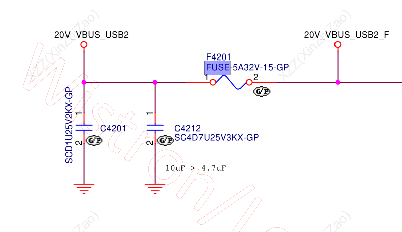

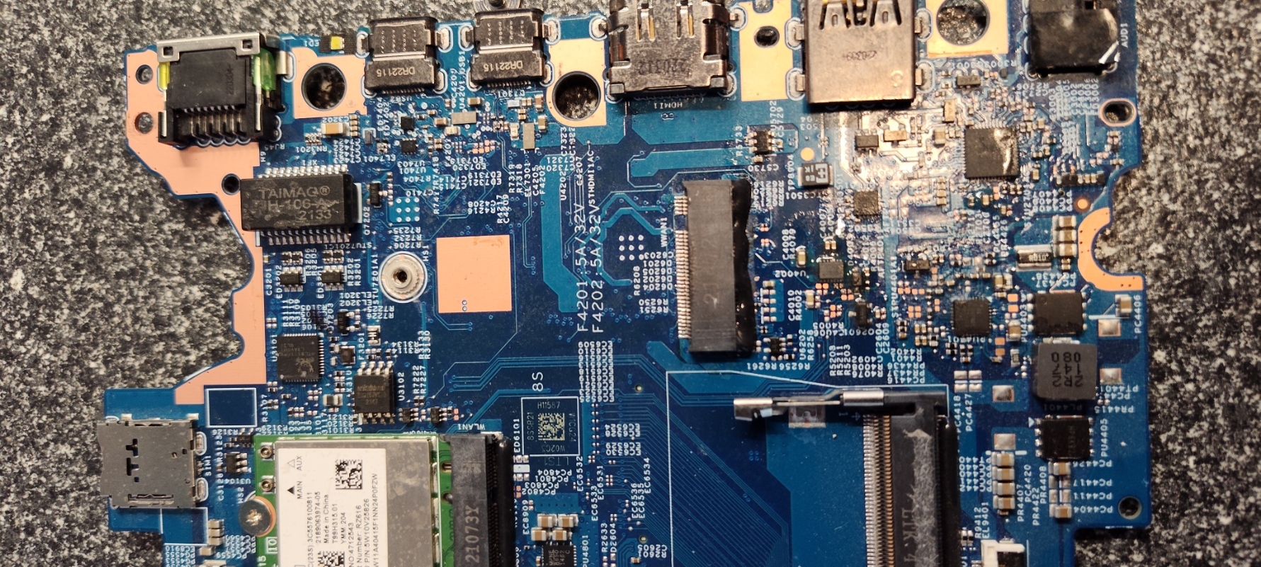

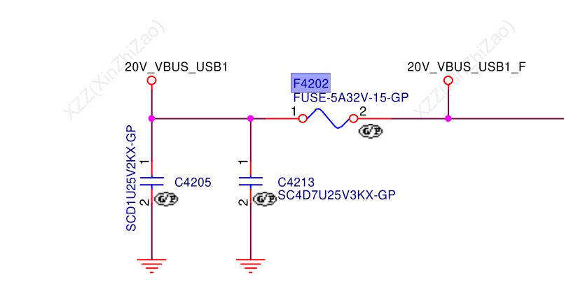

                You are drawing no current (0 amps). Voltage is the power on default on the external power adapter. For power delivery adapters such as yours, there must be a proper communication (handshake) between the logic board and the external power adapter over the single wire CC1 or CC2 line. One such contact exists on each side of the Type C connector so that you can rotate the head by 180 degrees and the adapter can still spit out the requested voltage / current paired power delivery contract to power the logic board.

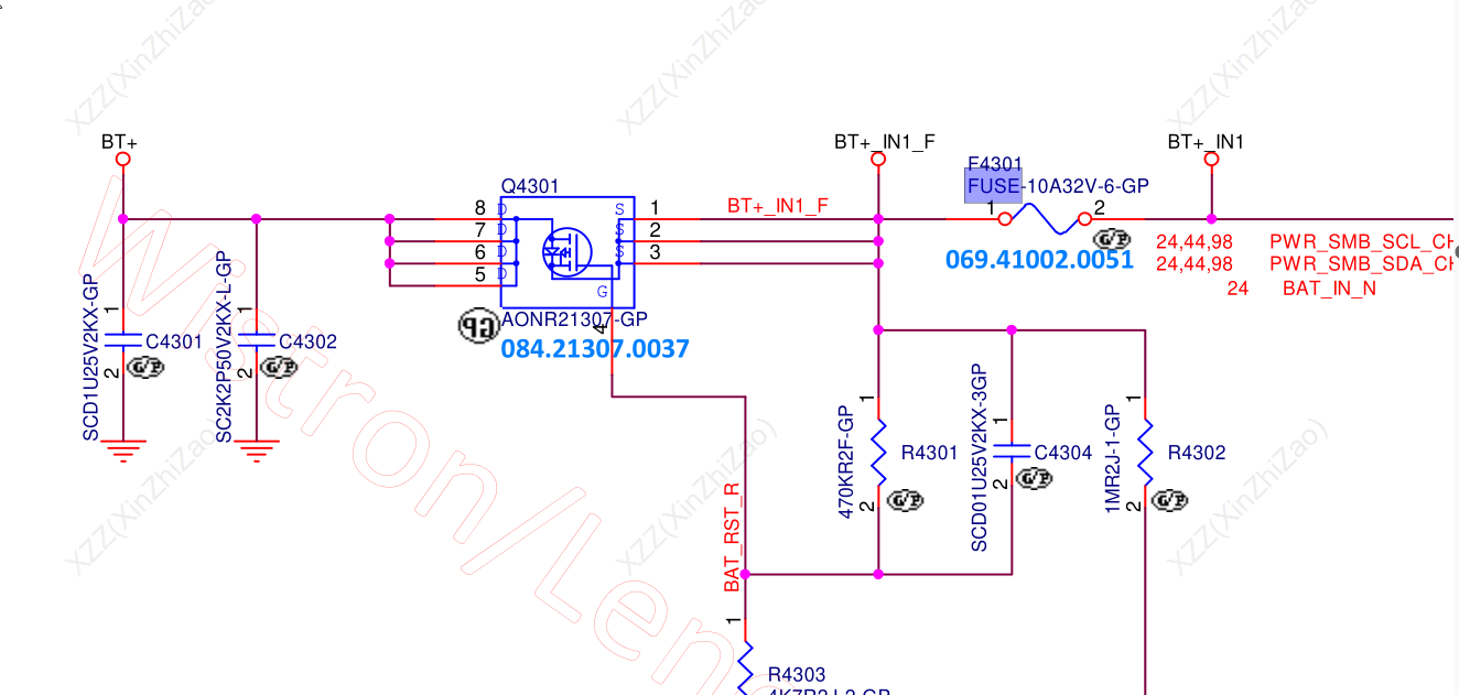

                Given that the current draw is @ 0 A, start by checking the fuse @ F4202.
                Remove all power. Meter in DIODE mode. Short the meter probes and you should hear a tone beep. Then apply the same meter probes across F4202. If the fuse is not blown, you should hear a tone beep. Then check the other fuse @ F4201 and F4301.

                  Ok, so all three fuses are good.
                  What would be the next step sir?
