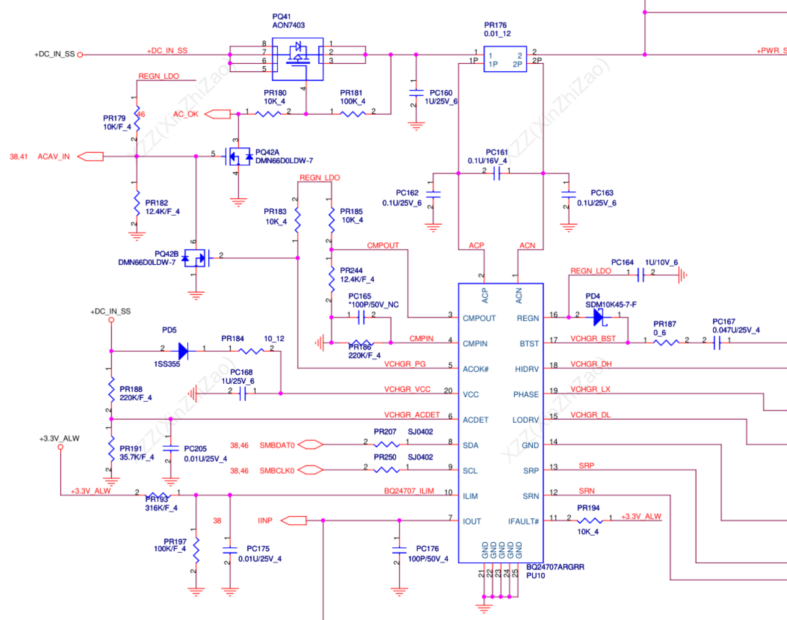

    I have a Dell Latitude 7420 here which doesn't want to boot.
    If i plug in a charger, the status LED blinks white once only, nothing more, no amber blinks.
    I'm trying to start it without battery as the old one inflated and had to come out.
    I've tried all kinds of startmethod, holding D, holding CRTL+ESC, holding M+power, nothing works. I've even checked voltage/current consumption: charger changes to 20V and 0,07A but despite the one white blink, nothing else happens.
    Does someone have an idea what i should look at / check?
    ongobongo
  • mon2
    • Dec 2019
    • 14751
    Check the DCin mosfet linked to the charger IC. Carefully measure the voltage to ground on each pin of mosfet # PQ41. Post each measurement.
    Interested in the source (1-2-3) voltage to ground. Gate (4) voltage to ground. Drain (5-6-7-8) voltage to ground.
