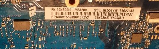

    Greetings everyone,
    I would appreciate your help with the following issue:
    I have an Asus G552V notebook, Mainboard model GL552VW Rev 2.0 (Attached images), which upon powering on, does not display any video (Using the HDMI output with an external monitor as well) There is no disk reading, and it does not respond to the keyboard, except for the power button. Only the Power LED and the CAP LED light up.

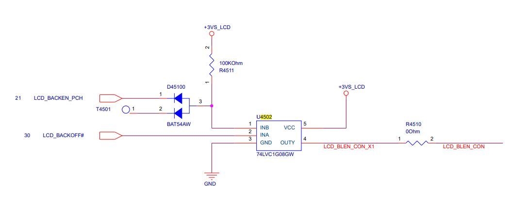

    Greetings to all, I have carried out a couple more tests, thinking that it could be a problem with the LCD backlight. I have obtained the following measurements.
    LCD_PWM_CON = 0V
    LCD_BACKEN_PCH = 0V
    LCD_BACKOFF# = 3.3V
    +3VS_LCD = 3.3V
    Could it be a chipset fault?

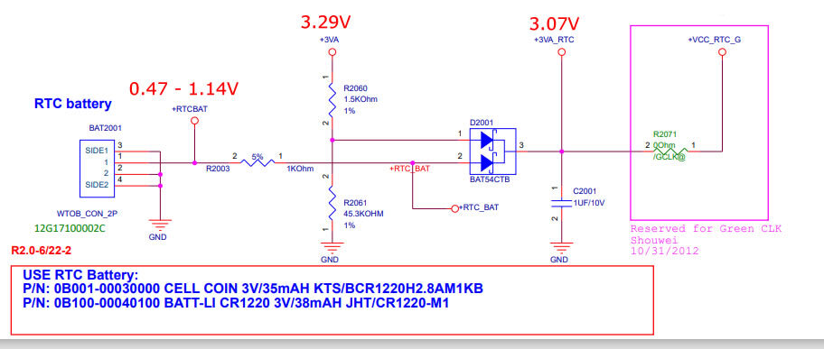

      Review this one:
      +RTCBAT = 0.46V
      • J_PH
        • Dec 2022
        • 37
        • Chile
        Hello mon2, I have removed the CMOS battery since it is faulty; it has a voltage of 0.1V.
        As far as I understand, the equipment can work without any issues without the RTC Battery installed.
        Without the battery installed, the voltage of +RCTBAT starts at 0.46V, after 10 minutes it reaches and remains at 1.14V. (I am unsure why the voltage is increasing).
        The other voltages are stable:
        +3VA = 3.29V
        3VA_RTC = 3.07V.
        Thank you very much for your help; I will continue checking the equipment.
        If there is anything specific to look into, I would appreciate your input.
        Best regards,
        • mon2
          • Dec 2019
          • 13994
          Check D2001. Remove all power. Meter in diode mode. Measure each diode inside D2001 in diode mode. One direction should conduct and other direction should block.
