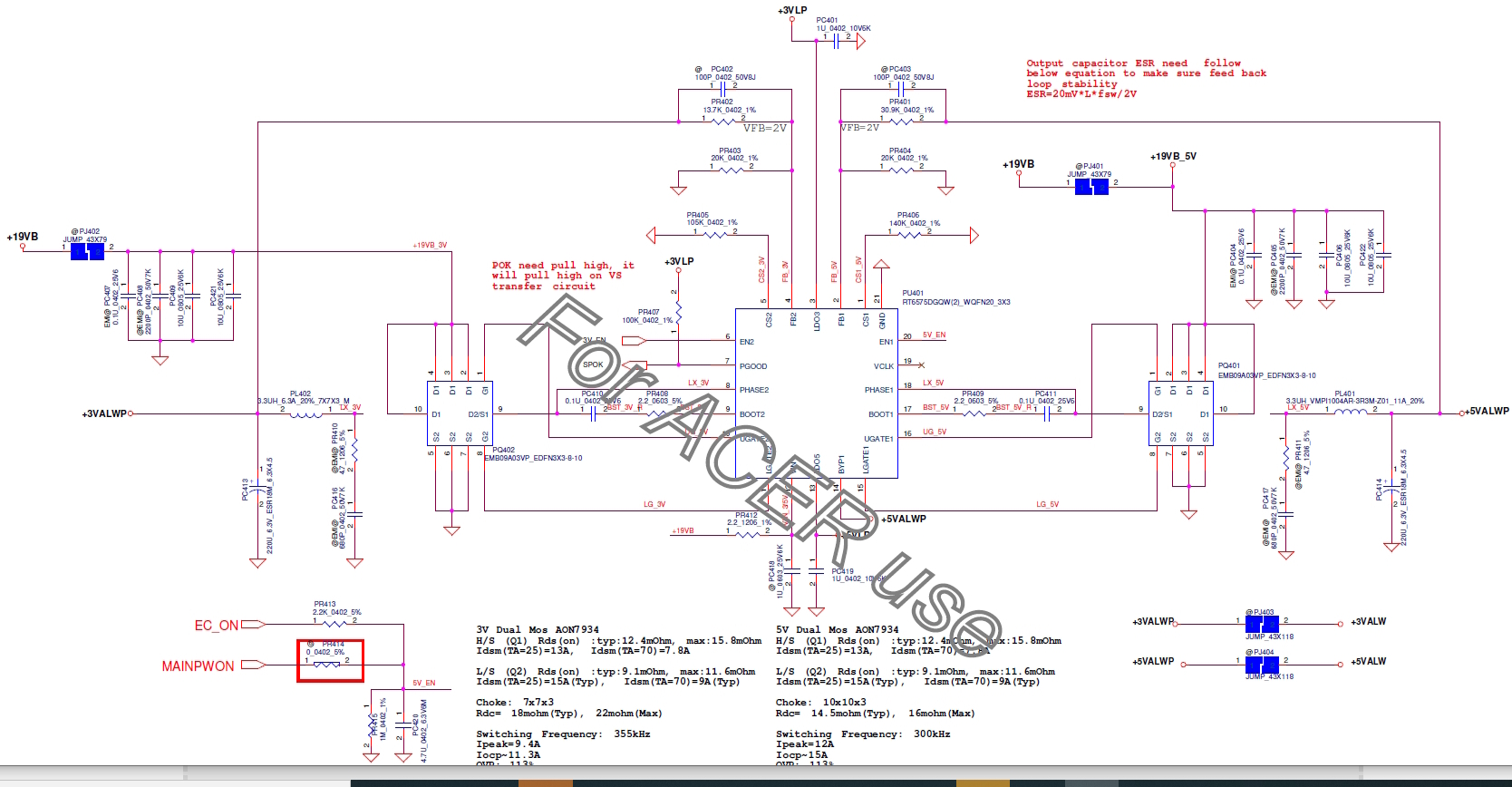

    I have a problem with +5V ALW and +3V ALW. These voltages are generated by RT6575 IC.
    For correct function RT6575 needs 5V_EN and 3V_EN. These values are provide by KB9022Q chip.
    I replaced KB9022Q and flashed, yet not 5V_EN and 3V_EN.
    My question:
    If there is no 5V_EN and 3V_EN , does it mean that I did not flash correct EC( embedded controller firmware) to that KB9022Q?
    Or 5V_EN and 3V_EN does not depend on firmware running in KB9022Q?

    5V_EN/3V_EN does depends on the correct firmware in SIO. But since the firmware flashed succesfully,SIO is very likely ok.
    To me it appears classic Acer thermal protection for which i have provided solution in this forum.
    Tell us the mb markings and link schematic if available.

      First try flashing the EC linked by smdflea. If situation dont change then
      01.Check voltage on both sides of R3926
      02.Voltage on D2012-both pins.
      If its due to thermal protection,there is a way to bypass it. I'll guide you to that effect but first the measurements please.

        I flashed KA8G116A.rom but still no correct 5V_EN/3V_EN voltages.
        I measured:
        5V_EN is 3.28V
        3V_EN is 0V
        R3926: both sides have 0V
        D2012: this diode is missing on the mainboard. Maybe someone else already repaired mainboard or is it a factory modifications?. Is it necessary to be there?
        Voltages on D2012- pin 1 - is about 3.3V; pin 2 is 0V
        Thanks again for help
        • mcplslg123
          • Jun 2015
          • 7262
          • india
          D2012 is marked@ in schematics-so not used by factory. Now follow these 2 steps carefully
          01.Remove R3926
          02.Put a jumper wire between Pin1 & 2 of D2012.
          Hopefully your problem may be solved.

            Hello I allow myself to graft on this thread I had exactly the same problem with a La-E92p R1A motherboard with Sio hs and reprogrammed but more than 3V_EN on PU401 exactly the same scheme. The difference is that I have the DB diode with 3v on pin 1 and 0 pin 2. What is the risk of shorting this diode? Thank you

                It's okay now, I've got the 3v back, thanks for this solution.
                But I don't have the Spok and EN_1valw signals on pu601 sys8288brac. For your information, given the age and condition of the card, I'm not going to reopen a thread for this card; I'll give up for now....
