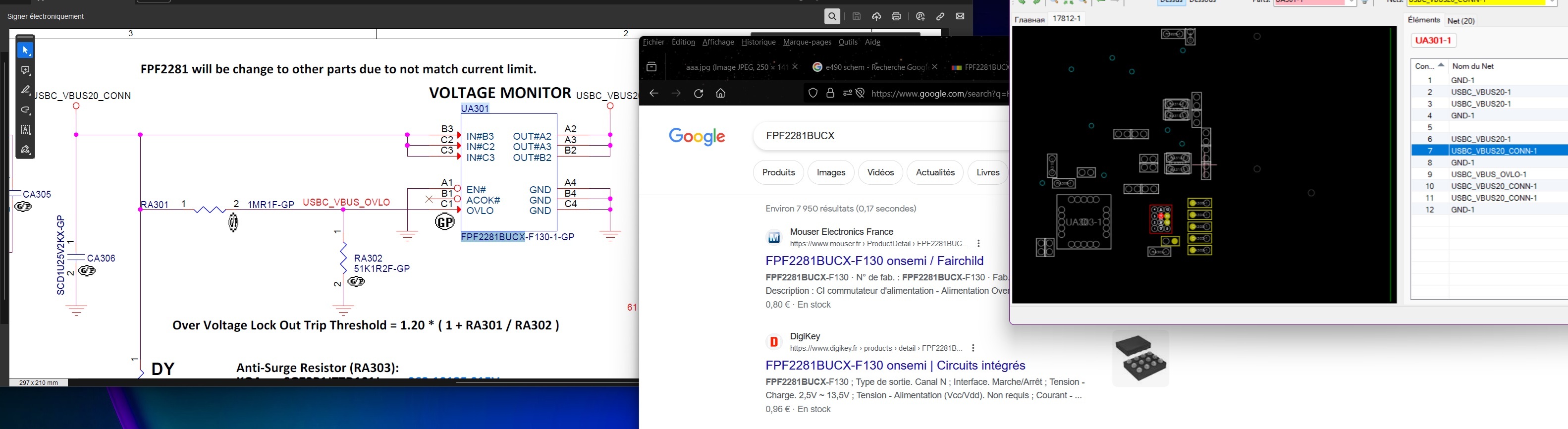

    thinkpad e490 type-c parts
    Hello. This is the BGA chip located near the Type-C power port of the ThinkPad E490. Please let me know if anyone knows what is compatible with this part or where to buy it. Thank you.Click image for larger version

    It looks like this, I put it on x390/p52s
    Click image for larger version  Name:	FPF2281BUCX.jpg Views:	18 Size:	407.5 KB ID:	3222991
    do you know the chip number on the card
    [Mod. Edit] Schematic -> https://www.badcaps.net/forum/troubl...82#post1659482

        Thank you, Maxpower3. I will try to buy it.
