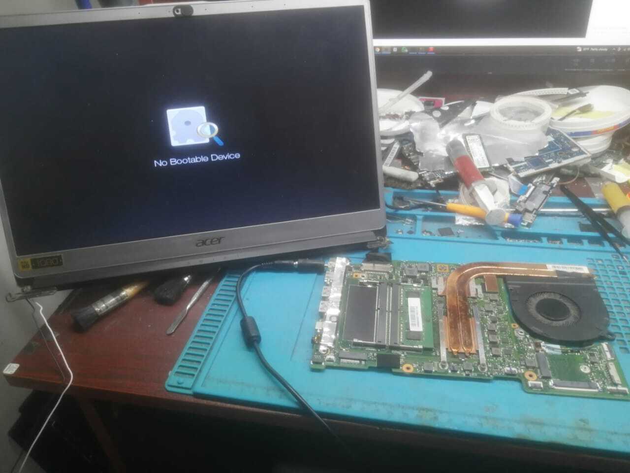

  • DWCS
    • May 2021
    • 49
    • Sri lanka
    Acer Swift SF315-52G PCI ERROR
    HOT FIX ERROR
  • mon2
    • Dec 2019
    • 14630
    Try a bios reflash.
    • DWCS
      • May 2021
      • 49
      • Sri lanka
      I FLASH MAIN BIOS SAME FAULT.
      • mon2
        • Dec 2019
        • 14630
        What is the history of this unit? Was a new PCI or PCI Express device added to this logic board? Remove any removable device like wifi, etc. if possible. Some PCI or PCI Express device is misbehaving.
        Each such device has a vendor ID / Device ID and respective BAR0 to BARx address pointers for memory and/or IO space. The chipset on the device will request the amount of memory or IO space it requires to enable that function. If that function is not working properly, or the logic board is truly out of XX amount of space to enable the device - you will see this error but often, the bios is corrected for a more logic error code like just disable this device and keep booting.
        Be sure your bios is the latest and greatest for this logic board. Remove the CMOS battery and re-install to be sure the parameters are reset.
        • DWCS
          • May 2021
          • 49
          • Sri lanka
          i REMOVE ALL daughter board & WIFI CARD BUT SAME FAULT. ALLREADY TO REMOVE C-MOSE AND CHECK IT. SAME FAULT.
          • mon2
            • Dec 2019
            • 14630
            Try this:
            https://www.supermicro.com/support/f....cfm?faq=15556
            • DWCS
              • May 2021
              • 49
              • Sri lanka
              thankyou for you help I solved my problem. fault is graphy chip. solution is graphy chip uma
