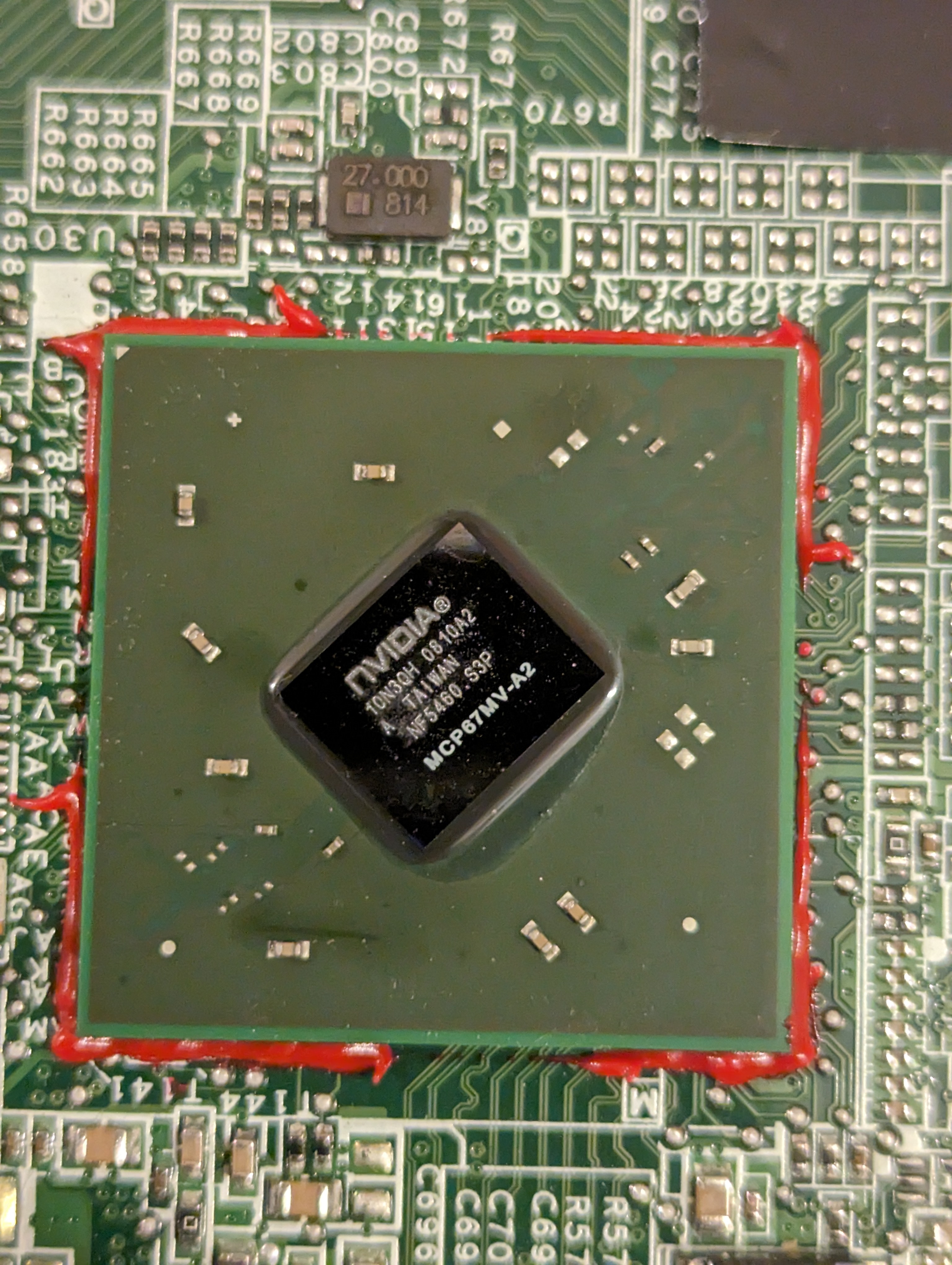

    Hello there!.
    I've recently aqquired a lot of older computers I wish to learn and fault find with.
    Among the machine there are 5 defective machines - 4 of which with motherboard issues.
    This Presario doesn't turn on but the battery indicator and charging port light up, the port doesn't tell me anything as it lights up even without being attached to the motherboard.
    The fact the battery charges proves at least 18v is getting to all the nessesities.
    The laptop has an AMD Athlon 64 X2 and a small Nvidia chip with the model MCP57MV-A2.
    I have checked the Power button with a multimeter and it shows up as good.
    Where else should I look on this motherboard? Any tips would be very helpful. Many thanks
    Luke

    Heat up the MCP76M chip, you can even reflow it. The machine should start working. This chip needs to be replaced for a new one.
      Don't tell me......it's yet another machine with Bumpgate that snuck into my collection.
      Or maybe it's just a chip that's fine just the HP thermal pad isn't doing its job and the chip fries itself, I heard there's a similar issue with the G6000 which is based on the same chassis
      I'll reflow the chip and get back with the results.
      What I'm confused about is how it could prevent the system turning on at all and not just a black screen like many are.

        Colossal waste of time in working on this F700 series. Known to have a defective Nvidea Chip.

                    Update: heating the chip doesn't seem to do anything, either this MCP is too far gone or the issue is elsewhere.
                    Or the power button is broken....which would be hilarious.

                      This laptop not turning on problem perhaps can be solved but whats the point in wasting time and energy when you already know that nvidea chip will turn out to be faulty.So mereley getting it to switching state is perhaps useless. See if any mb is available with intel cpu as @peirnov has suggested.

                            BTW to turn this board on without the switch, short G1 pads on the PCB.
