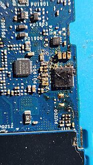

    This machine now has issues powering or taking power (usb-c/lightning) via its USB ports.
    Symptoms: When a dock is attached, it tends to short out devices attached and does not function, when using a USB A port elsewhere on the laptop, they notify windows of a surge and tend to power cycle the attached device.
    If I use a charger on the laptop and plug the dock in, it works for the most part except the laptop gets a bit angry and runs hot near the charging circuit. If I unplug the adapter AFTER plugging in the dock, it will continue to run for quite some time while charging off of the dock as well, very strange. I did use a voltage reader and noticed that the dock pulls down to about 18.7v when pushing about 4a to the laptop on its own.

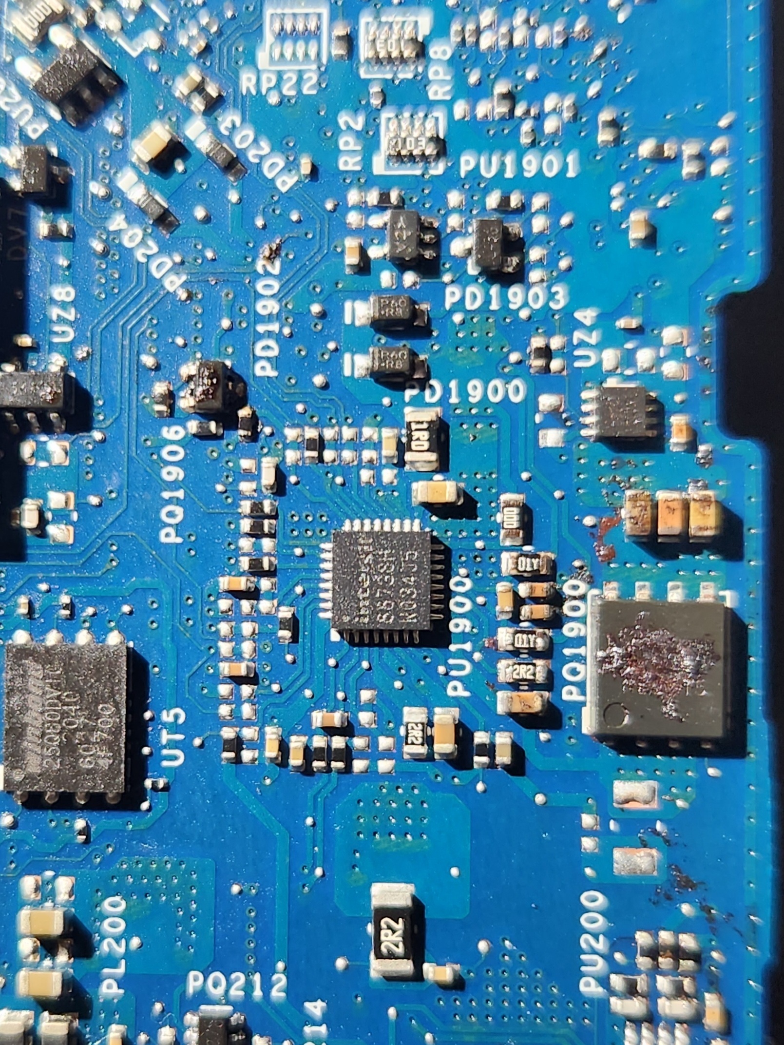

    The unit had liquid damage that was cleaned by myself and some components were reflowed and re-seated:
    Click image for larger version  Name:	fetch?id=3165237&d=1703007487&type=medium.jpg Views:	0 Size:	22.8 KB ID:	3203118
    Click image for larger version  Name:	fetch?id=3165252&d=1703009801.jpg Views:	0 Size:	1.04 MB ID:	3203122

    Considering Thunderbolt VBUS is located in the area of the liquid damage I presume it would be in my interest to start checking resistance values of everything in the area. But if anyone has exp with this issue and knows what particular section to check?
