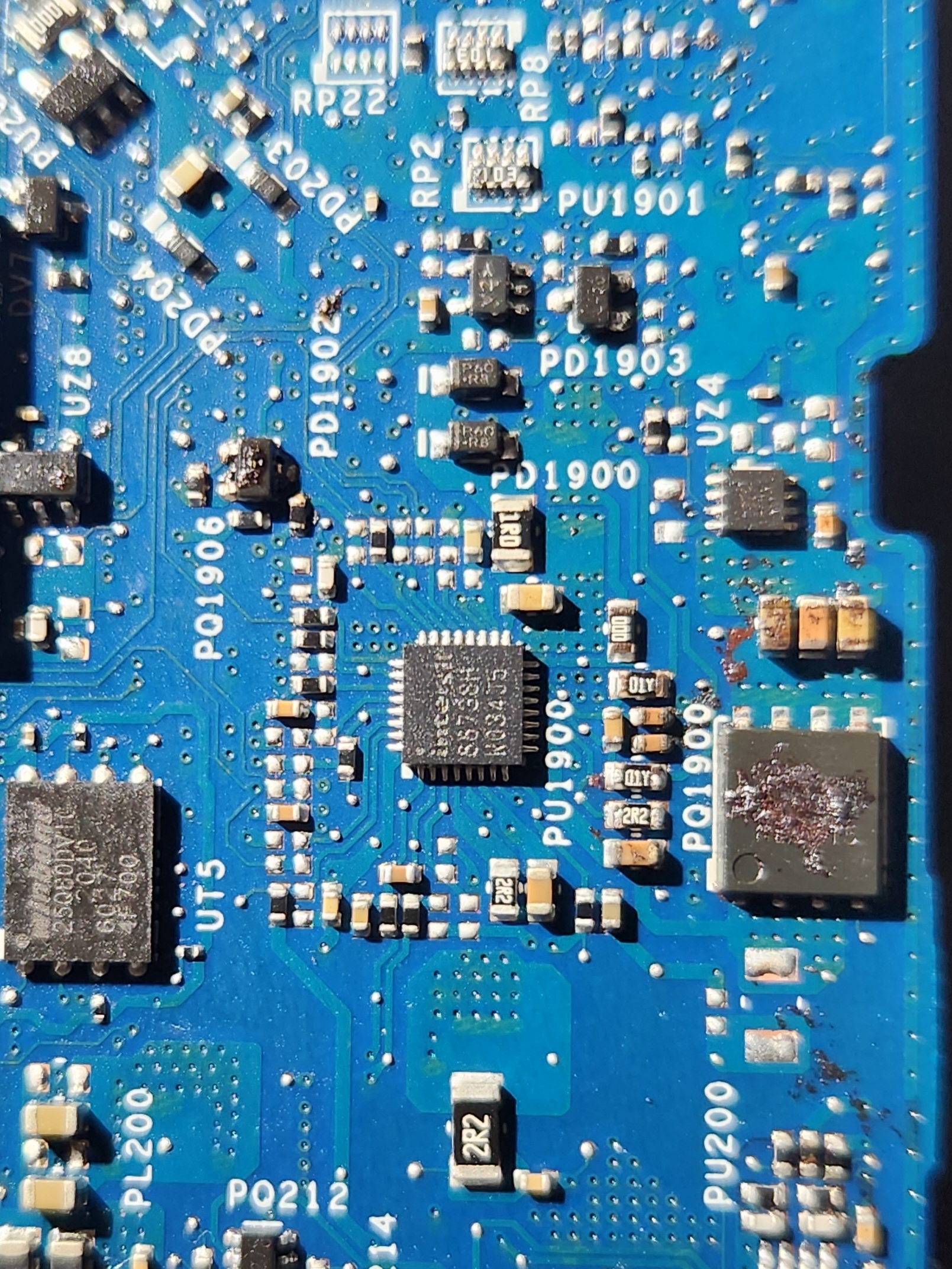

    Hello I have a Dell XPS 15 7590 motherboard that acts precariously after liquid damage near its charging circuit:
    Click image for larger version  Name:	20231217_175934.jpg Views:	11 Size:	1.77 MB ID:	3165237
    EDP51/EDB51 LA-H331P is the board, and I will upload schematics and boardview when I get home to help my dear friends here on the forum!
    Board view found here:
    https://www.badcaps.net/forum/troubl...-1-0-schematic
    After cleaning the area and lifting components and cleaning pads etc (sorry I don't just replace the components, I don't have a donor board at the moment), I find no increase in functionality.
    Currently I find that the computer does not recognize the AC adapter as being attached what-so-ever. Plugging in a 65W USB-C charger allows the machine to charge while the machine is off. I assume that a 180w USB-C might be able to charge it while its on as it recogizes the charger while the laptop runs however it tends to drop connection at random in which I presume the 65w is simply not putting out enough power to keep the machine charging(?).
    I am unfortunately not familiar with dells PS_ID technology, but what I can say is after plugging in the charger I read nothing on the PS_ID circuit when the laptop is in standby.
    I'm at work right now so I figured I would get this post rolling and after some suggestions and questions I'll update when I get home and can probe more.

    Grab some IPA (alcohol) from Costco pharmacy on the way home and use with a cotton swap / Q-tips to clean up this region. Then post fresh pics. It should help.

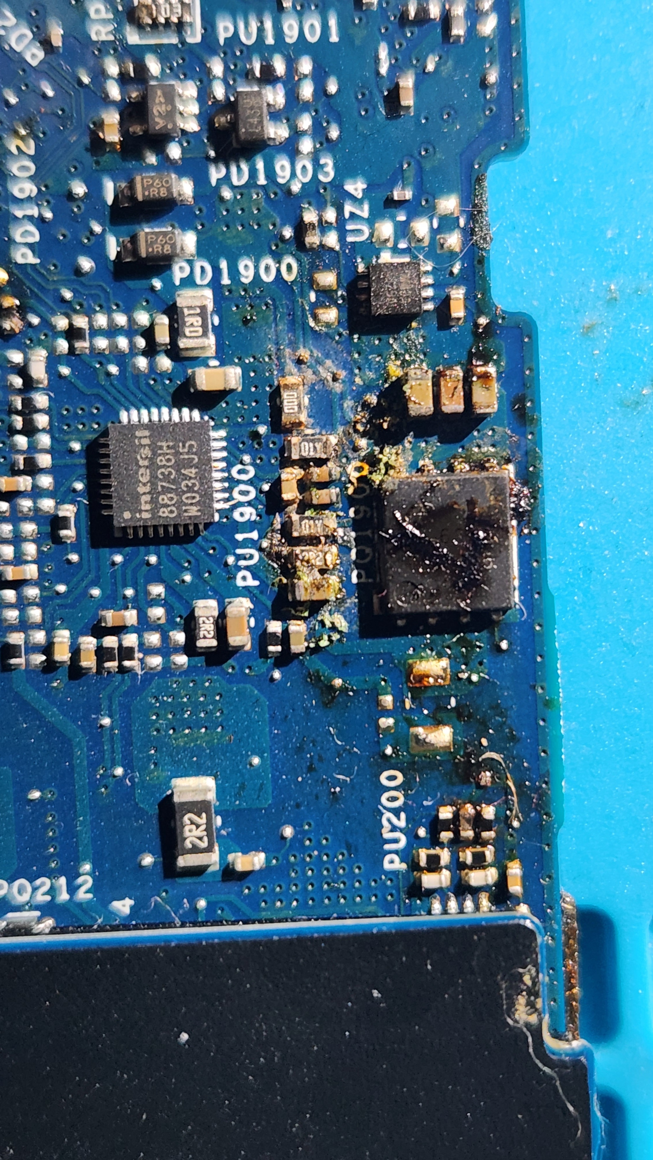

      I took it a step further than that, reflowed, pulled the mosfet and the package above it and cleaned underneath them. Bare in mind this was a coke spill (of course it is..) so there will be that tacky residue that just will not come off with even the stiffest of bristle brushes. I did not pull and reflow the ISL, as it looked relatively pristine.
      Here is the cleaned area, side note the transistor to the top left of the isl was cleaned after the photo was taken:
      Click image for larger version  Name:	20231218_193646 (1).jpg Views:	0 Size:	1.04 MB ID:	3165252
      I do not read any obvious shorts with any of the SMD capacitors, the big 3 above the mosfet while they look bad, are not short.
