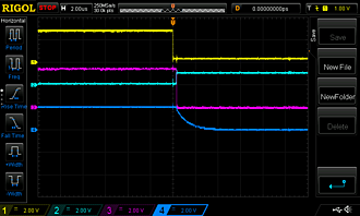

    Ill give you some background first,
    My work laptop had some liquid damage, I tried to repair it but it was proving to be a very long task. So I bought another motherboard (Faulty from Ebay and decided to attempt to get that one working)
    I've made some progress on it, fixed two problems.
    No AC charging (Fixed by replacing a resistor around the current sensing)
    Missing voltage on NCP81215 VRMP
    The power up sequence stops at getting +VCC_CORE, +VCCGT and DDR_DRAMRST#.
    I have a scope to look at the PWM outputs to the outputs:
    PWM1_4PH
    PWM2_4PH
    PWM3_4PH
    They rise to mid rail, around 2.0v.
    I do get the output on +VCCSA around 1.30v so the NCP81215 must be functioning.
    I checked the SVID lines, ALERT# goes low for 40ms, SDIO stay's high, SCLK also stay's high. I will post some scope images shortly.
    Any idea what could be the problem, or where to check next?
    Many Thanks

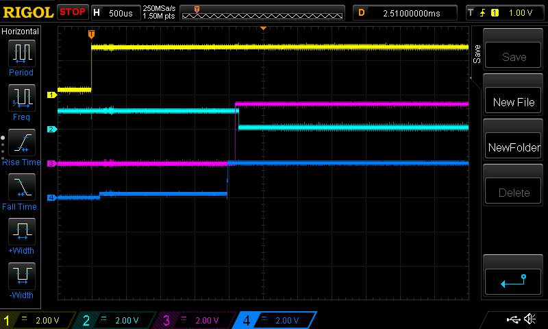

    Start up signal NCP81215
    Channel 1 : Enable Pin 43
    Channel 2 : ALERT# Pin 41
    Channel 3 : VR_RDY Pin 45
    Channel 4 : PWM3_4PH/VBOOT Pin 20
    Click image for larger version  Name:	NewFile7.png Views:	0 Size:	15.8 KB ID:	3183061

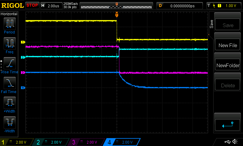

    Shutting down signal traces (Can see EN has gone to logic 0 first.
    I checked the timing on UZ21, a MC74VHC1G08.
    Input B = IMVP_VR_ON
    Input A = SIO_SLP_S3#
    Output Y = VR_ON
    SIO_SLP_#3 de-asserts, that is why the VR_EN is going logic low. Question is, why is SIO_SLP_#S3 going low? Is this because the +VCC_CORE is not present in time?
