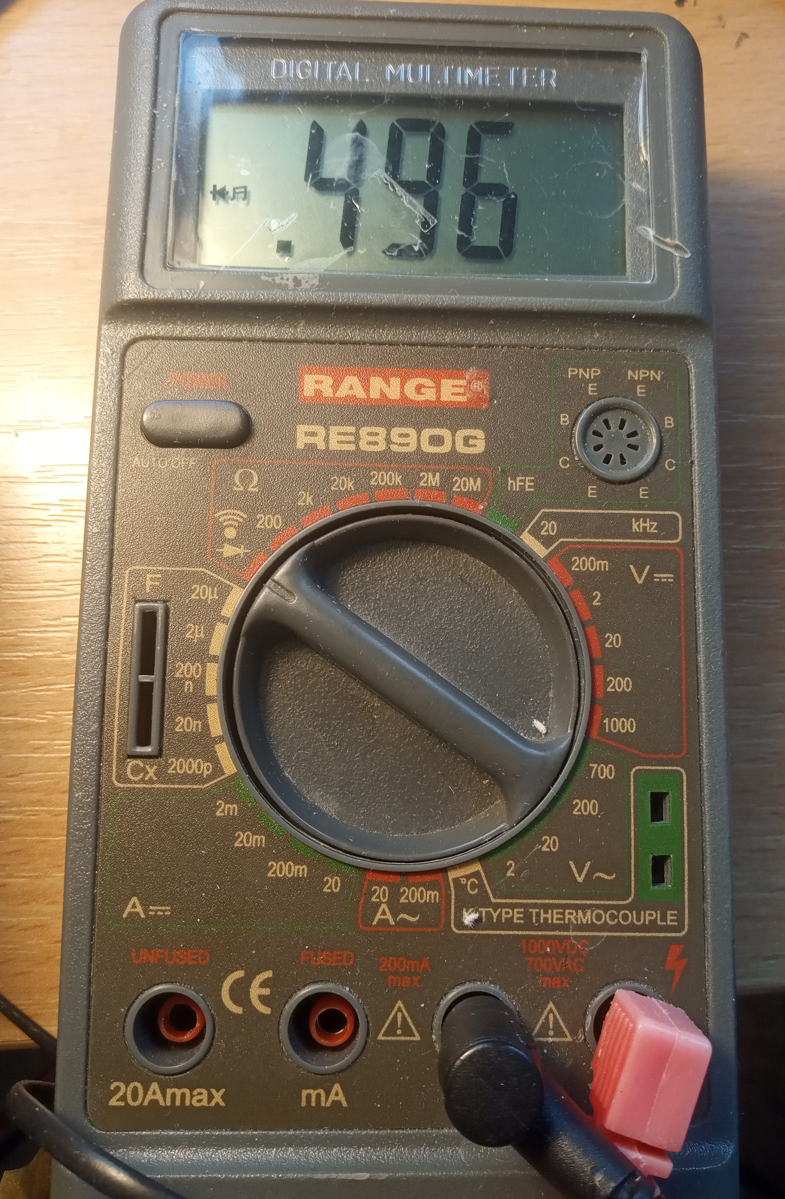

          Post a clear pic of the meter face for one of these checks so we can confirm the scale used for the measurements.

            Here it is

              So your measurements are for the diode mode. The units of the measurement are in volts and is the voltage drop across the internal diode of the part. If the voltage drop is too low then the part is considered to be shorted.
              so the reading is 0.496 volts for this check. A typical good diode will be 0.6 volts. Both of these checks are ok.
