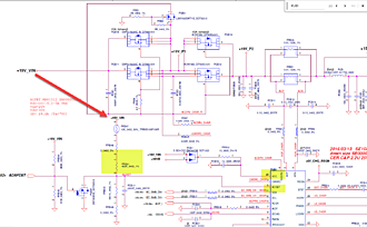

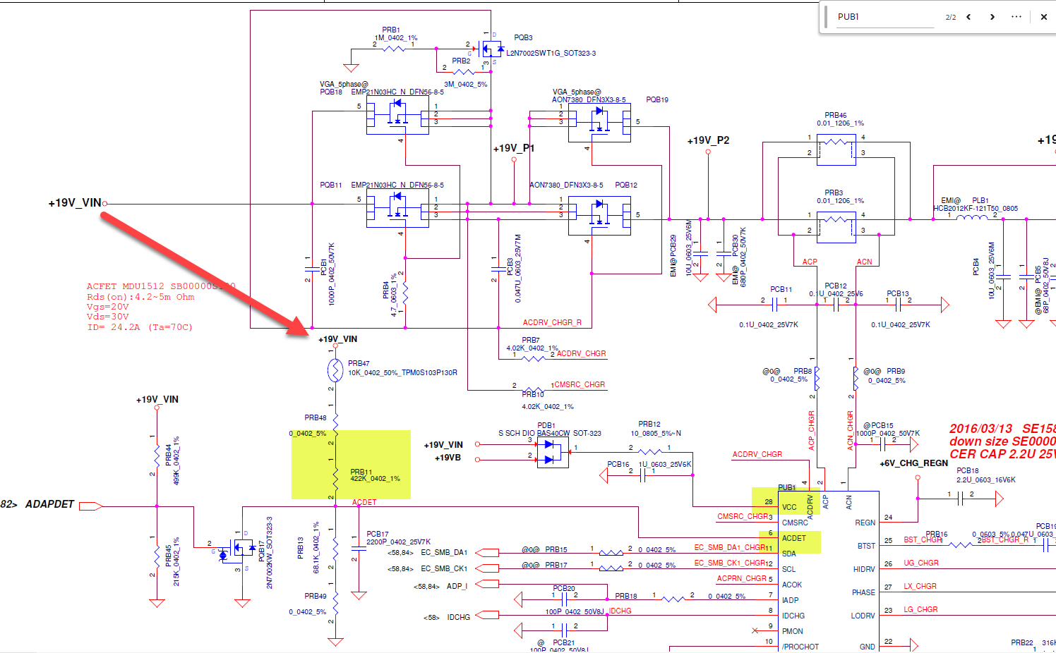

    1) Confirm that pin # 28 (VCC) on the charger IC (PUB1) is receiving the adapter voltage. Otherwise the charger IC is not being powered.
    2) You must also have a voltage present on ACDET pin # 6 on the charger IC since this voltage is based on a resistor based voltage divider where the power adapter is the power feed. Confirm it. Otherwise you have defective resistors or a broken PCB trace / bad soldering from +19V_VIN to ACDET. Suggest to remove all power -> meter in resistance mode. Check the resistance from direct pin #6 on the charger IC (ACDET) to +19V_VIN that is the raw voltage from the power adapter. This measurement should be ~422K ohms.
    3) Update - confirm the voltage to ground of ADAPDET which is from the power adapter. This voltage should be 0 volts - that is, when the power adapter is mated to this logic board, this ADAPDET line should pull the GATE voltage of PQB17 (2N7002) to be low or 0 volts. This in turn will turn OFF PQB17 so that the ACDET pin on the charger IC can receive a valid threshold voltage from the power adapter. If the ADAPDET line is NOT pulling the gate pin to ground then PQB17 will be ON (due to the voltage divider resistors on the same gate pin) and then ACDET will be pulled to 0 volts. PQB17 is acting like a switch to ground for ACDET. Confirm this area.
    Click image for larger version  Name:	power_path.png Views:	0 Size:	208.6 KB ID:	3183044

      my voltage divider with PB11 and PRB13 on ACDET is not good I do not have 0V6, I HAVE 0V, however my resistance is good and I do have 19V arriving on PRB11 (prb11 400K and prb13 68k are good)

        Appears to be a broken trace between the charger IC's ACDET pin and the 19v rail. Confirm it by removing all power. Meter in DIODE mode. Short your meter probes and the meter should tone beep. Then connect one meter probe onto the ACDET pin directly on the charger IC. For this simple test, the choice of the meter probe color does not matter. The other meter probe to the PRB11 resistor. Check both sides of PRB11. One side must tone beep. Confirm this important detail.

          yes I have continuity

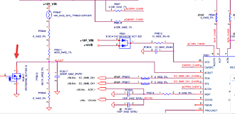

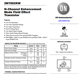

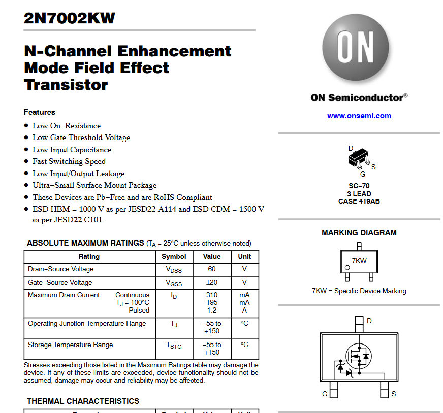

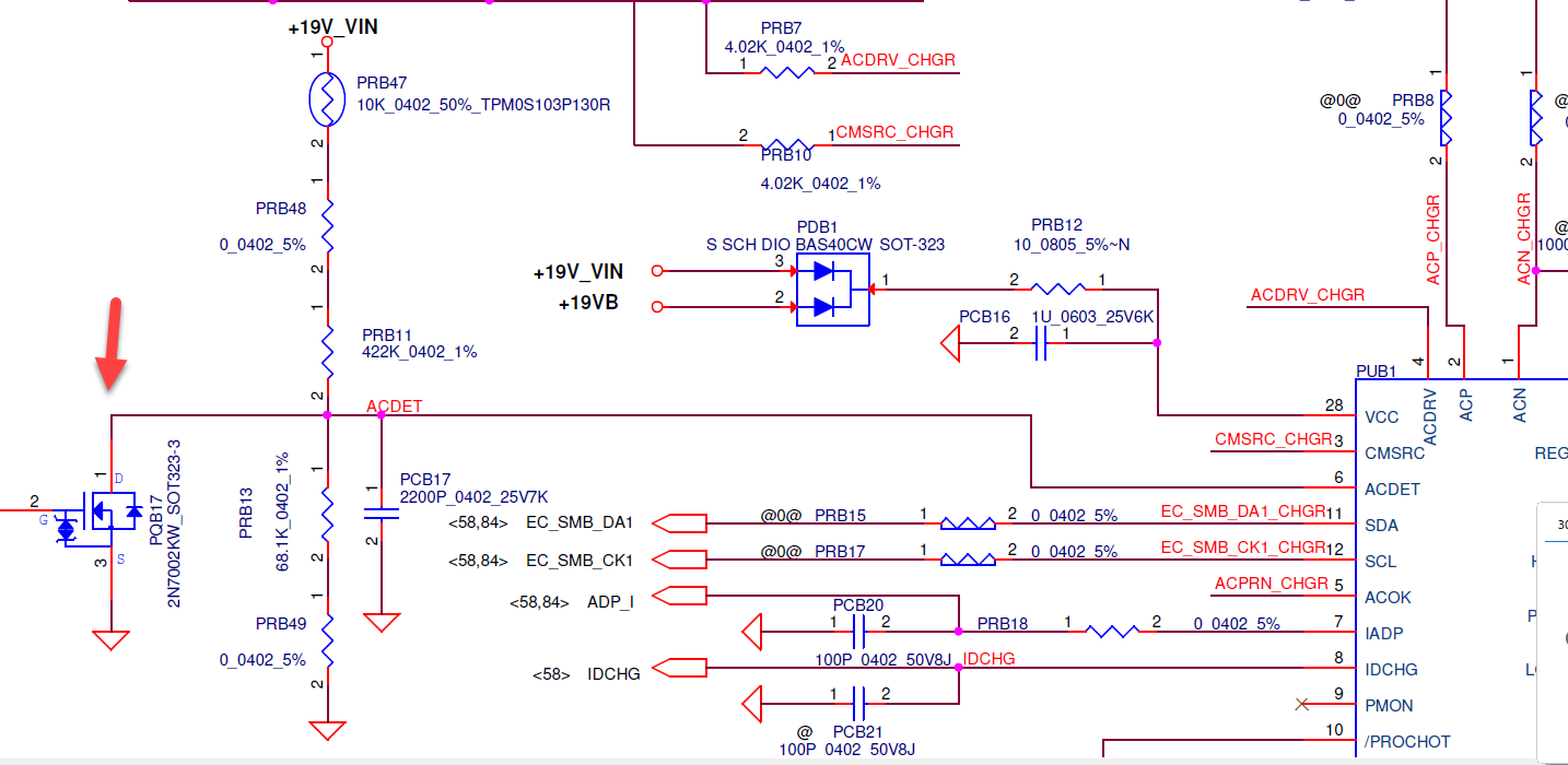

            Good. Then you must have voltage as well unless PQB17 is shunting this voltage to ground. Locate PQB17 which should be nearby. We are interested in the voltage to ground of each pin on this part. Specifically interested in the GATE voltage. This will be small 3 legged black color part. In summary, if the GATE voltage is high enough, then PQB17 is ON and if it is ON, this ACDET voltage will be 0 volts.
            Click image for larger version  Name:	PQB17.png Views:	0 Size:	145.9 KB ID:	3183159

              1) Yes 19V5 on PRB12 but PDB1 pin 2 : 0V, PIN 1 3 : 19V5
              2) BQ pin 6 (ACDET) : 6,37kohms, I unsoldered PRB11 and PRB13 to measure them, they are good.
              3) PQB17 pin 1 : 0V, pin 2 :5V25​

                I understand better why I have zero on ACDET then, because the PQB17 gate has too high a voltage, what is this due to? I tried several chargers, it's the same.

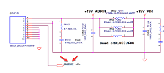

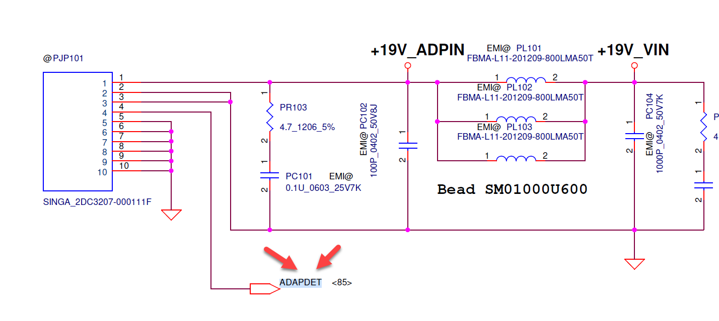

                  Good. This means that the GROUND or adapter inserted pin is not working on the DCin power connector = pin # 4. Review this connector. For now, carefully take a piece of wire and connect one side to ground and the other side to the GATE pin of PQB17 while the power adapter is connected. This procedure will cause PQB17 to turn OFF and the ACDET pin should then be as expected and should be ~2v or higher. Post the results. Need to run out to drop off something in the crazy -17 degree outside temp. BBL.
                  Click image for larger version  Name:	adapter_detect_signal.png Views:	0 Size:	93.0 KB ID:	3183171

                    Ok thanks, I put the gate of PQB17 pin 2 to the gnd. My voltage divider works: 0V4 on ACDET but I still don't have my mosfets closed, I will put the BQ24701 chip back because I had put BQ24708S. I think I'll have to order a new charging connector it looks bad​

                                Pretty sure I've highlighted this before on the forum with Acer laptops that the most common fault (apart from the crap power button in their keyboards) is the DC jack. The microswitch (which produces that clicking noise when you insert the jack) fails. In the design above, PQB17 is biased on and thus shorts ACDET to ground. When the switch in the jack is closed, the PQB17 is biased off, and allows the ACDET voltage divider to register at the BQ chip.
                                This is why they sell DC jacks for Acer by the bucket load on Aliexpress. i believe this design is to prevent the laptop from charging the battery until the adaptor is fully inserted. It should still power on though, just not charge the battery.
