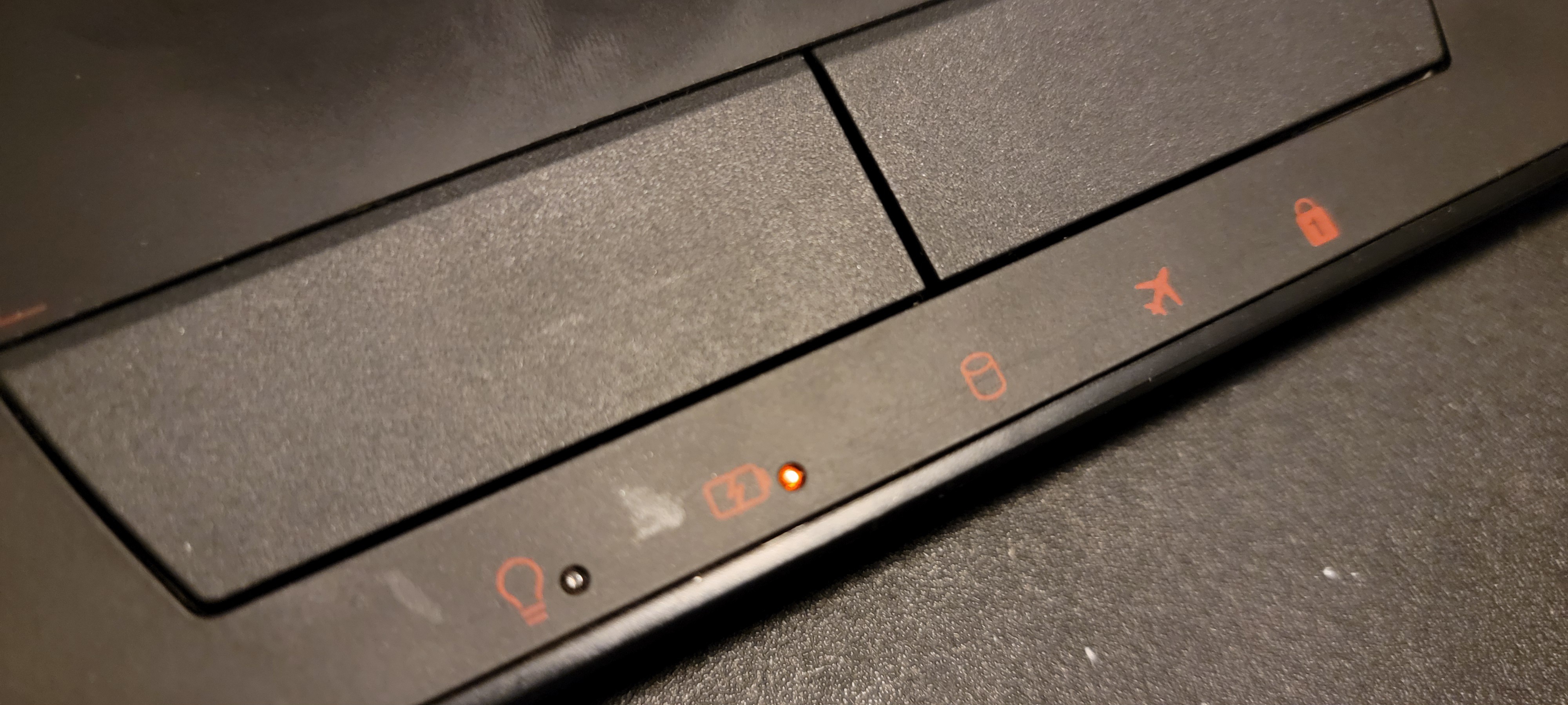

                    Does the battery light indicate that the battery is being charged? Or does so and then halts charging after a small period of time? If yes, test with the other battery as well.

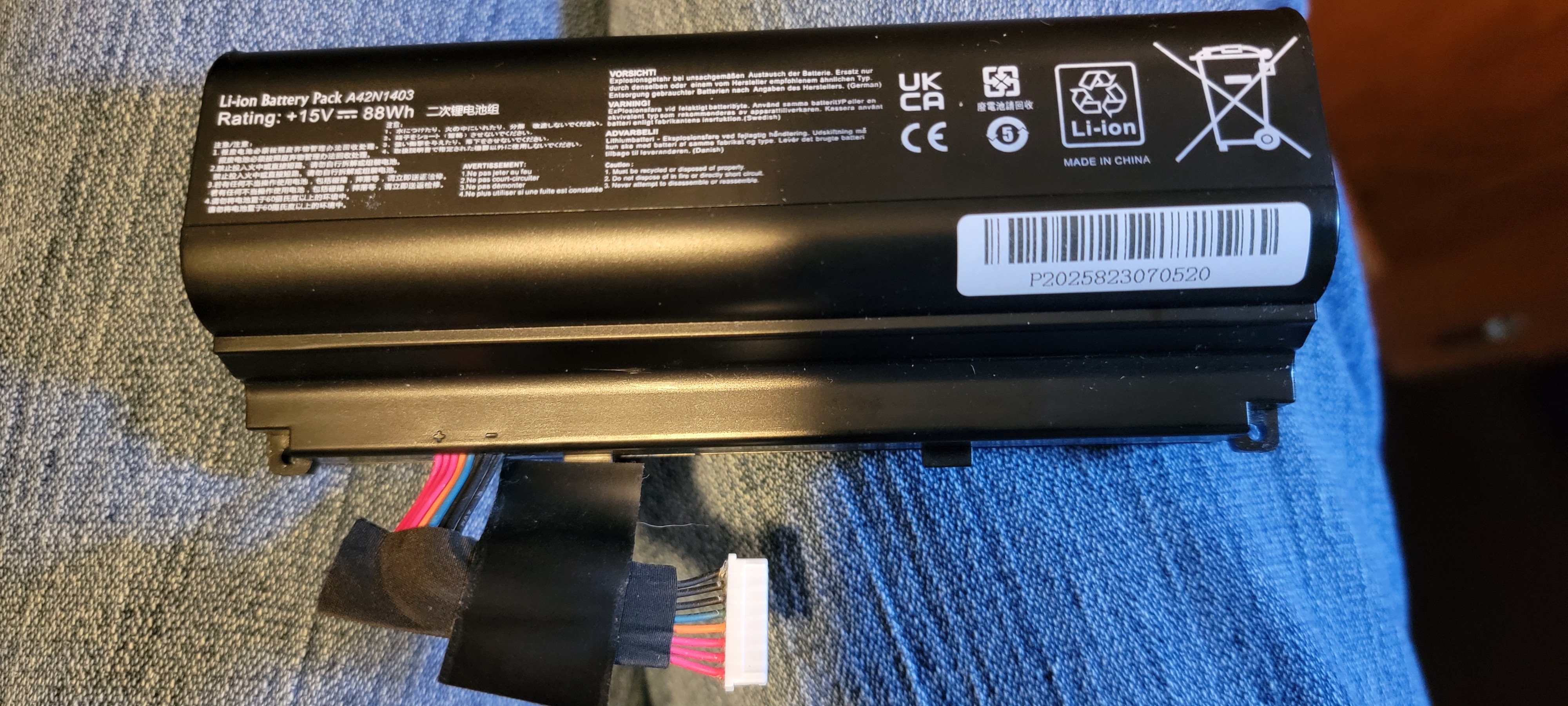

                      i have not reassembled yet. But connected old battery to board and was only drawing a little over 1v. Connected the New battery and was drawing our 13.90v again.
                      Connected old battery and AC adapter. That receives 0.814v from +V pins of connector.

                          Thanks for joining the party. This battery was purchased from ifixit. When i first recieved it last week the battery ran the laptop a couple days on its own in testing phases. I believe the New battery is good. Just feel there is something messed up with the charging circuit somehow.

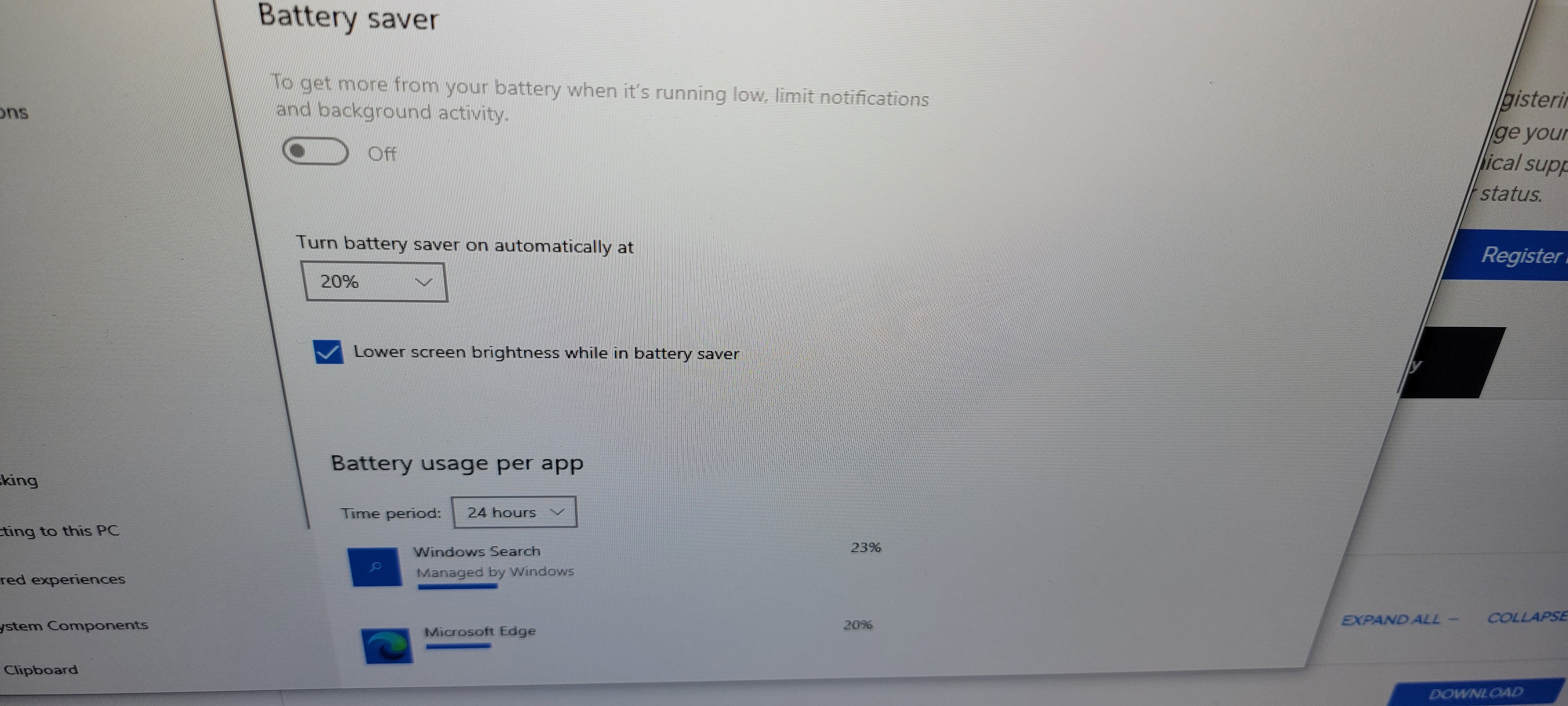

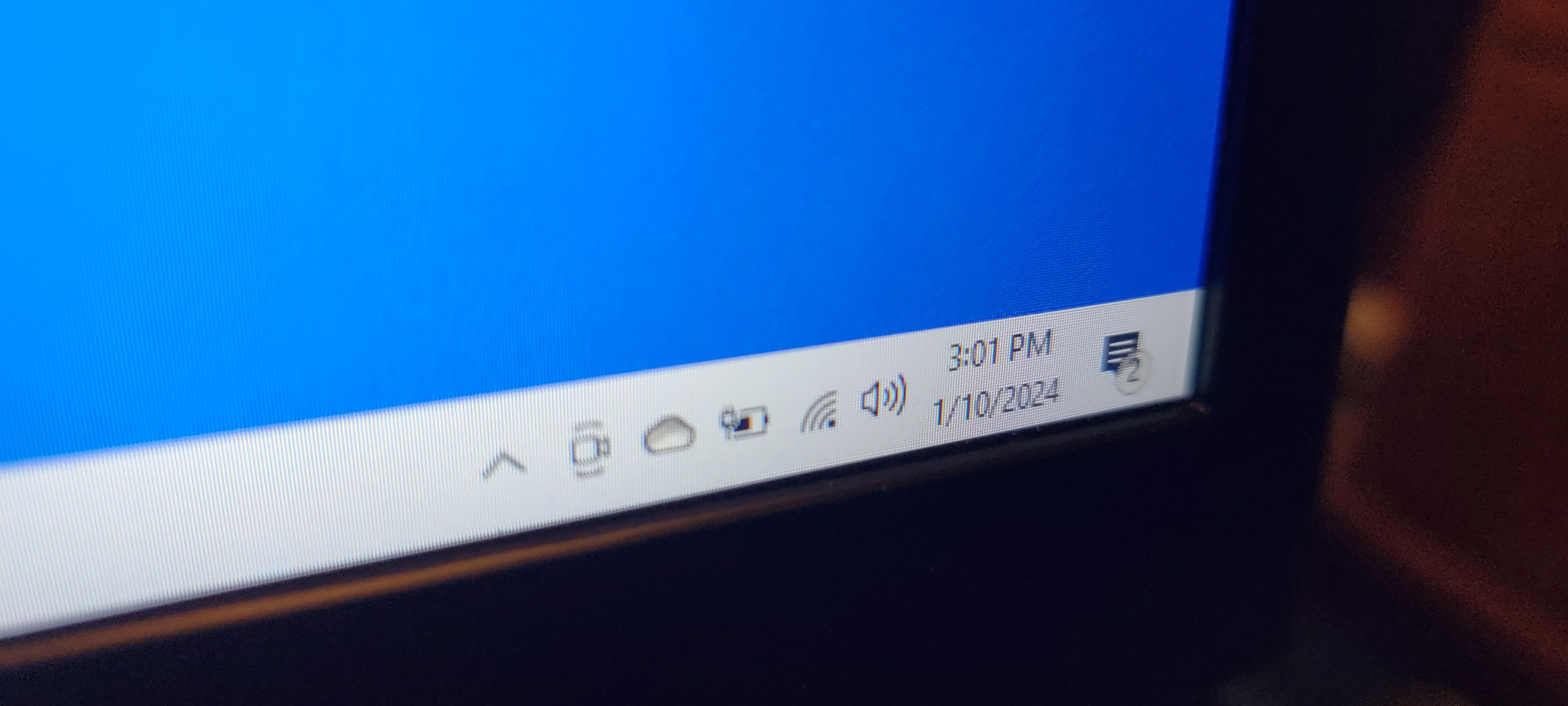

                                        Assembled without mosfet. Laptop has the same symptoms as before. Battery will boot up and run laptop when AC Adapter is not connected. Laptop recognizes when AC is connected. Windows starts to indicate charge then drops after like 10-20 secs.
