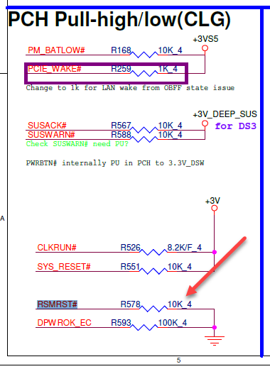

        RSMRST#= 0 v
        means this line is stuck in reset mode since this is an active low signal. It should be ~3v3 under normal conditions.
          Without RSMRST# present,mb wont switch at all. Time to check basic requirements of SIO,flash bios. What is the resistance to GND on RSMRST# pin?

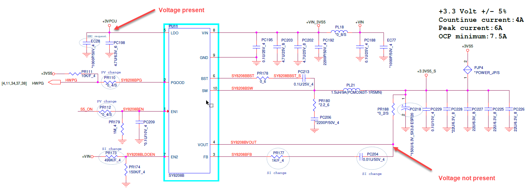

            Hi, the RSMRST# resistor is 10k, I checked the voltages on the SUPER I/O and I realized that the 3v on pin 11 is missing.
            I checked the voltages on IC PU11 and on the PC204 capacitor I have no voltage.....Short circuit on the 3.3v line or problems on ic PU11?
            Thank you and good day.
              You cant expect voltage on PC204 in off condition. The votage there will appear only after switching and when EN1 pin has S5_ON from SIO. So in off condition,its ok to have only 3V LDO and nothing on coil.
              I didnt asked for RSMRST# resistor. Thats a 10K pullup resistor. Measure resistance to GND on RSMRST# pin of SIO(black probe to GND,red probe on RSMRST# pin). Should be 10K or higher resistance.
                Sorry I didn't understand, I measured the resistance is 10k on the pin RSMRST# of SIO
                  Can we try to do some tests for study purposes too or will I take it straight to the bin?
                    The resistance to ground on RSMRST# of 10k is correct due to the pull down (not pull up) R578 on this line. The question remains as to why this line is not proceeding to be a logic high to allow the board to boot. If this line remains at a logic low = 0 volts, the board is stuck in reset mode.
                      What are the elements that could bring the line to 1? Any advice on what I could check or do?
                      Thank you
                        Trace the same label in the schematics. Whomever is driving this signal is responsible to make the line go high = logic ‘1'.
